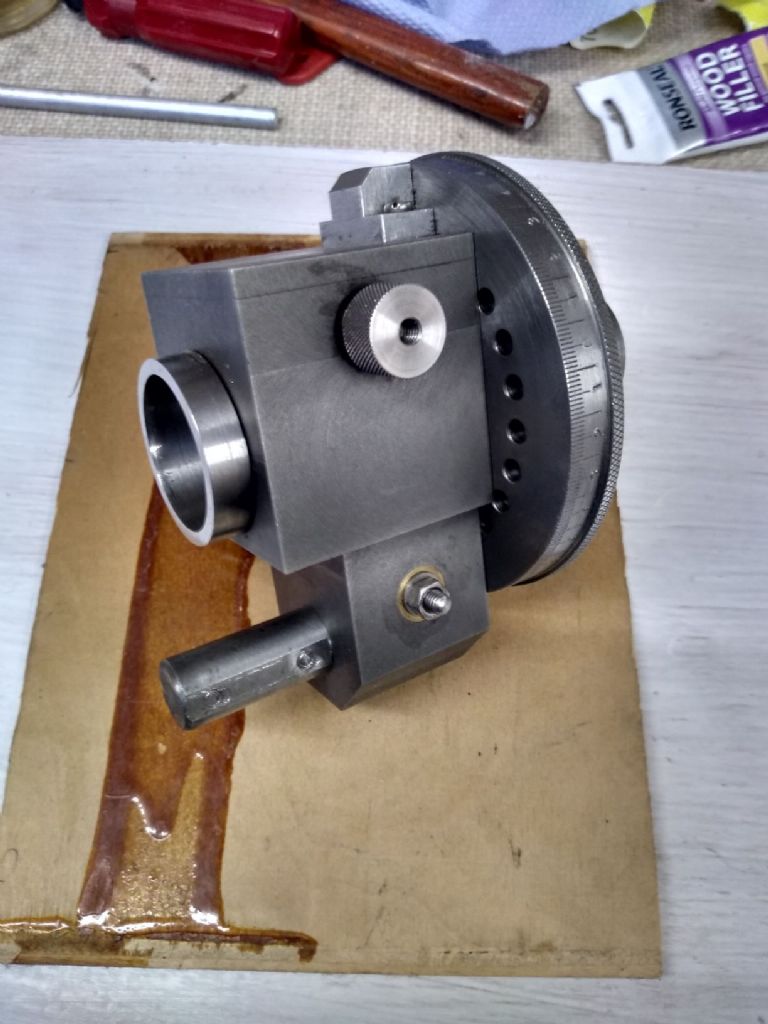

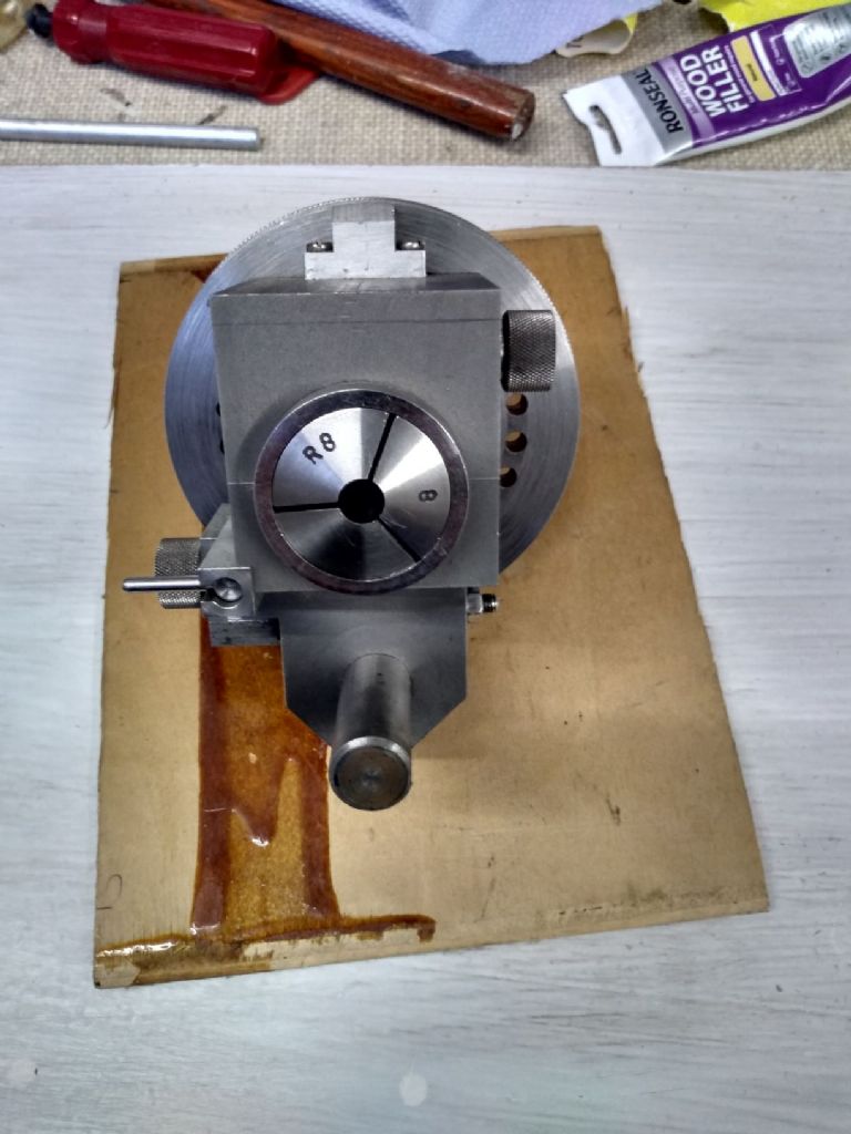

                  I inherited my Quorn from my dd who used 3C collets, with only a limited set. When I got my VMB that uses R8 collets I looked at the possibility of making a mandrel to take these (since by definition I had a set of collets to take all the milling cutters I used) but decided there just wasn't enough meat in the casting to allow it to be bored out. So I bit the bullet and made a new workhead out of a chunk of concast iron from CES.
                  You could take the same approach if you want a project? Also worth looking over on the Quorn-Owners group where there quite a few posts about alternative collets. Worth joining (it's free).
