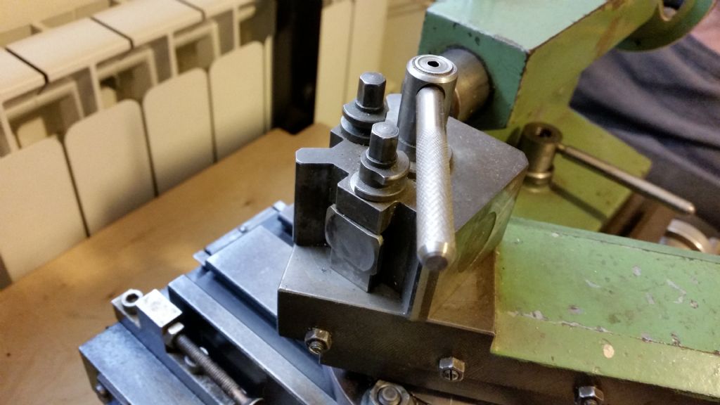

      Hi
      I'm looking for more tool holders and I think the ones from RDG (what they call "Myford size" are correct for my tool post… does anyone know? I emailed them too but if someone here knows that would help.
      These are the RDG holders: http://www.rdgtools.co.uk/acatalog/Quickchange_Toolpost__Separate_Tool_Holders_.html

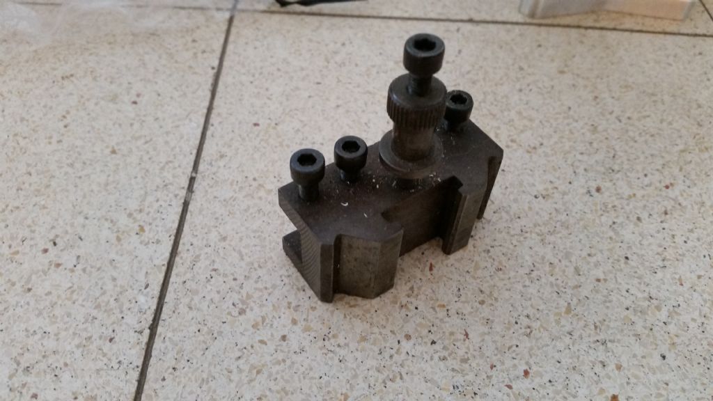

      These are the ones I have:
      Edited By Nitai Levi on 02/01/2017 10:35:08

          For Dickson toolpost sizing see the table here… **LINK**
          The usual Myford size is S.00 but, without wanting to teach Grandma, not all toolholders are equal.
          I'd wait for Lynam Engineering to have some (ebay seller lynamengineeringltd) which are not only cheaper but IMHO are superior to the official Myford ones (**LINK**) which are superior to cheaper Indian (Soba) or Chinese knock-offs.
          I'm not sure whether all of the RDG ones are the same as the Myford ones.

                                            I checked again and behind a layer of dirt and some rust was a S00/M hidden on the tool post
                                            It looks like maybe there was a company name somewhere on the post too, but that is too worn out to read anything… so much that I'm not sure it's even there.
                                            The holders don't say anything but obviously they should fit the S00/M size… unless not all S00/M (or T00/M) would necessarily fit the same post…
                                            Re the measurements on the Rotagrip website, yes I looked at that link and the post and holders I have are not exactly the same as any of the ones mentioned there (or the other page showing S models). Some of the more important measurements are not shown (things like overall length or depth aren't that critical anyway, but I guess they are used to match holders which then should fit… in theory).
                                            I checked the holders on the Rotagrip website. They have both S00 and T00, both with the exact same (outer, somewhat less important) measurements. Both are much more expensive than any of the others. No other measurements are mentioned. The T00 is made by Bison. The S00 has no details. The S model is for some reason more expensive than the T. They seem to have the same photo. More detailed specifications lead to that same page David Standing already linked to.
                                            The thickness of the bottom of where the tool is on my holders is approximately 5.9mm for the regular ones and 7.5mm for the V one (excluding the V).
                                            I'll check with Rotagrip and see, maybe try them too.
