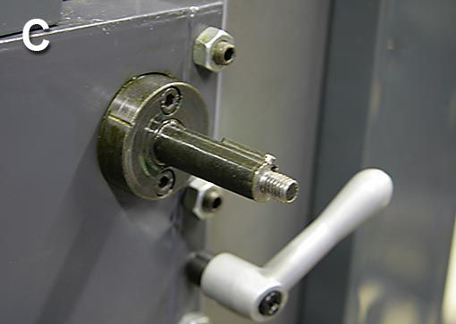

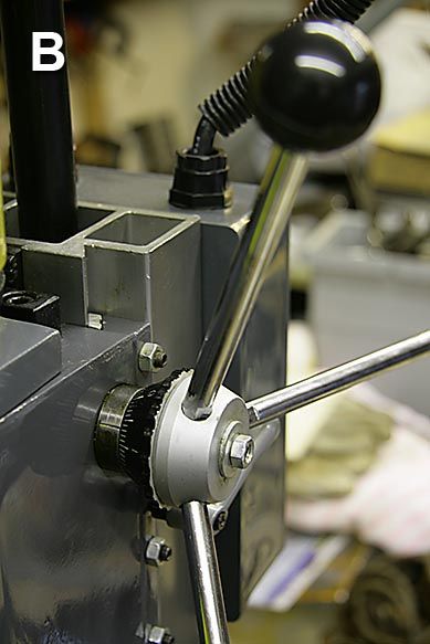

      A) This unit does not have the optional fine feed wheel (photos B, C). This can make fine work on the Z-axis pretty iffy. I am wondering if anyone knows if a fine-feed unit can be obtained for this mill after the fact, or else, failing that, if there are any plans or write-ups online detailing the construction of one's own fine-feed system.

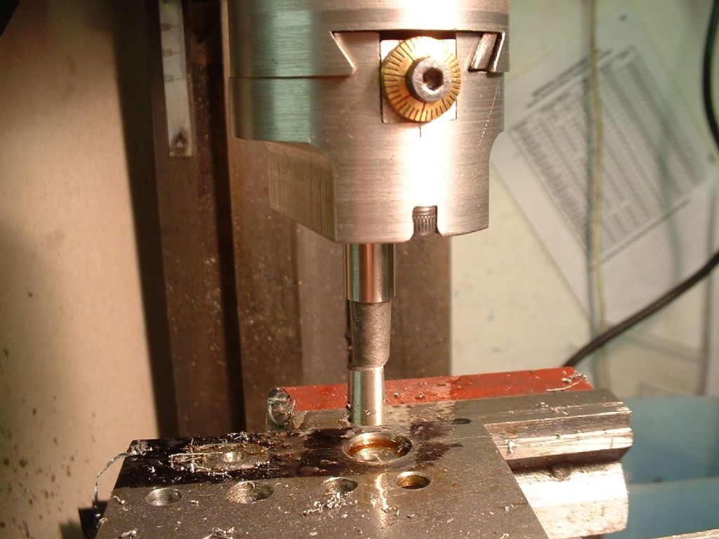

      B) Does the CH-10M have the necessary rigidity and fineness of feed to do any boring work? If not then I would rather not waste any money on tooling for such.
      C) Both of the depth readouts on the unit are pretty primitive (side scale with a pointer and that calibrated twist dial around the downfeed spindel (photo B). Any suggestions as to the best way to mount something like a dial gauge or such?

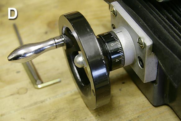

      D) This unit has X-Y readouts that appear to be one single piece with the handwheel (photo D). This means you cannot roate them to zero them out, but instead have to do a lot of fussy number-math when doing any precision work. Can it be done and is it worth my time to try to refit the X-Y leadscrews with newer handwheels with the spring-loaded zero-able scales?

          Looks like an X2 variant…..
          Have a look here for parts…..http://www.arceurotrade.co.uk/machineparts/X2-Parts-Diagram-and-List-2012.pdf
          You will need quite a few bits to make up the fine feed mechanism for the Z axis as per the diagrams, assuming the two machines are compatible.
          You could use a digital readout scale for the Z axis instead of the rotary dial…..

          Are you sure the X/Y axis dials are part of the hand wheel and not just stiff to rotate?

            John, thanks for the info, especially that last bit about the X/Y axis dials. I took another look, loosened up the grub screws, gave 'em a shot of something on the lines of WD40 and then using a large pair of pliers (with some protective cushioning between jaws and verniers dials) gentley eased them free from whatever grease had frozen up inside. The dials now work quite well. One less problem to deal with. (audible sigh of relief!)

                  I have an X2 and rarely use the fine feed wheel, because I have a DRO and though you need care you can move the head to within a thou using the levers as they are so long.
                  You can fit a vertical DRO to the column on the right had side with a tab attaching the read head between the two gib screws visible in your picture: More flexible than using a dial gauge.

                    This still begs the question as to whether or not this little mill is up to the task of using a (small) boring head. From what little I can find to read about these mills on the internet t seems they have a reputation for losing transmission gear teeth if subjected to overly-heavy cutting force. I'm thinking that unless one was very careful, feeding a boring head by means of the lever arms might accidently take too big a bite of the workpiece. What do you think?
                    #213314
                    John Rudd
                      @johnrudd16576
                      It is easily done, breaking gears especially with interrupted cuts….fly cutter,boring head etc…
                      I made up my own belt drive for my mini mill,when the gears broke…..that said it is capable of cutting with a boring head, but a fine feed is needed or you may just stall the machine from too heavy a cut….

                              I have no problems boring holes much bigger than this one with my X2. I did one an inch diameter and over an inch deep in my toolpost in steel, and plenty of large diameter bearing pockets in aluminum. Just lock the slides and take it steady.
