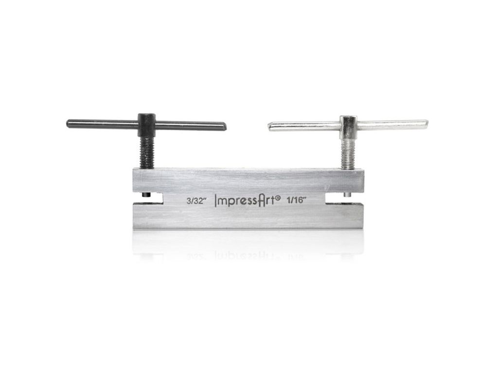

                #611269
                David George 1
                  @davidgeorge1
                  There is a tool made for this job it is to punch holes in metal. You could copy design or buy one. There are diferent sizes made.
                  David
                  #611271
                  DMB
                    @dmb
                    Hi George,
                    Just some thoughts on your post for helping beginners.
                    If I may make suggestions for constructing the above screw punch. Stamp punched hole size each end as per piccie. The screws made from silver steel with the punch end drilled out tapered – centre drill?? Harden and temper light straw at business end so it will do thin steel sheet/.strip poke it thro a spud for heat treatment.
