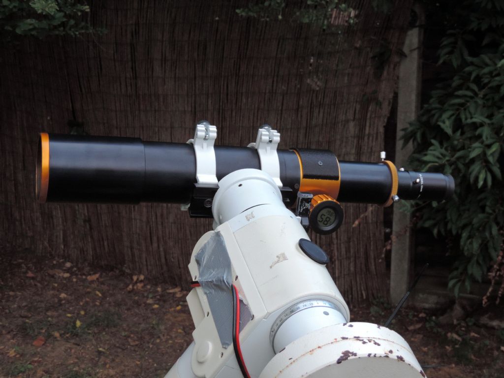

                          I had great results with a 12V 4A charger. I use a moving ammeter to keep an eye on current. It swings off the scale at first, but drops in less than a second.
                          The current self-regulates with the area of the piece, and if a bit low just keep it in longer. I always turn the part once.
                          For smaller parts keep the cathode further away.
                          I anodised most of this scope, the main tube is about 10" long, about 3" diameter so that's approaching 200 square inches inside and out.
                          Don't obsess about the voltage the things that matter are thorough stripping, cleanliness, good electrical contact between cathode (I use TI wire, cleaned with abrasive paper), professional dies and if you want to add another – more cleanliness.
                          Also, be careful, these are nasty chemicals.

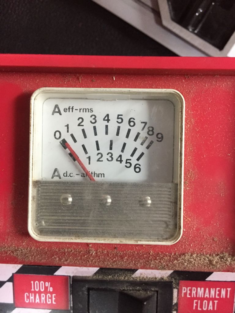

                                            Thanks. Encouraged by Neil's excellent results with his telescope I made some preliminary experiments with the battery charger using brine as an electrolyte – I just wanted to see how it coped with differences in electrolyte concentration, electrode areas, separation &c and didn't want to splash acid about at this point. It claims to be 'intelligent' but obviously that's for its intended purpose – I don't suppose an anodising tank looks like a car battery from the charger's point of view. But it seems I can fool the thing, and that this is going to work.
                                            As an aside, the ammeter on the charger has two scales – 'effective' RMS amps and 'Arithm' amps:
                                            I suppose this means that the output is unsmoothed, but I don't understand the ratio A_rms/A_arith =1.5 . Any elucidation would be welcome!
                                            Robin.

                                              Posted by Robin Graham on 16/01/2020 22:41:28:
                                              Yes, the ammeter confirms the output is un-smoothed. If the anodising results are iffy, I'd try sticking a capacitor across the output to see if it helps.
                                              I think the actual ratio is A_rms/A_arith = 1.414 (approx 1.5 on the ammeter's scale)
                                              1.414 is the square root of 2, and it defines the relationship between AC peak Volts and AC rms Volts in a sinusoidal waveform. Vrms = Vpeak / sqrt(2)
                                              Following a waveform peaking and troughing 50 time a second stretches the imagination. It's often more meaningful to ignore reality and work with the average value instead. Various ways of calculating averages, but Root Mean Square is the most useful way of calculating the average value of a sine wave. It's like flattening out the wave by filling the troughs with the peaks.
                                              Not sure having two scales on the ammeter is worth much beyond a general indication the charger is working. The meter used in chargers is only about ±25% accurate. On a Charger they indicate 'not working or finished', 'about right' and 'lots, maybe too much'. Useful, but not precise!
