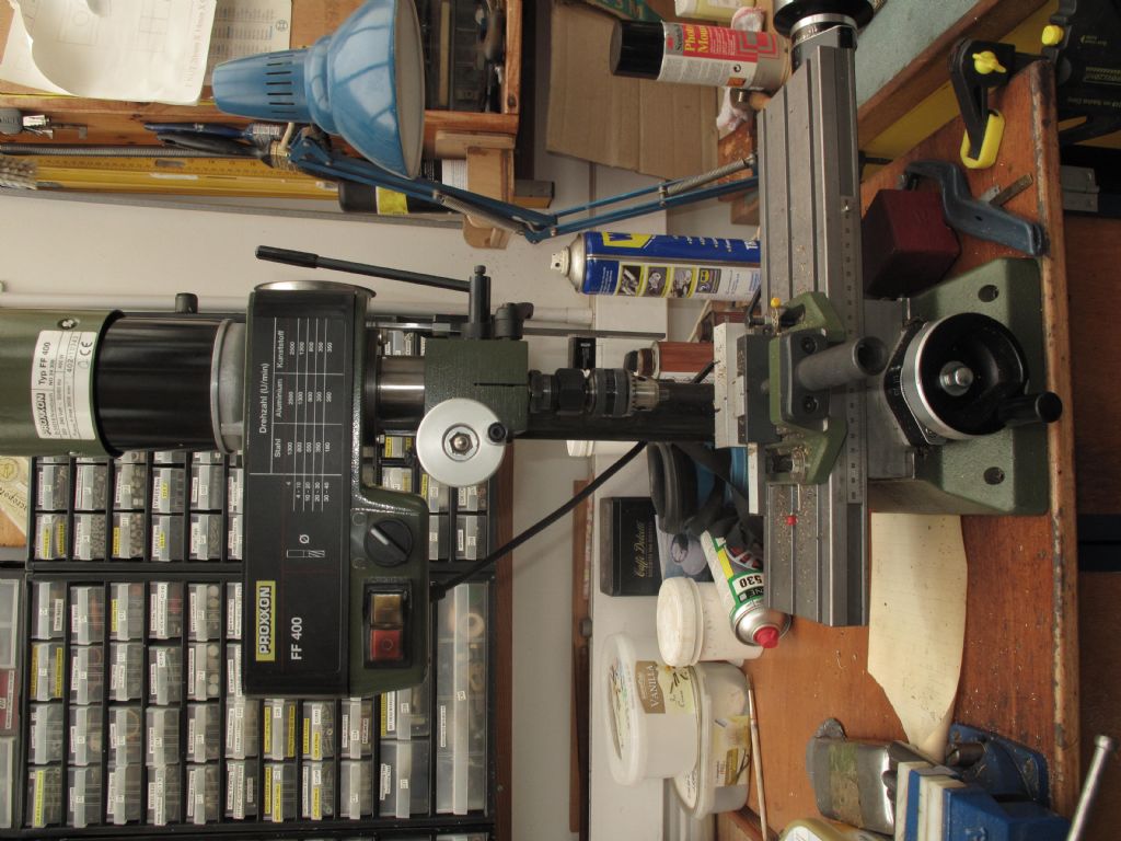

      Having experienced the motor get very hot on my FF400 which I think is a common problem in all but very light us, I wondered if anyone has any suggestions to a suitable motor upgrade?
      Having experienced the difference between single phase and 3 phase vfd this was my first thought. However I am not sure a suitable motor exists eg size, power & price so I was thinking of variable dc and perhaps a used treadmill motor.
      What are other peoples opinions and suggestions?

          Difficult to find this mill. Seach for Proxxon FF400 brings up a fine downfeed accessory. On another thread started by someone whose table saw motor had just blown I said that Proxxon products seemed "over-priced and under-engineered" (based on my experience). What you describe sounds like another manifestation of this. Could you post a photo?
          Generally many of the small mills based on the "X1" platform use DC motors and AFAIK they aren't known for running hot though the controller boards seem rather fragile. Depending on the design of the mill fitting a 3 phase induction motor could be difficult as they tend to be rather large compared to DC motors of the same power.

              I can't find the FF400 either. Can you post some photos Jon? Howto here.
              I think it's a micromill with a small high rpm motor, intended for light modelling: OO-gauge, Radio Control, PCB-work, dolls houses, clocks etc rather than 3.5" locos or bigger. Not a metal muncher.
              The problem with up-motoring machines is the risk that the available power becomes unwise relative to the machines rigidity, bearings, belts, and gears. A micromill that whizzes through Brass with 200-300W to a small cutter at 4000rpm will probably flex like a ripe banana when asked to push a 10mm 4 flute cutter through steel with a 500W motor. Gears are likely to strip, belts snap, lead-screws wear and other damage. It's akin to me dropping a 3litre NOX boosted engine into my urban hatchback without bothering to upgrade the wheels, radiator, oil pump, suspension, brakes, clutch and gearbox etc.
              I suspect Jon doesn't really want an FF400 with a bigger motor, he needs a bigger milling machine!

                  Yes machine is the same as posted pic by jason, not a great amount of power only 400w. However it is a lot bigger than a mini mill so I would expect it to to do a bit more than 00 gauge.
                  The travel on the table is 200mm X 100mm Y 100mm Z or there abouts.
                  I have yet to put it to any serious tests, I tried milling some mild steel with some cheap hss router bits. It got very hot!

                              Following Pauls post I did a bit of homework and I found that Proxxon have over-egged the power rating on the motor it is not 400w only 180w!!!
                              Before anyone checks I have my facts right I checked with Atas the motor manufacturer.
                              No wonder the motor gets hot and has a short duty cycle, it seems as other people have said that Proxxon are overpriced and under engineered!
                              That said compared to the Manix mini 140, which I think this was inspired by, it is a bit more beefed up in terms of parts. Which brings me round to my motivation to upgrade the motor.
                              I was thinking hyperthetically I could put 550w 3phase motor. The only problem I can think of is the 3 phase motor I found would be 6kg instead of the existing 4kg 1 phase. Would this be a problem either in extra weight or torsional stresses?
