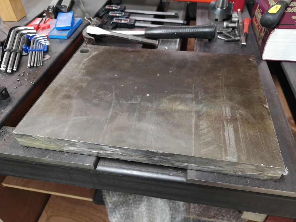

        This, like many of my projects I suspect, is a spin-off from [Project 3] Dickson T1 Tool Holder
        This option was chosen because it seems the most sustainable i.e. it will be used on other subsequent projects.
        I have, in my possession 2 x 32mm thick steel plates taken my old welding table. They're 90kg each!
        I took a section from one of them using a 4" angle grinder!
        It's around 400mm x 250mm (and weighs 20kg).
        The first task will be to square it up.
        However, a couple of issues are impeding;
        • It recently transpired that my facemill has shoddy inserts
          • Currently waiting on new ones from Arc
        • I am lacking low-profile table clamps
          • [Project 5] I think! Sheesh, how far does the rabbit hole go?

          #474584
            Put a few counterbored holes in it to hold it down with some short cap heads.
            At that size you are going to need a big stack of gauge blocks to get 45deg!
            #474595
            Martin Connelly
              @martinconnelly55370

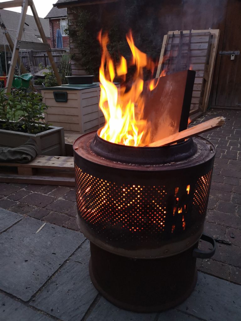

              Welcome to the world of sub-sub-sub projects. It may be worth thinking about annealing such a large plate before you start skimming the face and finding it curling up. Think large bonfire and leaving it to cool in the ashes. With such a large plate it should be possible to have extra clamps around the edge and remove and replace them as necessary to leave a clear path for the tool to pass while still keeping it securely clamped. Change clamp positions when the tool has gone past the end and before the next cutting pass. I would also recommend using packing under the plate where the clamps are before skimming the first surface to avoid any rocking of the face against the table. Nothing major, just needs to be strips of something with consistent thickness such as a bit of 16swg plate.

                  Posted by Martin Connelly on 24/05/2020 19:52:37:
                  Martin C
                  Re-clamping was certainly an option, I need an excuse to make LP ones. 😀
                  Will I have to re-temper after?

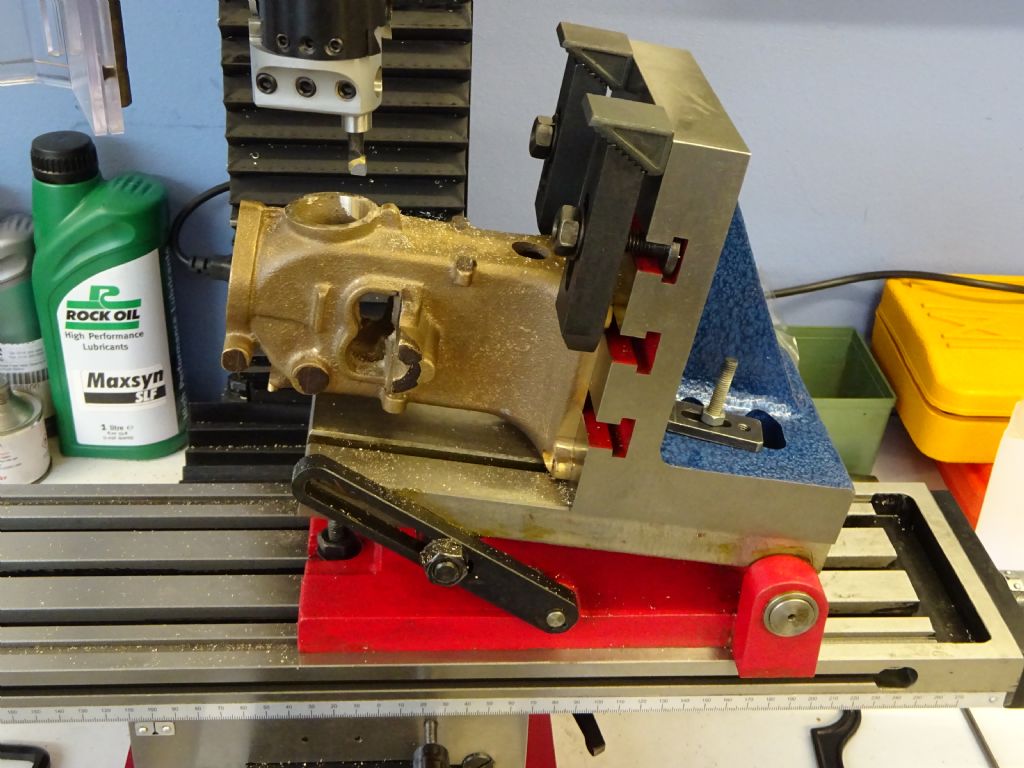

                  #474602
                    If you are not going to be setting it accurately you may as well just make an angle table and rough set with your digi box then clock it to final position. Add a jacking screw for easy setting, this sort of thing

                      No re-tempering, you are making sure it is soft and stress free before cutting it. It may already be stress free but for something this large better safe than sorry. Just think of all the little spots on top of a weld table that have had localised heat treatment that may have created stress.

                      #474640
                      Lee Jones 6
                        @leejones6
                        Posted by JasonB on 24/05/2020 20:15:14:

                          Posted by Martin Connelly on 24/05/2020 20:27:13:
                          Martin C
                          Got you. Makes sense.
                          So long as the entire structure won't all become too soft.
                          #474644
                          Martin Connelly
                            Soft here is a relative term. It will never be as soft as lead but it won't be as hard as tool steel. It will hopefully be like a nice even piece of mild steel.

                              #475955
                              Lee Jones 6
                                @leejones6
                                For you Martin:
                                #475958
                                Steviegtr
                                  @steviegtr
                                  Bet your neighbours think you are nuts. Trying to burn a block of steel. cool
                                  Steve.
                                  #475959
                                  Lee Jones 6
                                    @leejones6
                                    Think I'm going to take up blacksmithery!
                                    Just going to sit here with my whisky until it becomes malleable!
                                    #475961
                                    Martin Connelly
                                      Tell the neighbours it's engineering, see if they believe you wink
                                      Martin C
                                      #475962
                                      Lee Jones 6
                                        @leejones6
                                        And I quote, "that's it, he's finally lost his last marble". laugh
