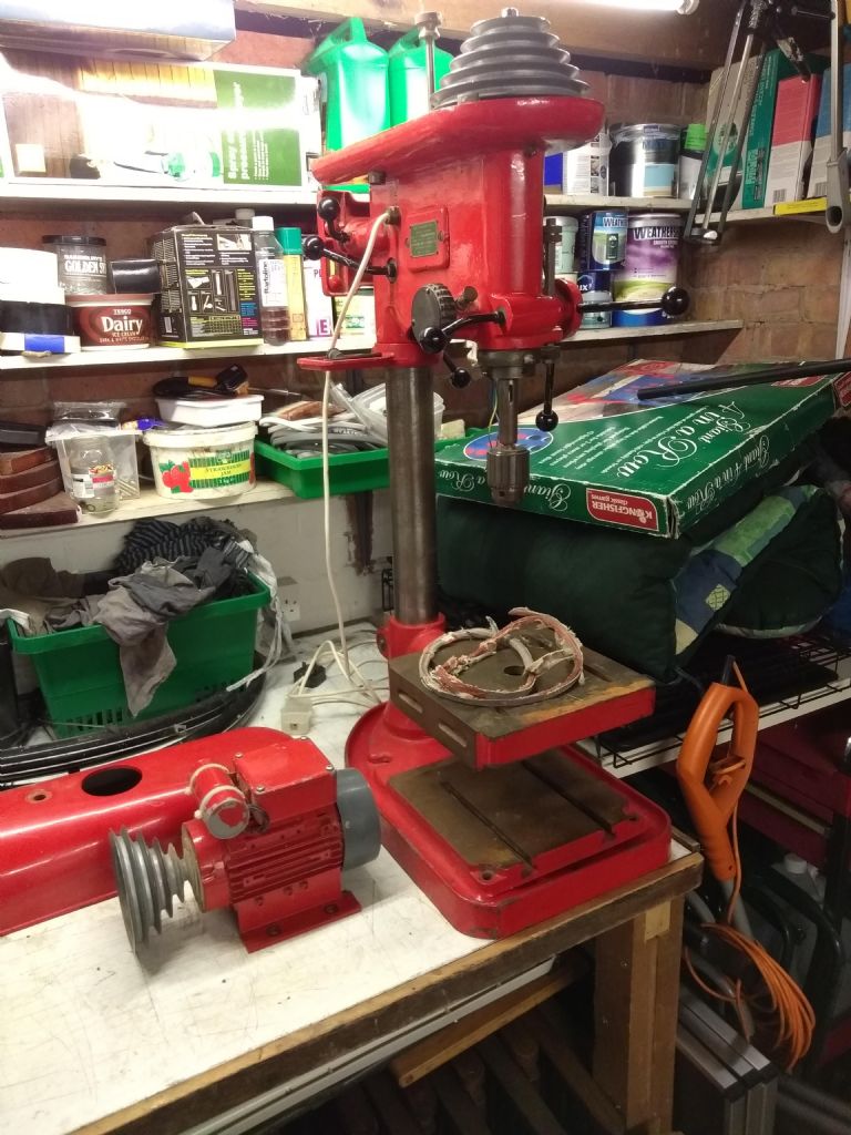

      Hi,
      I got the above type bench drill the other day and the tool tray is so tight on the column that the only way to get it off was to gently knock a cold chisel into the split on the casting to loosen it.
      Is this normal? I'm tempted to enlarge the hole on the mill regardless, moving the head up and down is going to be a nuisance if I have to get the chisel out every time I want to.
      Simon.

        Vic
          @vic
          I’ve never had that problem with mine. It was pretty tight coming off when I first got it but that was because of the accumulated crud on the column. Once it was clean it was fine.

          Simon Orchard
            @simonorchard42334
            The top of the column where the head sits is clean, further down it's a bit grotty but the tray won't drop back over the column despite wiping it and the hole in the casting.

              Clive Foster
                @clivefoster55965
                Simon
                Odds are the clamp has been seriously overtightened for many years causing the cast iron to flow slightly distorting the hole. Simply opening the split doesn't work because the distortion causes another bit of the hole to grip. Super cleaning, careful inspection and a bit of abrasive work on the lobes will sort it. PIA job as the amount of effort involved in getting it right is out of all proportion.
                If you do put it on the mill I imagine that clamping up with a suitable washer in the slit and inspecting the bore with a dial gauge will identify any internal lobing so you could bore it back to true size and roundness. If I ever get conned into doing another job of that sort it will get re-engineered with a floating collet system instead of a simple clamp up slit. Much nicer to move and very little torque on the bolt to tighten. Use a stud with a Bristol handle.
                Clive.

                Simon Orchard
                  @simonorchard42334
                  Here it is in all it's fire engine red glory. The new belt appeared this morning so hopefully I can get it set up after dinner (Dad is coming round to investigate, an extra machine tool in the family is cause for celebration!).

                          Jeff Dayman
                            @jeffdayman43397
                            Pic is visible to me. Re your overtight collar – is there room beside the clamp screw to drill and tap for a setscrew? If so the setscrew could be installed to "jack" the halves apart a bit to ease movement (after loosening the clamp screw of course). Not terribly convenient but not very involved to do either. Coarse threads largest dia possible would be a good plan I think, if this idea is possible.

                            Simon Orchard
                              @simonorchard42334
                              How about doing it the other way. Turn a sort of dimpled disc that goes into the slit to fit the plain hole in the clamp and use the other threaded hole to force the clamp open against it? Something like a stopcock wheel on a threaded rod.
                              It means relying on the fact that the clamp is too tight rather than positively closing it, but it's only a tool tray and if it relaxes over time then I can put it back to standard again.

                              Jeff Dayman
                                @jeffdayman43397
                                Hi Simon, if your clamp screw will fit from the other side your suggested method should work I think. A plain piece of sheetmetal or gauge plate slipped into the slot and maybe taped in place would be even simpler than the dimpled bit. As you say, this method is reversible later with no damage to machine if things relax in time.

                                  Simon Orchard
                                    @simonorchard42334
                                    By all means, butt away. I hadn't considered fixing it down, but then I hadn't thought about how top heavy it could be. Bolt it through the bench top or screw it?
                                    Updates on the machine:
                                    The tool tray casting gets in the way of the clamp handle going in the wrong way unfortunately, on the mill it will go.
                                    The new belt was fitted last night and it runs with no discernible wobble in the spindle nor play with it at full extension. Parental approval says it's a good machine.
                                    Tony Griffiths says that the extension is part of the spindle, someone on another forum says that he has the same one at work and there's a ring with a tommy bar hole that can be wound down to force the extention off of a Jacobs taper at the end of the spindle. – Discuss

                                      Simon Orchard
                                        @simonorchard42334
                                        Posted by Brian Wood on 20/07/2018 10:57:44:
                                        I am confused over your tool tray that you refer to, where is that situated as it's not obvious in your picture.
                                        Hi Brian,
                                        The thing I am referring to a tool tray is sticking out on a separate cast ring just under the drill head on the column. It's just below the second shelf up and has the chuck key sitting on it in the picture. It's a very useful stop to prevent the head from falling down the column when you unclamp it. I am aware that it isn't a substitute for the head clamp!
                                        I'll try unscrewing the ring, it would be nice to get the clearance between the table and the end of the chuck.
