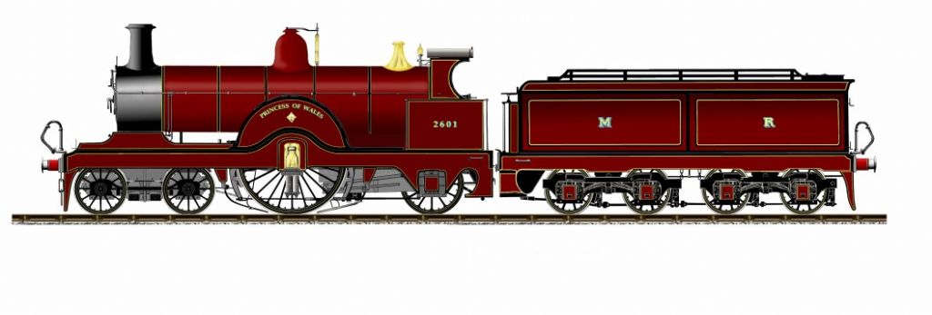

        hi , I construct a POW ….for the six wheels tender , I don't see anywhere the spacing between the frames ….
        the drawing is poor and incomplete ,no rivets or fixation visible , no interior detail and York is 1000 miles away !
        a little help was needed ! thanks epine 43 from France

                I am on the net … the more needed detail is the spacing between the frame….
                for the interior , the laser-cut parts give me a good view how it was.
                I think this tender was riveted , but Reeves drawings was blank !
                thanks

                  In the articles Martin says that the POW tender is very similar in construction to the tender for Nigel Gresley so I would say that the distance between the frames should be 6.375"

                    ah, ah , my first estimation was 160mm, so 162 mm is a good base !
                    the numerous photos on the net don't give little détails….
                    I have already buy photos , by NR of Yok , or e-bay, but always taken from the front angle !
                    the nigel gresley tender was interesting……it was exactly the same , or not ? it's possible to buy a drawing ? , and where ? Reeves ?

                                      As I am building a similar Midland railway model from Derby works drawings it is possible for me to offer some information. The dimensions in 5 inch scale 1-11.3 in mm are fr the 6 wheel tender between inside frame is 114 mm and between outer frame 156 mm. For the loco it is 161 mm between outer frames. As I understand the POW frame drawings dimensions are wider so adjustments would have to be made. Happy to help you more regards Herb.

                                            after all your help ( special thanks to Ady 1 and Herbert ) my tender become a reality!
                                            I use the brass parts of model laser, it's a great saving of time , but a great hole in my bank saving !
                                            many thanks jean-louis

                                                      last year I finish some details of my Washington , illustrated on the cover of ME no 4559…now , I come back at my POW and start the painting….I make a TRY with RAL 3003 (rubinrot ) , but the red is too flashy !
                                                      when I look all my photos on the subject I see clear red (loco 673) , dark red , even matt maroon , all very different…. I see sometimes "crimson lake " , but have you an RAL equivalent or where I can buy this color, preferably in two component fashion ?
