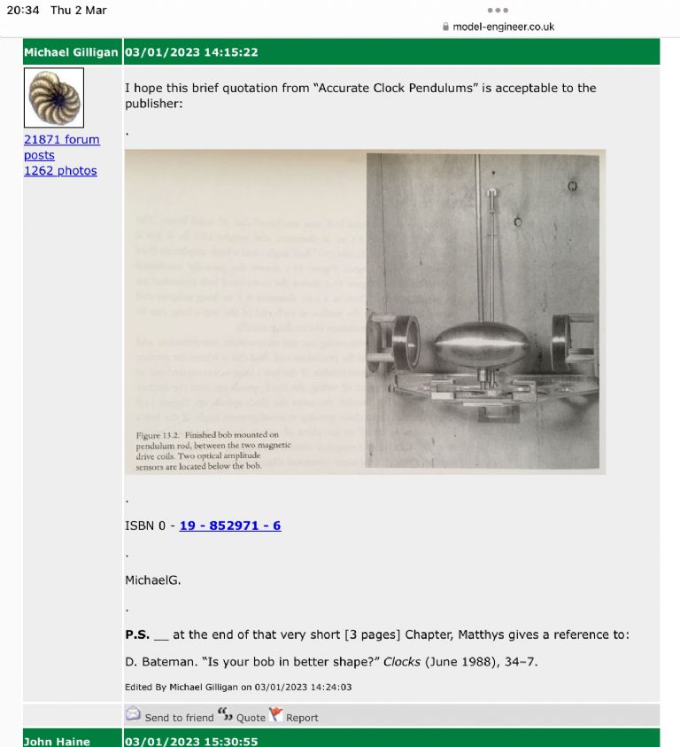

                  #635750
                    Posted by John Haine on 02/03/2023 18:44:52:
                    S K, I think that's a very interesting point about having a horizontal lenticular Bob. The only snag might be clearance to the case? …
                    The main objection I can think of is a flat disc is more likely to collect dirt. It would alter the period by moving the bob's centre of gravity, and drop Q by making it harder for the bob to pass through the air.
                    Both effects would be small, but as I've learned from painful experience, small things matter in precision clocks!
                    Cylinders aren't ideal. I'm using a cylindrical bob of about 3:1 shape which the experiments reported in 3rd Edn Rawlings found to be the worst possible shape. I used a cylinder because they're easy to make! As tall thin cylinders are bad, I guess SK's short fat cylinder might score by being least worst of the clan!
                    A 2:1 parabolic spindle did best in Rawlings, presumably mounted vertically, so the aerodynamic shape cut through the air.
                    Be interesting to compare the Q of a pendulum with a flat disc mounted vertically and then horizontally. Swinging the bob through the smoke from a Joss Stick might show if one alignment is more turbulent than the other.

                        Posted by SillyOldDuffer on 02/03/2023 19:46:15:
                        Au Contraire if I remember Matthys correctly
                        … I will have a look for my previous posting.
                        Edit: __ https://www.model-engineer.co.uk/forums/postings.asp?th=184124&p=14

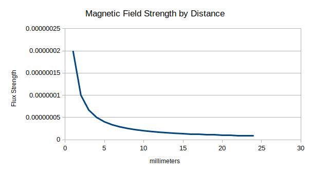

                            #636094
                              Posted by John Haine on 04/03/2023 12:18:03:
                              Posted by S K on 02/03/2023 19:15:09:
                              Do you have any comments about the mechanical vs. your newer electromagnetic impulsing?
                              … The jury is out on my new impulsing method, there seems to be a lot of "microsecond level" noise in the measurements and I'm uncertain what is causing it, whether it's some spurious rod mode or possibly some play in the suspension. Currently trying to diagnose.
                              Me too. I lack a comparison because I've not built a mechanically impulsed clock, let alone a good one. However, I have a notion that an electromagnet can be tuned to apply a softer accelerating impulse than any mechanical method. My electromagnet is side-on and about 15mm from the bob when it fires. As can be seen from the graph, the resulting field is low at that distance, and it's strength rises gently into a knee at about 5mm after which the field strength rises rapidly as distance to the pole drops. The idea is that the bob accelerates gently up the slope, and never jolted because the electromagnet is switched off before the bob gets too close.
                              The field strength can be controlled by altering pulse width, which is how I'm doing it at the moment, and/or by controlling the shape of the pulse with a resistor/capacitor. A key advantage, as I see it, is the ability to control the impulse across a wide range of values and timings, so that it can be optimised without having to rebuild a precision mechanical system. Might even be possible to optimise the magnetic impulse on the fly.
                              Seems to work but it remains unproven! Cause for concern includes the microsecond level noise noted by John. I hope my noise is explained by the mechanical shortcomings of my suspension, but I may also have spurious rod modes, that is the pendulum rod being twanged even by tiny impulses.
                              For what it's worth, next graph is a Fast Fourier Transform of my clock's last log file. FFT extracts frequency information from a data stream, revealing what the frequencies are, and how strong:
                              Ideally, the FFT analysis of my pendulum, which has period of about 0.83s, should have only one frequency in the output, 1.2Hz. Oh dear, it doesn't: FFT identifies a significant amount of energy at 0.6Hz, and 9 spikes 0.159Hz apart. These indicate other sources of oscillation, such as the rod twanging, the suspension twisting or rocking, or the frame shaking.
