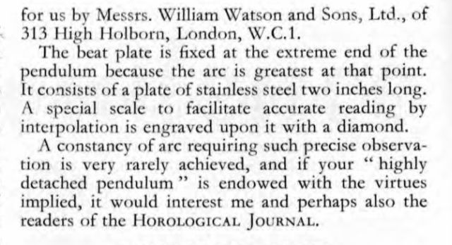

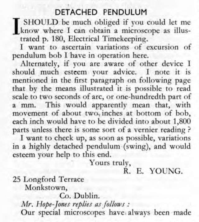

              #632901
                This, from the Letters in Horological Journal, May 1941 may be of interest:
                With the advantage of electronic camera-sensors at our disposal … this should be relatively simple to emulate.
                Ref. __ https://clockdoc.org/gs/handler/getmedia.ashx?moid=57393&dt=3&g=1
                Note: Page 180 of the book is page 208 of the PDF, but it is really worth reading the whole chapter.
