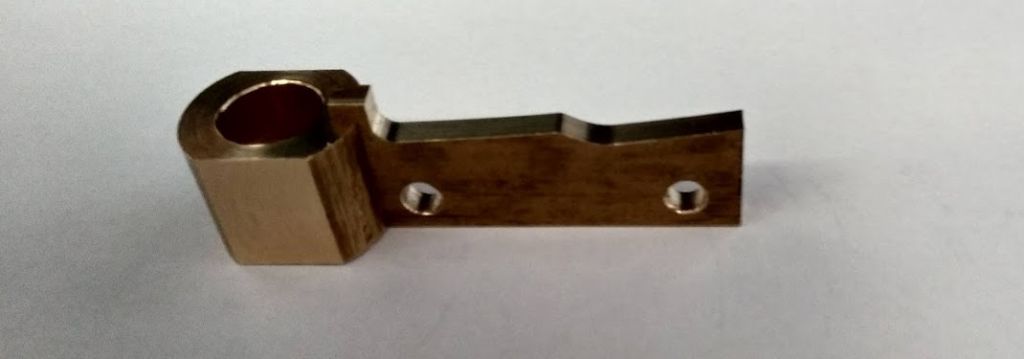

                For my first clock I decided to use a gravity escapement based on the Synchronome for the reasons that Martin suggested. In fact I used an old 'Nome as a basis though the only parts retained are the cast frame and the gravity arm, and the dial mech (it came without a pendulum). The arm is lifted by a small stepper driving a snail cam, the pendulum sensed by an opto, and all controlled by an Arduino – hence "Arduinome". I used the stepper for the arm because it can be much better controlled, and the pallet design is based on the raised-cosine shape that Shortt proposed. In principle you can set up the clock so that the gravity roller is just half-way down the cam when the pendulum is stationary so the impulse should be exactly symmetric and centred. In practice that does not give an actual central impulse and looking at detailed timing measurements there is a distinct phase step on each impulse. Correcting this needs a real-time measurement of the time shift which is hard to do though I did kluge the control software to do it. Whether the adjustment survived the clock being moved from workshop to kitchen I don't know!
                I also found that I had to be very careful about setting the pallet exactly in the plane of swing to avoid imparting a twisting motion to the pendulum. The rod is carbon fibre and so very light, and the impulse also imparts a distinct "wobble" to the rod because the CoP is virtually at the bob CoG. So though in principle I think mechanical impulsing could be better (and in fact can be as in Clock B), I don't think it's any easier to set up than electromagnetic.
                Of course the Fedchenko clock shows that EM impulsing can be very precise and that has no amplitude control, instead a special spring design that corrects for circular deviation.
                #633121

                    Posted by John Haine on 12/02/2023 11:39:06:
                    I thought that the pallet was meant to be the segment of a circular cone with the proper profile if that makes any sense. Think of a sectioned bell perhaps. That way the slope is always radial to the rod so provided the roller is square to the swing there should not be any twist. I made mine like that but as it’s not finished I cannot comment on the outcome.
                    regards Martin

                        My pallet is just 1/8" wide so not much opportunity to shape it.
                        #633163
                        Martin Kyte
                          @martinkyte99762
                          That would explain it John. Mine looks nothing like that.
                          regards Martin

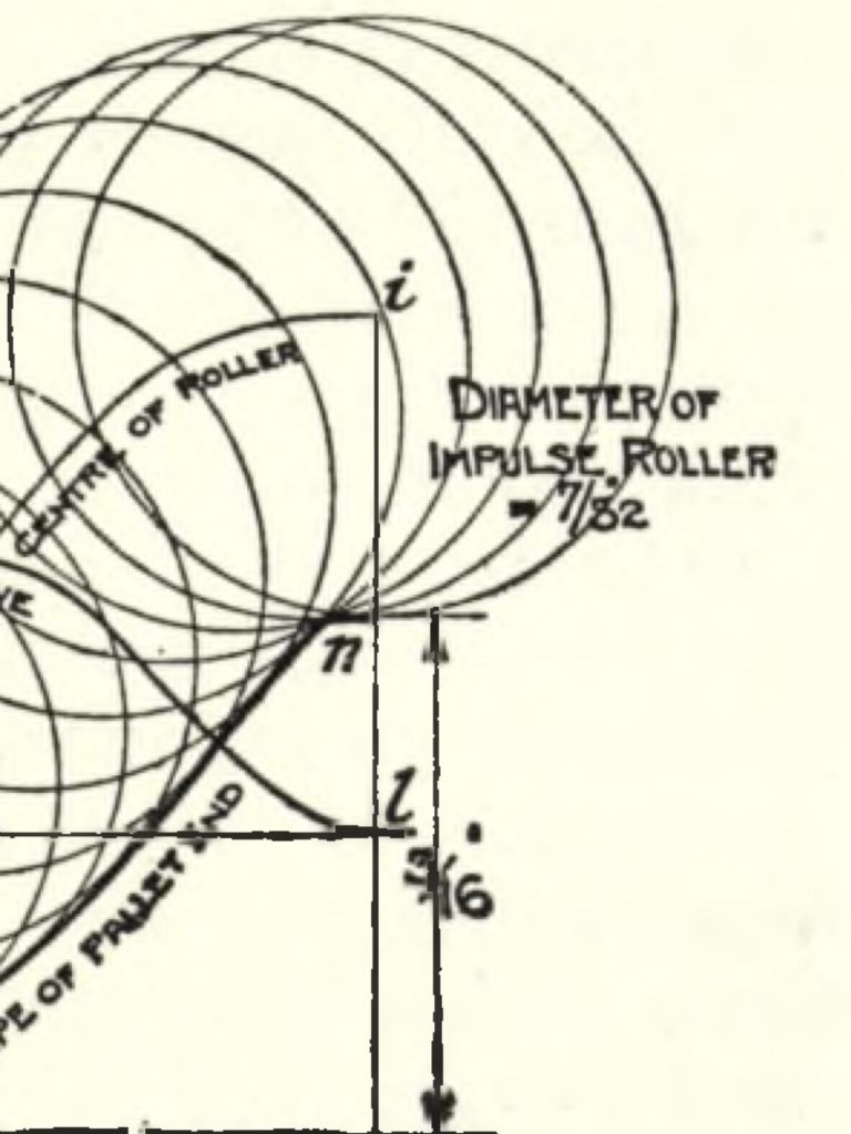

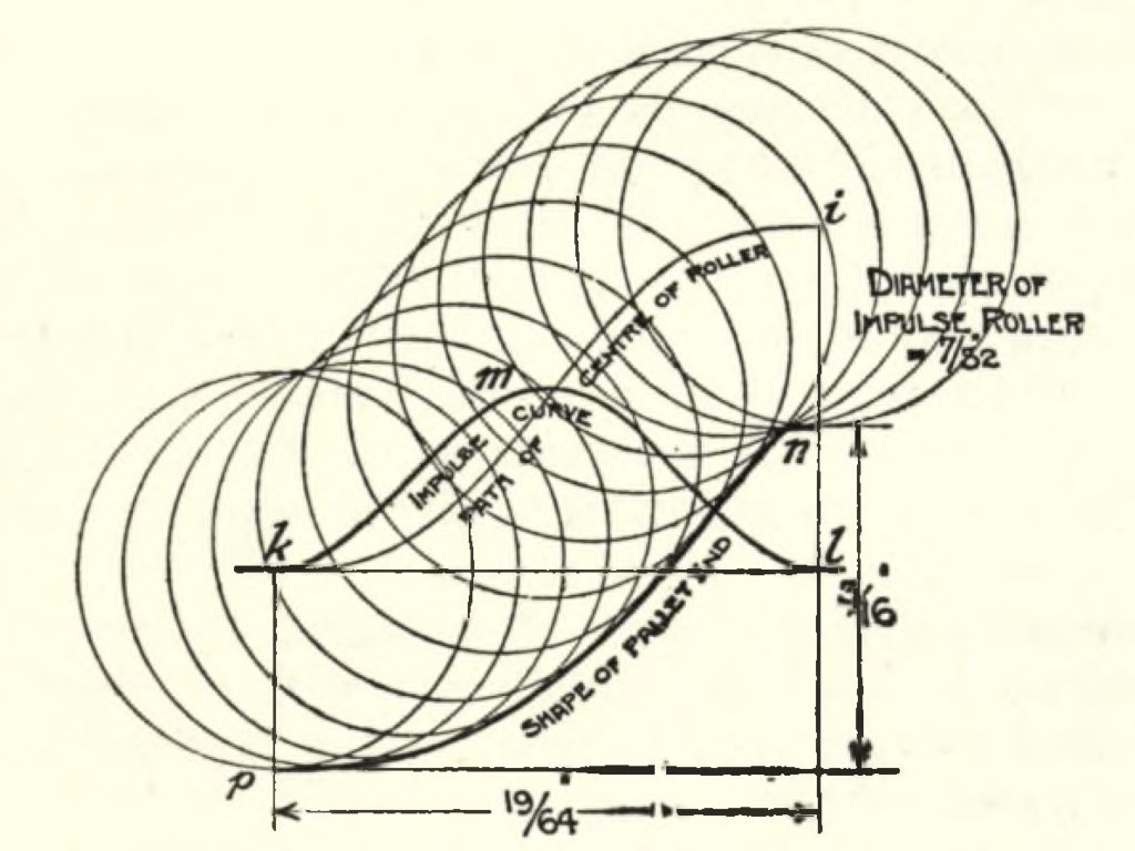

                            Putting my head briefly above the parapet … may I refer to my post on 01-Feb, here at 17:18:26  **LINK**
                            https://www.model-engineer.co.uk/forums/postings.asp?th=184659&p=2
                            [ exits before the flak starts flying ]
                            Edited By Michael Gilligan on 12/02/2023 18:53:45

                              Thats what mine looks like. Made with a form tool with the pallet on an arbor in the chuck to generate the circular arc. That way if the pallet is slightly skew it doesn't matter.
                              regards Martin

                                Well, strictly the pallet face isn't circular! Mine is CNC profile milled, such that a follower roller of the right diameter follows a path that gives a raised-cosine force, just like the red curve in the picture you posted Michael. Probably a circular arc isn't far off though.

                                  Am I correct in thinking that Michael's red curve doesn't allow for the roller diameter? The scan appears more sharply curved at the top
                                  #633203

                                      Posted by duncan webster on 13/02/2023 00:09:38:
                                      Michael’s red curve is the ‘Path of Centre of Roller’ … not the ’Shape of Pallet End’
                                      … We were ‘reverse engineering’ the diagram, to work out how to mill the shape using a cutter having the same 7/32” diameter as the roller.
                                      Edit: [for the avoidance of doubt] __ the ‘Diameter of Impulse Roller’ is shown as 7/32”
                                      Edited By Michael Gilligan on 13/02/2023 03:11:28
                                      #633205

                                          The problem of profiling the pallet is that 7/32 cutters aren't a standard size so a path has to be worked out to use a smaller one.
                                          #633214
                                            Posted by John Haine on 13/02/2023 08:28:58:
                                            Could be worth grabbing one of these: **LINK**
                                            https://www.chronos.ltd.uk/product/hss-endmill-7-32-diameter/
                                            Edit: or plain-shank carbide from Zoro :
                                            https://www.zoro.co.uk/shop/cutting-tools/carbide-end-mills-regular-series/7-32inch-4fl-standard-carbide-end-mill/p/ZT1151543X
                                            …or re-scaling the components slightly, and using 5.5mm
                                            Edited By Michael Gilligan on 13/02/2023 09:03:12

                                            duncan webster 1
                                              @duncanwebster1
                                              Posted by Michael Gilligan on 13/02/2023 02:58:34:
                                              That makes sense

                                                I must admit I didn't bother to look if a 7/32 mill was available, as I preferred to use a size I already had (4mm IIRC). I could have changed the roller diameter but I was using the original gravity arm and roller.
