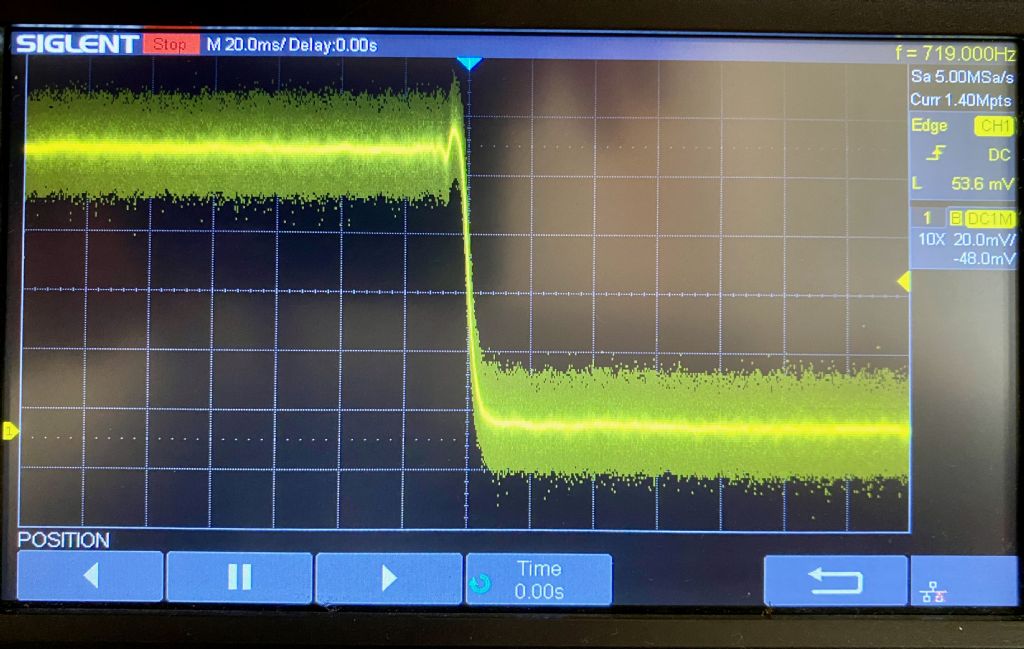

In the measured scenario here, the rise and fall times are ~3ms (as I am currently seeing with a slit in front of it). That's 3,000,000 times slower (!), just because the pendulum is so slow. Now, as the voltage is very slowly crawling up, any superimposed noise on that signal (I'm seeing a lot) will also be amplified by the op-amp, comparator, etc., and will cause the output to trigger either earlier or later than the ideal switching point (threshold). Over that 3ms rise time, even a little noise will cause the output to trigger earlier or later potentially by many us – which is what we are seeing with the Sharp opto. It may even bounce many times as it crosses a noisy threshold (a latching comparator or Schmitt trigger might be needed).
So, the slower the slope of the input signal, the more that any noise on it will cause the trigger to jitter. We want as fast a rise/fall time as possible right at the PD, and also a fast comparator. But also, we somehow want a fast pendulum! The pendulum is literally a million times slower than my PD!

The noise is very high, seems constant and isn't related to the light input, so I suspect the DC circuit. Could the reverse bias voltage be too high causing the diode to break down like a Zener or Avalanche type? It's done deliberately to generate RF noise.
Or has the diode been accidentally forward biased?
It's not forward biased, and the reverse bias is only 5V out of a specified 25V max. I'd have used 10V or more, but the laser requires 5 and I only have one decent power supply. There's no difference between illuminated and not illuminated (as you point out), but I should disconnect the laser power completely to check that the laser isn't spitting too much noise back out onto the power supply.
It's about 35-40mV peak-to-peak, and about 6-7 mV RMS. I note that the scope is claiming 719 Hz, but that's probably spurious, as I don't see any oscillation when zoomed in (it just looks like noise).
It's probably just a "normal" amount of noise for a circuit with a ~5 MHz time constant (20 pF and 10k), and one with iffy grounding and excessively long wires (formed in a big loop!). I've seen worse. If I tightened things up, payed better attention to grounding, etc., it would drop some.
As well, there's no point in maintaining such high bandwidth if the illumination changes so slowly. I could drop it to somewhere around 1-10 kHz, which would also reduce noise considerably.

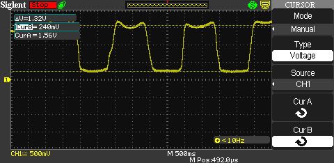

I tried the "cylindrical mirror" idea, despite thinking that it wouldn't work well.
The cylinder was the Invar rod, which is semi-polished. The laser and photodetector were at right angles, with the photodetector about 6" from the rod. This yields a 45 degree angle of incidence of the light upon the rod when reflected to the diode. I could not include a slit since the amount of received light was much lower.
Here's a scope photo including 4-5 passes of the laser. I am still trying to interpret the details, but it's a poor result that is not promising. Maybe some related idea can still work, but this one will likely not.

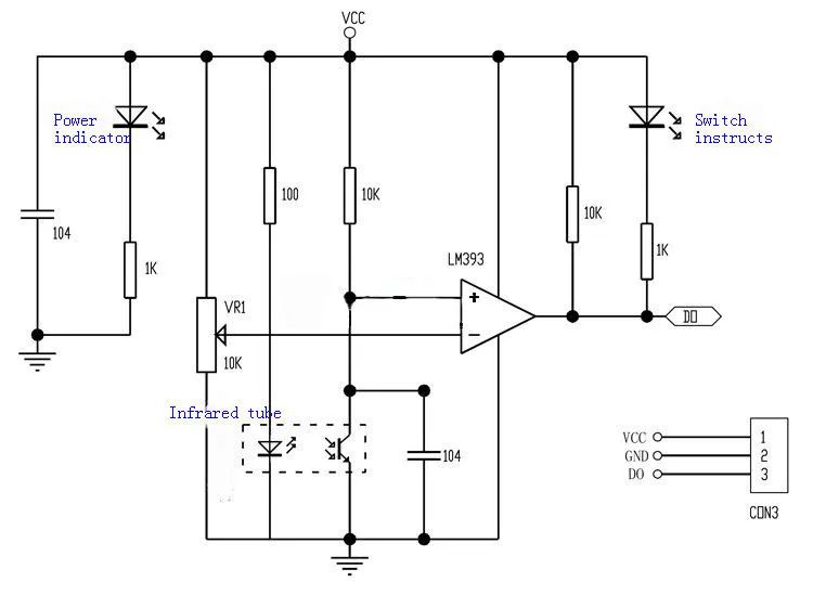

I'm going to measure how noisy the sensor in my cheapo Arduino module in hope I can do it quickly. (I don't have much spare time at the moment and the earlier question about whether of not my data has a normal distribution has dropped me into deep water. Q-Q plots, Shapiro-Wilk and Kolmogorov-Smirnov – yer wot? Also John has sent me a couple of papers to read, and am struggling with the maths. Years ago I attended a class called 'Maths for Scientists'; should have been called 'Last Hope for Boys Too Dim to Understand Calculus'.
If my Arduino module's sensor is as noisy as SK's I'll have to think again. If the sensor is quiet, he will!
It appears the sensor in my cheap Arduino module works better than SK's.
The module uses this circuit:
The photo-transistor is decoupled by a 0.1μF capacitor, and so is the supply.
With an oscilloscope connected between ground and the top of the photo-transistor, waving my hand produced this output:
The phototransistor is 240mV above ground
Noise level is about 80mV
Signal level is 1580mV above ground

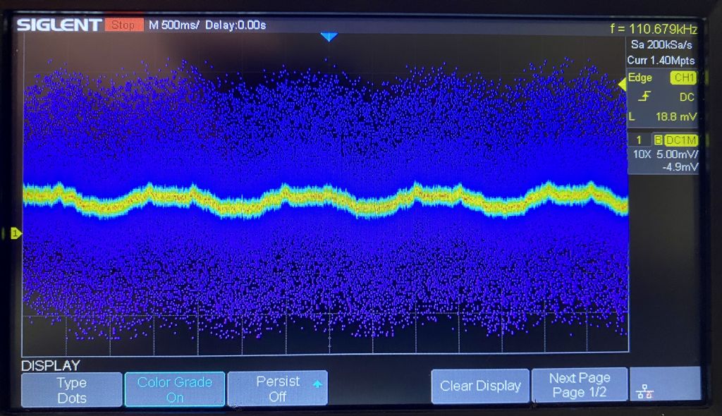

Noise: The electronic noise at the photodiode as seen in my scope traces is not particularly pertinent. Why? Because that photodiode's intrinsic speed is about a million times faster than the speed of the shadow across the sensor. The next step would be to reduce the bandwidth and hence the noise until it's appropriate for the shadow's speed. A phototransistor is slower but has internal gain when compared to a photodiode. Given how slow the pendulum is, perhaps that's a better starting choice.

Noise not pertinent? On the 11th: 'In the measured scenario here, the rise and fall times are ~3ms (as I am currently seeing with a slit in front of it). That's 3,000,000 times slower (!), just because the pendulum is so slow. Now, as the voltage is very slowly crawling up, any superimposed noise on that signal (I'm seeing a lot) will also be amplified by the op-amp, comparator, etc., and will cause the output to trigger either earlier or later than the ideal switching point (threshold). Over that 3ms rise time, even a little noise will cause the output to trigger earlier or later potentially by many us – which is what we are seeing with the Sharp opto. It may even bounce many times as it crosses a noisy threshold (a latching comparator or Schmitt trigger might be needed).'
Cause of Jitter in my measurements, I don't know – very much still under investigation.
For simplicity I'm an aperture man too! A potential advantage of a lens is they gather more light, if needed. Don't think it is, there should be plenty of signal inside a clock case even from a weedy emitter struggling to poke energy through tightly spaced slits because the beam only has to travel about 300mm maximum. I think a 1mW laser would be detectable several hundred metres away.
The noise at present is not pertinent because the photodiode's bandwidth is absurdly larger than the required bandwidth, like by a factor of a million, and I'd reduce it dramatically before going much further. The circuit would still benefit from a fast comparator, though: Match the bandwidth of the sensor to the input light's rate of change, then use a fast comparator for timing.

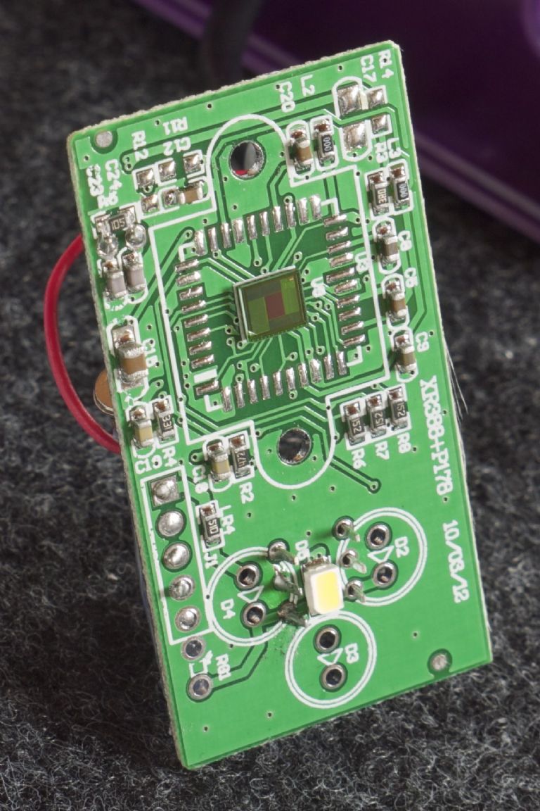

As promised, John …
This is very simple stuff, but if I have glossed-over anything, just shout
Here is the board from a little webcam:
I removed the lens assembly [ you can see its footprint] to reveal the sensor chip:
The small brick-red rectangle is the active area.
I have never managed to identify the actual chip, but it appears to be a 1/9” sensor with 640×480 active pixels on a 2.5 micron pitch.
All of which is largely irrelevant, except that it means the focal length of the lens is small, and therefore it can be focussed over a wide range with only short adjustments.
The camera is UVC [Universal Video Class], which means that it will run ‘driverless’ on most any modern computer.
Conveniently, that includes the Raspberry Pi, on which it works nicely with the GUVC application.
Now … [assuming that we have the complete camera before us] first remove the decorative ‘trim ring’ and confirm that the lens screws freely in and out.
Plug it into your computer of choice, with whatever viewing software you have, and adjust the focus so that a -1/4” wide target just over-fills the frame-width … at which point, each of the 640 pixels is representing 10 microns.
[sorry about the mixed units, it just works out tidily that way].
You now have a microscopic view of an adequately wide field, with approximately 10 micron resolution … this could, of course, be meticulously calibrated, but I see no need in the present application.
… I can leave you to calculate how good that would be in milliradians at your chosen radius.
Your mission, should you decide to accept it, is to find a way to grab the data, and then apply whatever logic to trigger an impulse at the chosen point whenever the swing has decayed by whatever amount you choose.
Matthias Hipp will be honoured, I will be grateful, and this guy should be impressed:
