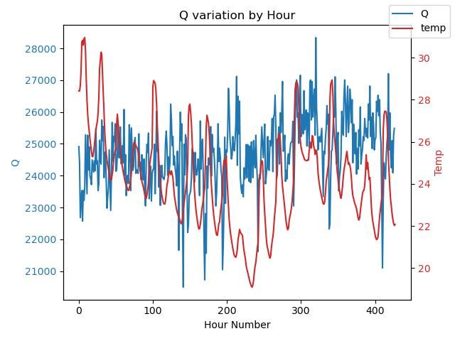

                            I'm still thinking about the philosophical debate! Off the cuff, I say experimental results take us where the evidence leads. It's always necessary to confirm the evidence is valid, because it's always possible that the experiment was faulty. Likewise, conclusions drawn from the evidence also need careful consideration, and it's always possible new evidence might overturn a conclusion.
                            It's entirely possible my ideas are flawed. Martin's comments echo my own concerns, and I don't have a solid rebuff yet, and might never have. His comments, and others, have been extremely helpful. Whilst I would like to end up with a clock that everyone agrees outperforms a Shortt-Synchronome fair-and-square, could be I can't get it to work anything like that well, or, the approach is a step too far – cheating.
                            Meanwhile it's certainly interesting.
                            I said earlier that I'd see if Q varies over time. This graph, which also shows temperature, suggests it does:
                            I think I see a loose correlation between Q and temperature. Might be castles in the flames, but Q seems to fall with temperature after a delay. If the effect is mechanical, it fits with a suggestion made by John Haine, whereby the structure of the pendulum and supports take longer to warm and cool than the sensor. There's been some discussion about what to do about temperature lag, such as Duncan's dummy pendulum. Not proven though: at present the clock is running independently with GPS switched off. This means the Arduino crystal frequency isn't compensated, so the hint of a Q/temperature relationship may be measurement error. That wouldn't explain why Q ranges between 21000 and 28000 though. I suspect something mechanical, perhaps elasticity of the suspension spring changing. Any suggestions?
                            I've just finished a 17 day test run of my experimental pendulum, or rather a power-cut finished it for me, and haven't had time to look at the results. I'll report them later in my own thread.
