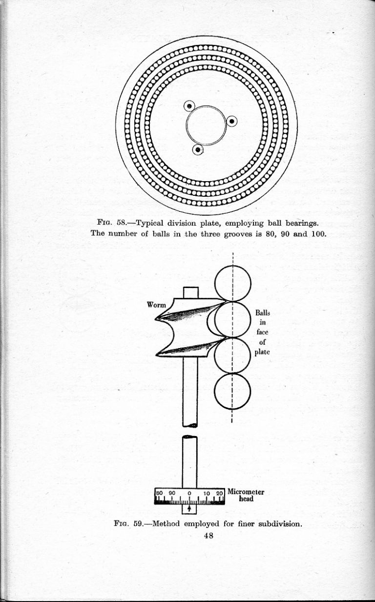

                Ball bearings are held to a pretty tight tolerance so select the number required and machine a circular groove to take them fully crowded,make a detent to pick up each ball. You have just made a very accurate division plate

                  Mike Poole, stack the balls on top of each other and you have got the basis of the Microball height gauge, if you could fit 36 into a groove as you describe you would have a very accurate ten degrees between them.

                      @mikepoole82104
                      It wasn’t my idea sad here is where I read it.img068.jpgimg069.jpgimg070.jpg

                          Nice one Mike.

                                                      I had not seen the ball method of dividing that looks rather interesting! If the balls were set in two precision grooved plates and epoxied in place, they would have to be absolutely level in one plane, you would have the two sides of a hirth type coupling.
                                                      A coupling of this type when used for indexing will tend to average out any errors. Moore recognised this and used it for their highest accuracy tables. It is described in depth in the Book Foundations of mechanical accuracy. One of the great mechanical engineering reads.
