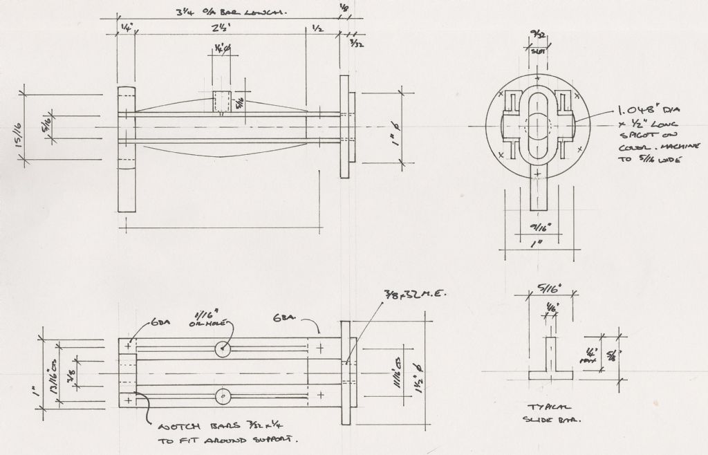

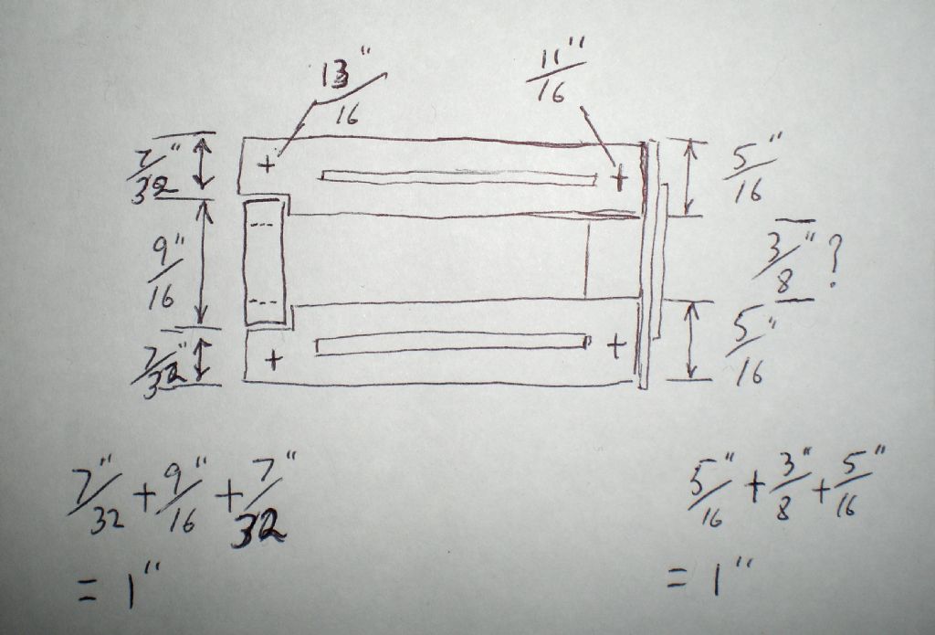

      Hi David & Jason, with regards to the slide bar sketch and the question of the 13/16 and 11/16 centres, I believe are being misinterpreted. My understanding of the cross marks these two measurements are referring to are centres of the fixing holes and not of the bars. I do agree that a 3/8 gap makes more sense, in that it makes the 13/16 measurement to be more realistic.
      Forgive my rubbish sketch below, but this is how I have interpreted it. At the end where it is shown the 13/16 measurement, there has to be at least 3/32 cut out of the edge of each slide bar to accommodate the loop structure and this would leave 7/32 to accommodate the fixings. If the fixings were to be put in the middle of these 7/32 portions, you would end up with 25/32 centers for the fixings. By adding 1/32 to 25/32 you would arrive at 13/16, which would be a more sensible figure to work to and will give a little more clearance between the loop structure and the fixings.
      Slidebar Sketch
      Regards Nick

        Nick thats just about the same as the sketch I did back on page 2 or 3. Great minds think alikesmile
        slidebar revised dwg
        Several of Tony's replys specifically say "bars at 11/16" cts" so its not just teh screw holes nearest the cylinder that are at this spacing. I'm going to show a few of the other parts assembled to the bars and this will show when compared to a photo of the engine that the 1" overall width is the most likely correct, off to work now so will do it tonight.

          I will ask Tony to redo the entire set of drawings.
          No point publishing further episodes until it is sorted.
          In fact, It will be easier to ask how many people are building it.
          If only a few, drop the entire series and offer them a set of the remaining drawings to sort it out themselves.

            Looking at the next part of the portable, it looks like there are many more errors.
            The question is, do I drop the whole series or wait for Tony Webster to correct everything?

                                          There were no further drawings produced. What is is the book is more than was ever in the magazine and parts are different between the book and the mag.
                                          If you do decide to make one then before buying any metal get your boiler inspector to look over the boiler drawings and confirm what he will approve, the book shows two different boiler thicknesses and only one will be right.
                                          There are also numerous other errors or missing details in the book which is just a continuation of the standard that  was in the mag and from this thread it should be obvious that it is full of problems.
