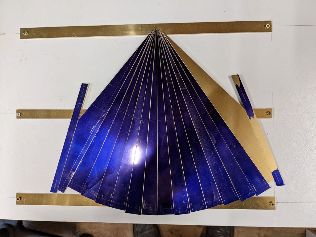

      While I wait for some tools I decided to polish some of the brass work in the Congreve Rolling Ball clock, like the ball plate in the clock, this is 1/16" engraving brass and needs a high polish, I was thinking of using my belt sander with suitable belts so can anyone give me an idea of the type to use and the method?

                  The ball plate is made in individual sections 1/16" thick brass instead of a solid plate as in the picture.
                  My thoughts on the belt sander were that I can mount it upside down in my vice so its easy to use, as i can alter the speed it will also be safer. I can get many different types of belts in many grades including just felt so I don't see any problems using it apart from the price of the belts, around for £40 for ten of each grade. crook

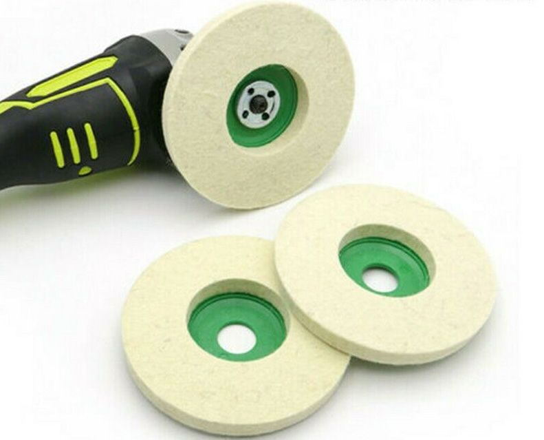

                      Paul Lousick
                        @paullousick59116
                        I use a felt disk on an angle grinder for polishing brass. Grinder held in vice and metal polish as the cutting compound. (ps. don't touch the wheel with your hand unless you want a friction burn)
