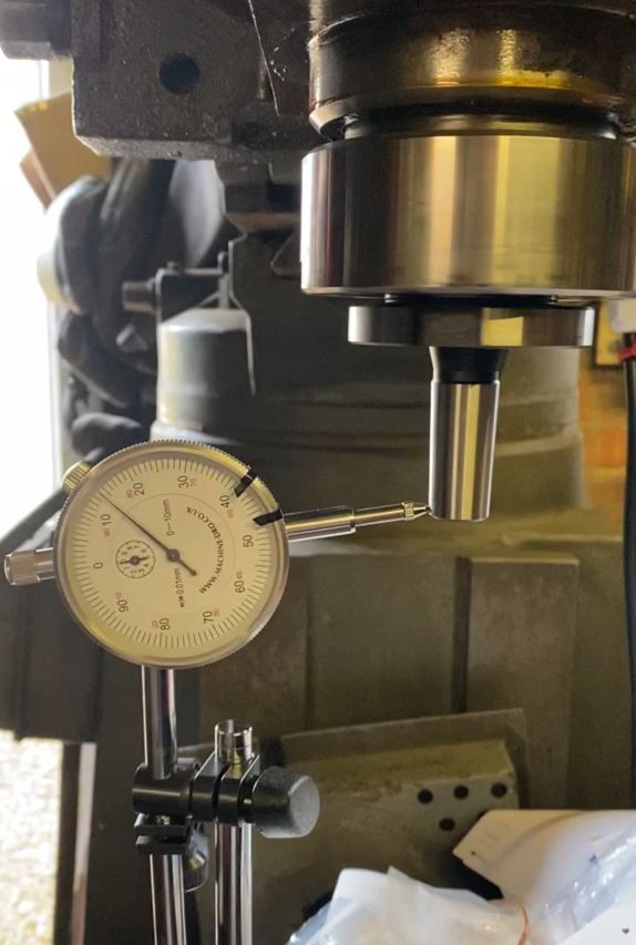

      Hi,
      Have a question, I am new to milling but got myself a 2nd hand mill and just bought a new Arbour and Drill Chuck for it. Before joining the two together I put an indicator dial on outgoing shaft of the arbour while in the mill rotating. The "play" in the shaft was about 1.5mm. I tried to reseat the arbour a couple of times but 1.5mm play was the best of all three times.
      Would you say this is not bad "play" for a £50 arbour ??? or should I return it and ask for another one?

        Diogenes
          @diogenes
          What size and fitting is it?
          ..that sounds rather a lot of money for a drill chuck arbor..?

            Totally unacceptable. Return it and get a refund. 0.15mm would be just about ok.

              I'd say it is a masive error for a £10 arbor let alone a £50.00 one. Should be looking for about 0,015mm or less.
              Have you checked the spindle and/or something else in the taper to see if the 2nd hand machine is the problem?
              How many divisions on your gauge was the needle actully moving, sounds like you may be reading it wrong unles steh needle was making about three ful revolutions.

                      Hi guys – sorry yep its a INT40 in a Beaver Mill. Give me 2mins will try and post a photo of the dial.
                      #660305
                      Antony Harding
                        @antonyharding74298
                        Hi, so hopfully i am readying the dial correct… the movement is from 0 to 15. I take that as 1.5mm.

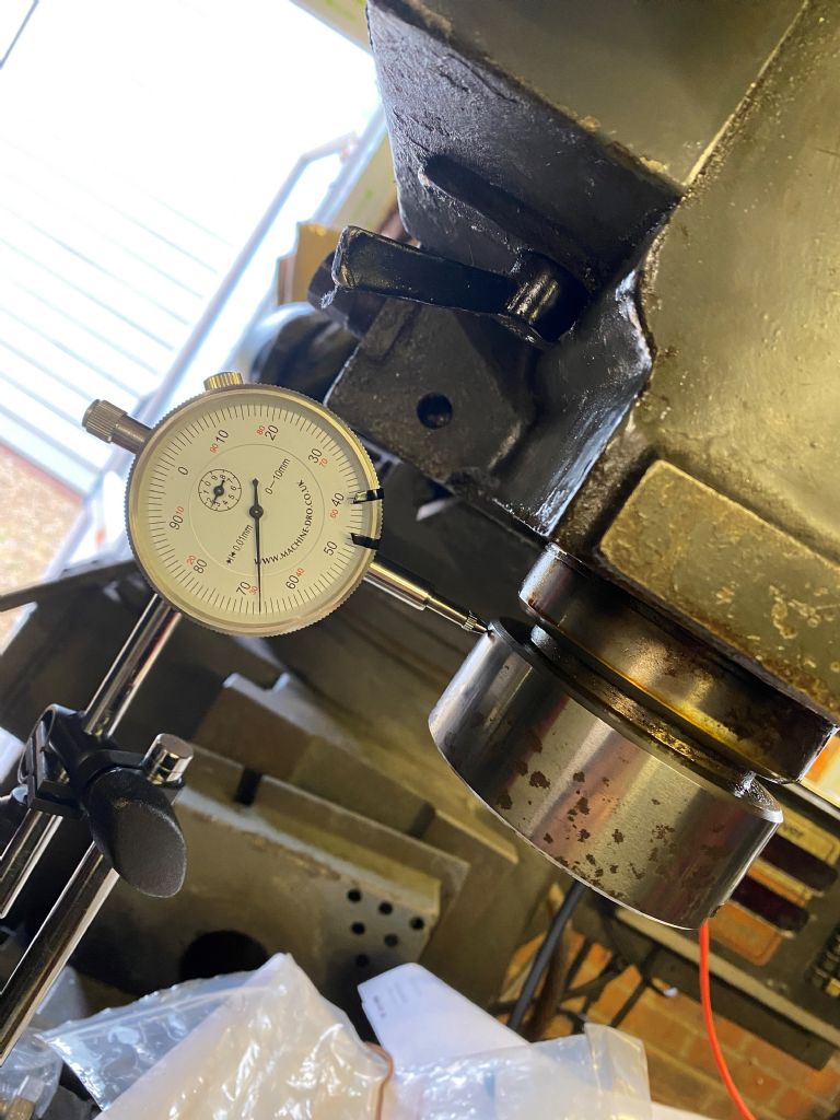

                        Antony Harding
                          @antonyharding74298
                          #660307
                          John Haine
                            @johnhaine32865
                            Each small division round the large scale is 0.01 mm as is printed across the dial. So that's 0.15mm TIR which isn't bad though not wonderful.
                            #660308
                              Yep 0.15mm whch is still not that good,
                              Put the indicator into the spindle taper and see what that reads.

                                I throught as the dial noted 0 – 10mm each "10" was 1mm. I take it I was completely reading this incorrectly.
                                The internal face of the INT40 and the arbour face look fine, I cleaned them and wiped them down with cleaner to get rid of any oils.
                                Would you agree its best to send this back and ask for another arbour ?

                                                Ok thanks for the help and info on my issue… this afternoon I check the following and can report back.
                                                So, when measuring the arbour at speed I got 0.15mm runout under speed, turning the spindle by hand the runout was only 0.09mm.
                                                Following the advice, I removed the arbour and measured the spindle, I couldn’t get to the inside but found a clean section outside. At speed I got a runout of 0.05mm but manual turning the spindle got 0.02mm runout.
                                                Regarding the above difference in readings could this be down to a cheap dial gauge? I have had this for many years now…. Would imagine it was about £15 to £20.
                                                The other observation I note, can feel a very slight movement in the spindle when trying to move it side by side. Not too sure if it’s the motor belt I am moving or play in the spindle. But following the reading taken about is this bad or good?
                                                So……. Note sure where this leaves me…!!!!
                                                Q1 = due to the different measurements I am getting, this could be due to a cheap dial gauge bouncing under speed of the rotating item, or due to play in the spindle.
                                                Q2 = if the runout of the arbour was only 0.09mm, generally would this be acceptable?
                                                Q3 = not looking forward to the answers on this one…!!!! If I have the runout in the spindle what options do I have to solve this? Would this hopefully be just changing out bearings and collars? On a scale of 1 to 5 is this very hard to do ?

                                                  The plunge type are not ideal for measuring small amounts of run out, a lever DTI rather than your dial gauge would be better. Not good to run at too fast a speed but not sure what your lowest is.
                                                  I'd like to see less than 0.09mm
                                                  The spindle bearings may just need some adjustment if you think you can feel movement, I assume they are taper roller type.
                                                  This is almost a bit fast but the problem with turning by hand if there is bearing play is you can be moving the spindle with uneven hand pressure. This is the type of runout you should be looking for, one of those divisions is the same as one of yours so about 0.003mm on the arbor or spindle, drill in the chuck won't be as good

                                                      0.09mm TIR is miles more than you should see in any mill spindle. Don't measure it on the outside, do it on the taper and do it at low speed.
                                                      Have you inspected the taper for embedded debris or burrs on the edge? Try roatating the head so that you can get a good view of it.
