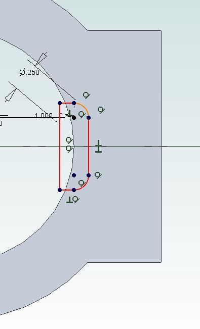

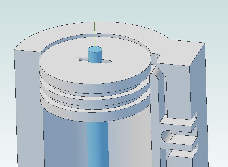

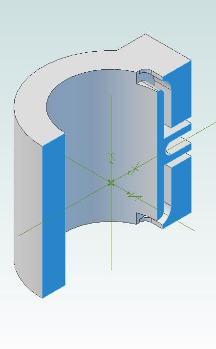

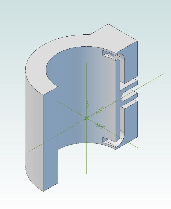

                      Looking at the sectional drawing in teh No1 book they do show the ports covered but that is not ideal. We must have had this crop up before as I have a drawing that I did that shows the extra notch which I mentioned in my first reply which is shown below.
                      As per stuarts
                      Notch cut with a 1/4" cutter to width of cast port
                      Passage now reaches to end of cylinder but still leaves plenty of area for the cover to seal it
                      And how the piston will now leave the modified passage open when at the top and bottom of the stroke

                        that sounds like a scheme , I can do that OK , Then my piston will be OK . Thanks ever so , I was getting worried that had made a disaster , but I couldn't work out where . The must have been hundreds of No 1 s made to presumably they will work with the ports covered at the ends of the stroke , but must be better to be able to exhaust all the steam
