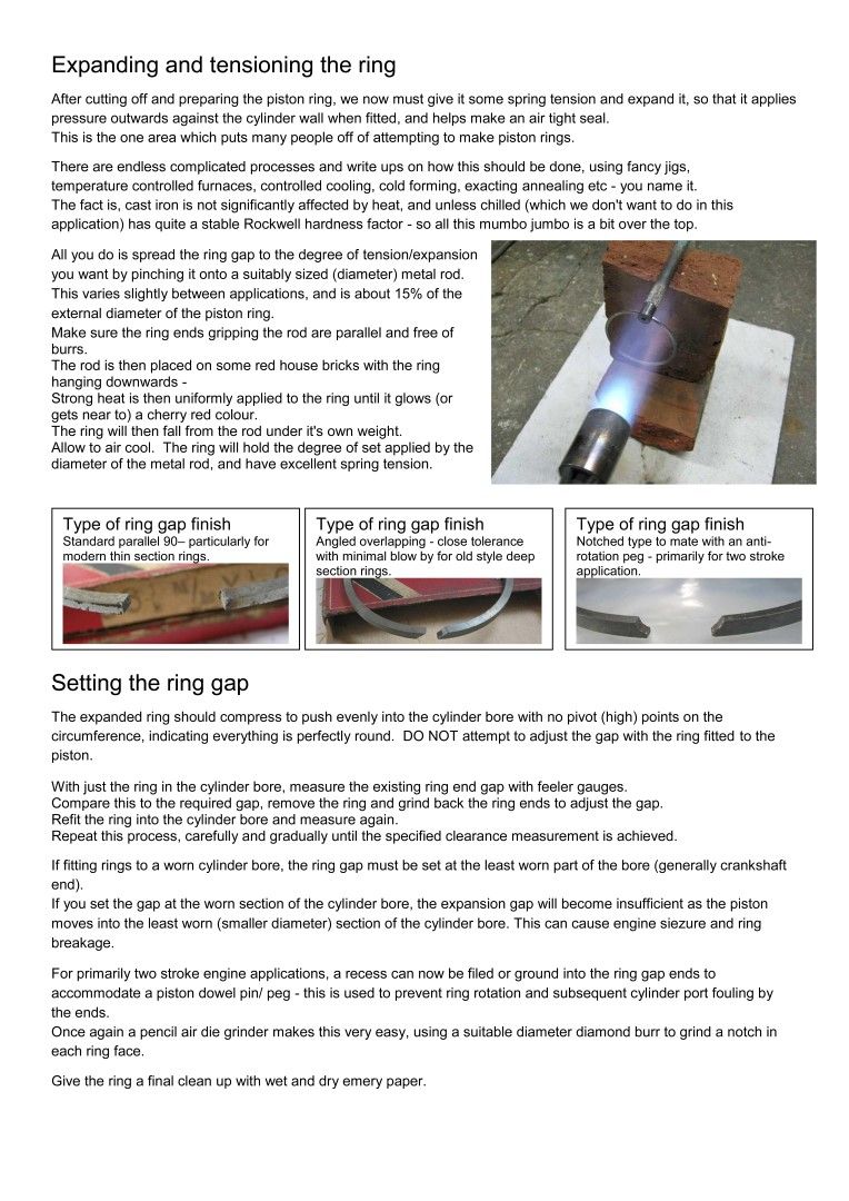

                My cylinder is cast iron and piston aluminium, with cast iron rings. Rings made as a cylinder with a running fit on the bore, then parted off to the length required and split with a thin Dremel blade.  They were then expanded to provide a bit of spring as described below.
                The drawing for the piston on my engine showed 2 rings in separate grooves but I put both rings in the same groove with the gaps spaced 180 degrees apart. The theory being, that the gap will be sealed.
                Paul
