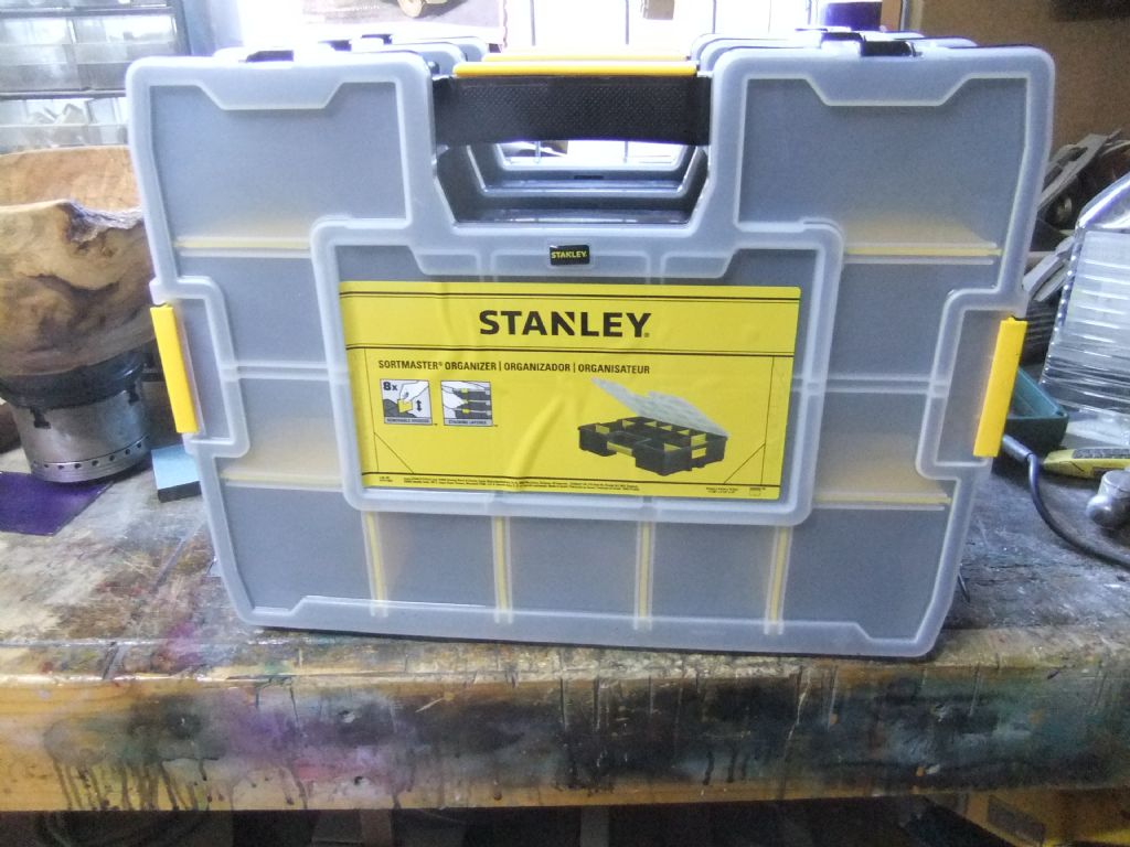

                      Also to help me out for storage I had a £20 voucher for screwfix and brought three of these to keep them in I will be bringing these into the house with the parts in (If they fit). They stack together with clips on the side
                      I will get some inhibitor to coat them with as advised by some of you
                      storage boxes

                                              VCI paper in your Stanley boxes will work well. The box stops damp air circulating over the contents, and the VCI deals protects against any wet that does get in.
                                              Much depends on local circumstances. Leaving the boxes in a cold dry garage is safer than walking them through a hot steamy kitchen. But warm and dry is better than cold and damp.
