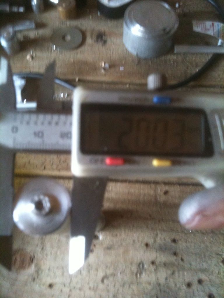

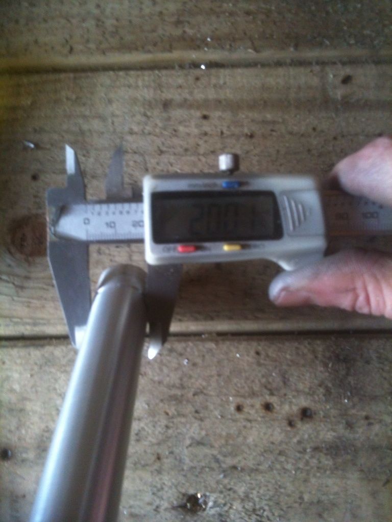

      Hi , last week I needed to turn a shaft out of a length of 6082 aluminium 200mm long . I held 40 mm in my Pratt & Bernard 3 jaw chuck and had 200mm sticking out o the chuck supported by a revolving centre ,I proceeded to turn the bar and had a run out of 0.5mm ,not good.
      I did a lot of reading up on here and on the Internet and decided too see if I could get the lathe too turn as parallel as possible ,bearing in mind my lathe is a Myford ML4 so it's approx 70yr old .
      All my jib strips are tight and there's no play in the bed and the bed looks in good condition ,I then decided too hold the bar in my 4jaw chuck again a P&B chuck as I thought the 3 jaw may not be as accurate as the 4jaw and I haven't got a centre for the headstock.
      I used a dti to true up the bar and also checked the run out at the tailstok end which is supported by the revolving centre ,I manage too find a happy medium between the two.
      I then proceeded too turn my bar and I still had a run out of 0.5mm ,I decided to place the dti on the tail stock end and adjust the tail stock as I felt my tail stock was a long way out ,after many adjustments I got my desired results ,I now had a run out of 0.05mm checked with my micrometer not bad for an ml4smiley
      Pics of the bar measured with my vernia

          What does it turn like between centres? thats how you normally set up a machine.

              Thanks for the replies , @ Paul, I don't have a centre for the head stock ,so I can't answer that question , but overal Im pleased with the results .
              #107994
              martin perman 1
                @martinperman1
                Kevin,
                Place a piece of bar in your chuck and turn a 60 deg taper to a point, this will be your centre at the chuck end.
                Martin P

                  You dont need a centre for the headstock, just turn a 60 degree cone on a bit of scrap bar held in the chuck.

                    Thanks , I don't know why I didn't think of doing that in the first place enlightened

                          Hello Kevin,
                          I inherited my late father's ML4 in 1963, it was aleady about 20years old then and I ran it for a further 20 years before selling it on to buy a friend's ML7.
                          I suspect you have the model with the plain non-adjusting tailstock, a real pain to set up both in terms of alignment across the bed and true aim along the bed. With the single foot mounting for the whole machine, leaving the tailstock end of the bed as a cantilever, the advise above from David Littlewood about bed twist and correction doesn't apply.
                          A relatively quick way of setting things true to at least a reasonable approximation, and assuming you can trust your 3 jaw chuck, is to do as follows:
                          Slacken the tailstock foot adjusting screws and mounting bolts along with the bed clamp on the rear of the tailsock. Wind out the barrel to about 3/4 reach, clamp it with the barrel clamp and then grip the front end in the chuck. Now that at least is aligned with the headstock centre-line and with it the tailstock body.
                          Now you can reset the tailstock front shear dovetail and carefully tighten the bolts on the tailstock holding the dovetail piece to the tailstock, checking with your DTI that you are not moving the tailstock body as well; this may take a while.
                          When you are happy with that and the bolts are tight, test again as you tighten the bed clamp for the tailstock, it should not deflect more than a few thou if you have got the previous operations right.

                                  An ML4 bed will twist in just the same way as a Myford 7 series lathe if secured to an uneven surface and so the same precautions should be adhered to for both types of machine.
                                  As has been stated numerous times before: Level the bed with a engineer's level to ensure all twist is eliminated, then take a test cut on a substantial piece of free machining metal bar, using a sharp tool.
                                  If the bar is unacceptably out of parallel, then you need to look for the root cause, such as headstock misalignment or wear etc. If the bar is out of parallel by a thou' or two, then you could tweak the mounting bolts by shimming or other adjustment until you're happy.
                                  The first rule though is to ensure there is no twist in the bed – particularly with a fixed tailstock machine.

                                    Thanks for all the replies intersting reading , I checked the bed with an engineers level before I adjusted the tail stock and shimmed accordingly , my ml4 must be a late model as I can adjust the tail stock by loosening two nuts and then I can adjust using the 2 small screws on the side of the tailstock ,kind of like a jib strip , I'm fairly happy with the results 0.05 mm over 200mm is quiet good for a machine of this age , at the tail stock end of the bed I have d1992 stamped ? Any info ?
