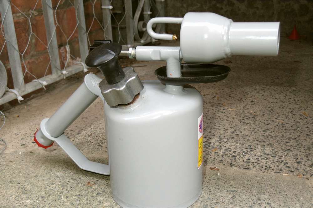

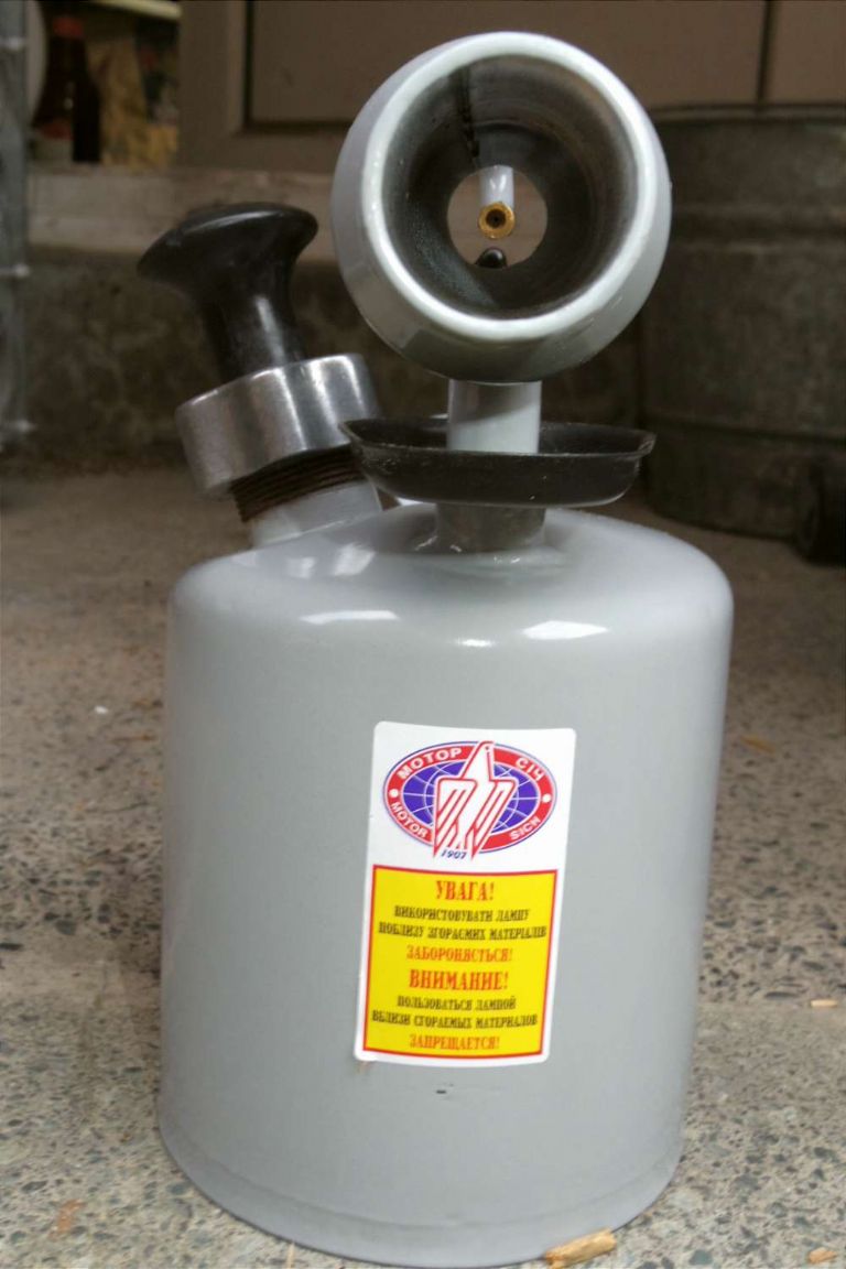

                                            I still use blowlamps for some jobs. Gas torches are very convenient for most soldering and brazing tasks but for boilermaking the soft bushy flame of a blowlamp is wonderful for getting heat into the copper.
                                            I use modern blowlamps rather than antiques. Yes, they are still made because butane and propane gas are not readily available in all parts of the world.
                                            The blowlamps I use are made by Motor Sich. They are made from steel and while they are primarily designed to use gasoline, by changing the jet size kerosene can be used as an alternative fuel.
                                            The very comprehensive instructions include not only how to use the lamp but also maintenance, troubleshooting, and complete testing procedures. Helpfully, they are bilingual being written in both Ukrainian and Russian. thumbs up
