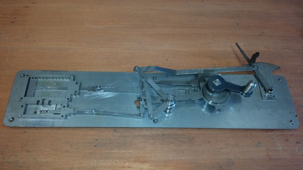

                                  #431715
                                  Bruno Taylor
                                    @brunotaylor21701
                                    Hi All
                                    Many thanks to Julian who sent me the dimensions for his modified valve gear. I have created a physical model with the assistance of Model Engineers Laser who cut the parts. I have made provision to adjust the lateral position of the rocker pivot.
                                    First trials are promising and l will see what cut-off l get. It also demonstrates where the "slop" is so extra special care in machining. If you look closely you can see the cylinder bore is notched at each 10% of travel.
                                    Regards
                                    Bruno

                                      That's a good idea Bruno, I would happily run an article on that in MEW, but ME might be the right place for it, I suggest you send a note about it to Martin or Diane.
