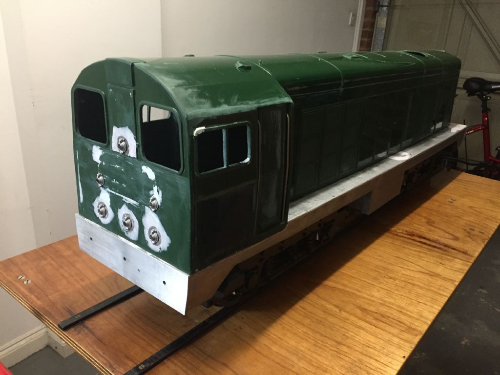

      A short while after lockdown started some 2 years ago my wife suggested to me that I make a start on the Class 20 electric loco which I had bought the castings etc from Dan Jeavons some 15 years before!
      I'm now at the stage of painting before installing (with help I may add) the control system purchased from Mtroniks. Both bogies have been painted using Plastikote Metal Primer and Satin Black which I find is one of the few rattle can paints where runs are few and the coverage is good. The chassis is an aluminium casting which I sprayed with Upol Acid 8 Primer followed by the Satin Black.
      Now, I need to spray the buffer beam and buffer stocks red but although there is a model railway forum detailing car rattle can colours it doesn't seem to list a car colour for buffer beam red. Similarly, my loco will be an early example where the body is BR Green with the roof being grey so are there any suggestions for a car colour for this?
      The model railway forum lists either Rover Brooklands Green or Ford Laurel Green for the body but with it being a gloss green fibre glass moulding I can't seem to find any advice on what primer to use.
      Any advice or recommendations would be most welcome.

                The moulding is a sort of self coloured BR Green but I've done quite a bit of work on both the nose and cab ends as I want it to be an early example of a Class 20. As standard the moulding had a headcode box but Dan had my moulding made without this and I've added to it. It is shiny so I can go over it with 1000 grit to take the shine off of it, like I've done on the ends I've worked on. I have tried to insert photos of both ends but met with no success apart from losing all that I had already typedsad. I might have another try after I've posted this. smiley

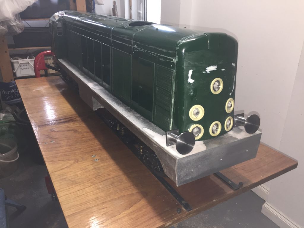

                  Well, I've managed to upload these photos – I hope. Progress has moved on quite a bit since I took these.
                  BTW for those of you who may have built a Class 20 the reason for the new buffers stocks is that being a member of the GL5 Main Line Association after making the 2 bogies and assembling these to the chassis I found the centreline of the buffers was about 3/8" too high. After much head scratching and looking at full size pictures of Class 20's the penny dropped that the buffer stocks on the aluminium chassis casting were cast in the middle of the buffer beam where on the protype there is a marked bias of them being towards the bottom of the beam. Mystery solved but involved cutting off the cast in stocks and making new ones.
