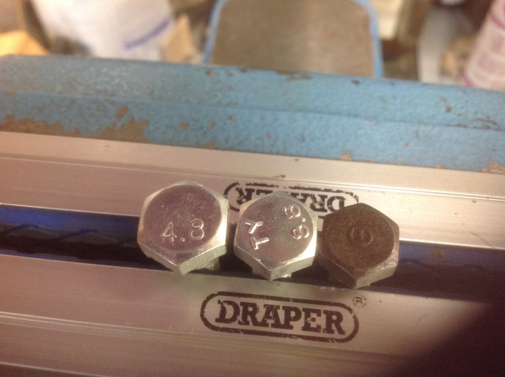

                                            14mm AF for an M8 nut is quite commonly met with. An M8 58 piece clamp kit I've got has 14mm AF flange nuts. You'll also find 12mm AF for M8. I've got some 12mm AF M6* nuts [from a toilet seat fastening kit], M10 nuts with both 16mm and 17mm AF, and M12s with 18mm, 19mm and 22mm.
                                            See my photo below, showing commercially made 12, 13, and 14mm AF M8 hex head set screws.
                                            I made some 11mm AF M8 nuts a while ago for use in confined spaces on an angle plate. I think having a variety of AF sizes is good.
                                            *Correction: the M6 toilet seat nuts are 13mm AF!
