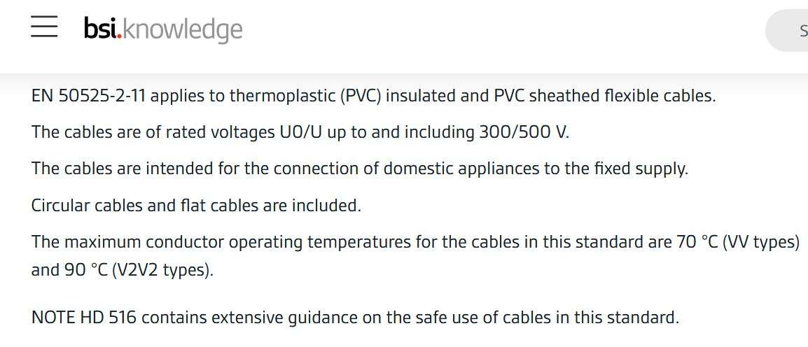

            On Robert Atkinson 2 Said:
            2/ There is no indication the Vic’a switched outlet has an integral 13A socket.
            4/ The physical current rating of a cable is directly proportional to both the amount of copper and the temperature resistance of it’s insulation. The APPROVED rating depends on the environment it is installed in (ambient temperature, number of cables, thermal insulation etc AND local regulations. A physically identical cable may have different approved rating depending on country and installation.
            5/ Vic’s 1.5mm2 cable is OK for his 3.4kW / 16A load because the insulation is rated to a higher temperature and is in free air. The same applies to the 1mm kettle cable being OK for 3kW
            6/ The MCB is there to protect the wiring. Ideally it shoud be a 16A “B” type to protect the flexible section but in realtity the probability of a fault of the narrow overload range that would trip a 16A MCB but not a 20A before the cable caught fire is small. Not impossible with an oven though. A short scicit between adjacent turns of a spiral wound element is not unknown.
            Robert
            Seems you missed Vic’s message #742216 in which he states a combined unit with a 13A outlet describes a CCU (cooker control unit), no doubt the reason why the electrician used a 20A mcb rather than a 16A.
            The cable is in a void, possibly not ventilated, at the back of the oven. The oven insulation will not prevent all heating of the air within the void so the cable may well be working way above it’s rated temperature of 70deg C (pvc outer/pvc conductor insulation) see the NEFF connector data.
            The Crabtree unit should last a good few years without issues.

              We don’t know the teperature rating of the cable. The H05VV-F 3G1.5 part of the number is the same as a common cable code but does not specify a temperature. This cable is 70 deg C https://assets-cdn.helukabel.com/suppliers/Helukabel/documents/db/HELUKABEL_M29450_EN_GB.pdf
              But this with same code is 80 deg C https://procab.be/be-en/products/d/pc3g15—power-cable—h05vv-f-3g1-5—3-x-1-5-mm2—16-awg
              Both say they are suitable for ovens. We can only assume thet NEFF have used a suitable cable.

                  en50525-2-11 pvc operating temp

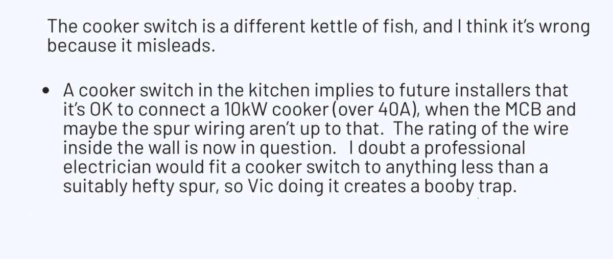

                        On Vic Said:
                        This is the switch type I have.
                        IMG_1481
                        Ahh, that is not what you have shown the back of previously. All those where square for a start. e.g #742058
                        Don’t use a kettle in the socket when the oven is on or you may get a trip.
                        Robert.
                        This is a game changer!   Now I don’t know what Vic is up to.
                        The damaged square unit shown in #742058 is a plain junction box, suitable for a 15A oven protected by a 20A MCB.
                        The cooker switch is a different kettle of fish, and I think it’s wrong because it misleads.
                        • A cooker switch in the kitchen implies to future installers that it’s OK to connect a 10kW cooker (over 40A), when the MCB and maybe the spur wiring aren’t up to that.  The rating of the wire inside the wall is now in question.   I doubt a professional electrician would fit a cooker switch to anything less than a suitably hefty spur, so Vic doing it creates a booby trap.
                        • Running the 15A oven and using the 13A socket at the same time exceeds the 20A MCB.   Not dangerous, but why bother?
                        Swapping the burnt junction box for another junction box is a repair.   Substituting a cooker switch for a junction box is a design change, requiring a re-think.   My amateur gut says don’t do it:  what do trained electricians advise?
