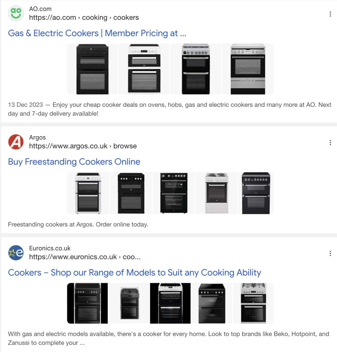

                    Thank you. As in the title of my original post, it’s just an oven. If it was a double oven or combined oven and hob (commonly called a cooker) I would have put it in the thread title.
                    Edit: As expected, when I put the word Cooker into Google it displays nothing but cookers. No pictures of an oven on its own at all.

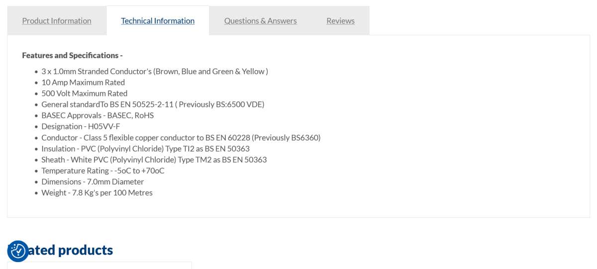

                      Hi Duncan, are you sure it’s 1.0mmsq cable and 3kW element ?
                      Emgee
                      Screenshot 2024-07-21 at 10-01-10 1.0mm 3183Y 3 Core White Circular PVC Flexible Cable -100 Metre Coil - Edwardes

                        The plate on the kettle says 3 kW, and 1 sqmm is moulded into the cable. I must admit I was surprised.

                            The 10A rating for Emgee’s cable will be for the nominal length of 100M which will have a much greater volt drop that 1/2M of kettle cable.
                            Hi Duncan
                            That is the quoted maximum current for any length of the quoted type of cable, it’s the Volt drop that will be affected by cable length and is quoted as mv/amp/metre

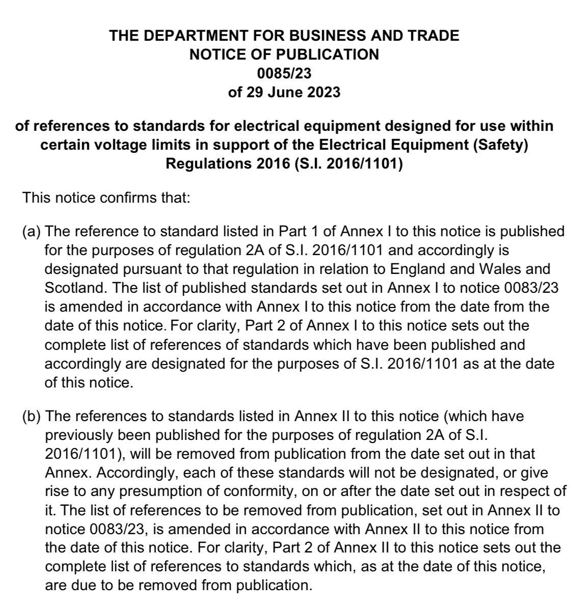

                              This must be my ‘find of the day’ … a 65 page list of applicable standards:
                              https://assets.publishing.service.gov.uk/media/649bf3c1f90109000c818938/ds-0085-23-low-voltage-equipment-notice.pdf
