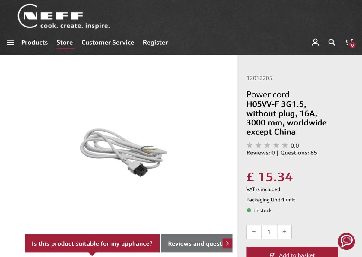

                            Dave Halford
                              @davehalford22513
                              As it’s a NEFF he conductor sqmm will be moulded into the sheath along with the spec that the cable conforms to.
                              The fact that the part# includes 1.5 may point to the sqmm
                              Oven cable is designed to run at higher temps that plain PVC twin and earth that bleeds fluid @ over 60C.

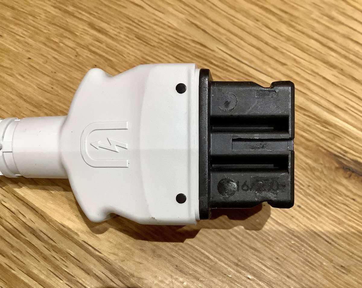

                                Vic
                                  @vic
                                  This is the oven plug on the NEFF supplied cable. It is marked 16/250 which I strongly suspect is the cable rating?

                                                    #742344
                                                    Emgee
                                                      @emgee
                                                      Vic, the 16/250 is the maxilmum rating of the connector and has no bearing on the cable size.
