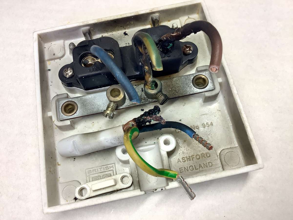

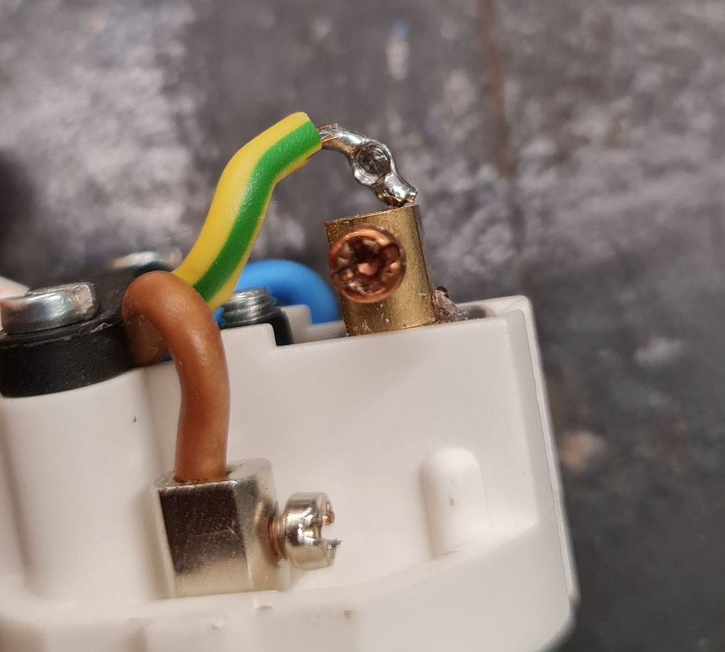

      Our oven went bang the other day and I found this:
      IMG_1300
      The oven was installed by an electrician. I’ve fitted a new oven outlet and trimmed off the damaged wires as you can see. I’ve doubled the ends of the flex over for now to get the oven working but I guess I need these? I ask as they didn’t seem to do much good the first time round? The oven was installed about 4 years ago. Bit of a blow to spend over £20 for three ferrules but needs must I suppose. Unless anyone knows of a cheaper alternative? TIA.
      IMG_1301
      IMG_1302

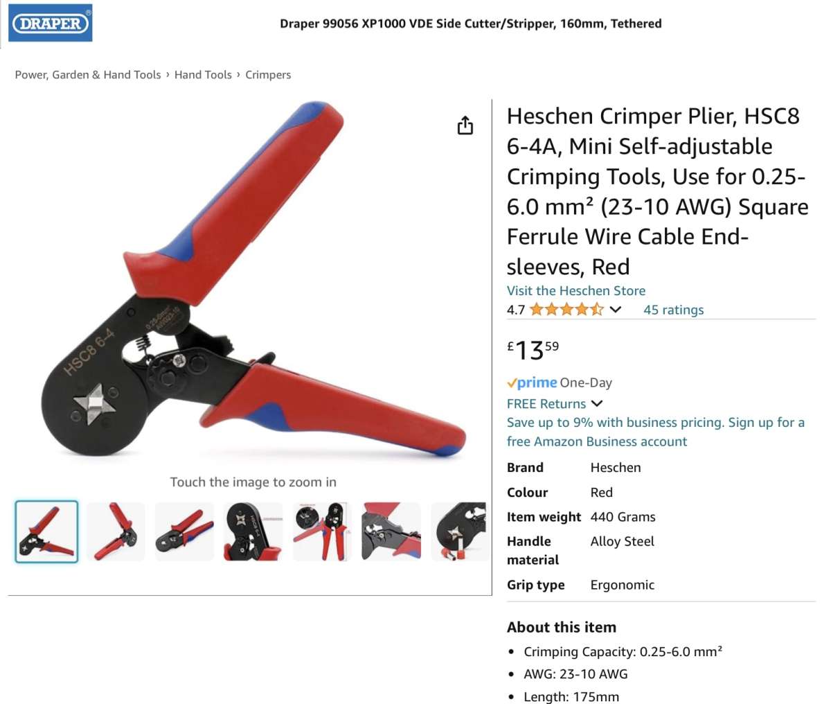

        Turn and drill holes to make 3 tubes and crimp them onto the ends of your wires.
        #741990
        John Doe 2
          @johndoe2
          If you live anywhere near Hereford, I have a ferrule kit and crimper and would be happy to help.

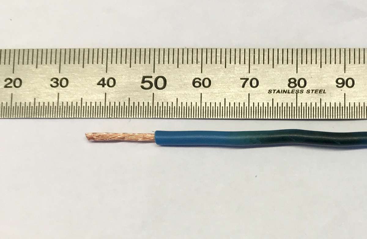

                This is a piece of the cable for size. Conductor is around 1.45 and outer diameter 2.82 so I’m guessing it’s 1.5mm.

                  Seems small cable conductors for an oven….maybe I have misunderstood.
                  Is it an all electric oven or a gas oven?
                  #742032
                  Robert Atkinson 2
                    @robertatkinson2
                    What power rating is the oven? Is there a electric hob? Unless it is a small single oven the supply wiring looks too small.
                    That said the original fault looks like the terminal with the live conductor of flex was not tightened properly. The ferrule may not have helped. They are not essential. The conductors twisted and then folded over on itself should be enough and better than a ferrule that is too small for the terminal.

                      @davidgeorge1
                      Amazon £15.00
                      Ferrule Crimping Tool Kit, Hibisaws 0.25-10mm² Self-Adjustable Ratchet Bootlace Crimper Plier Set with 1250 Wire End Ferrule Connectors, Ideal for DIY Electrical Repair and Cable Crimping
                      Brand: Hibisaws

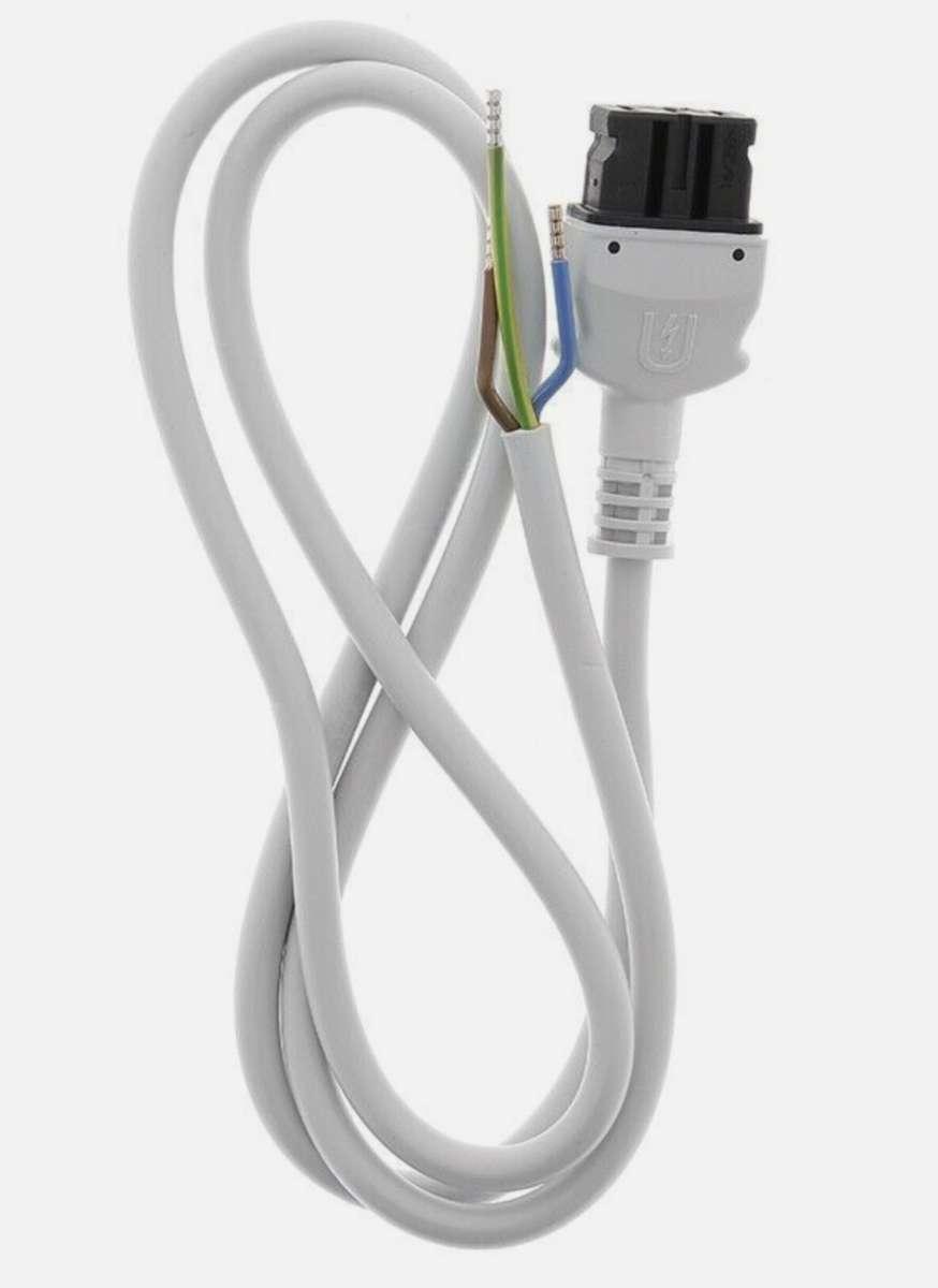

                        It’s a NEFF fan assisted single oven. I believe it’s 16A and fitted with the original cable that came with the oven. Yes, it does seem rather small but the cable supplied by NEFF seems to have a proprietary plug on the back of the oven so nothing I can do about it. The cable looks like this:

                          Vic
                          Count the number of strands in the conductor and measure the diameter of 3 to give an average diameter, the number of strands and the diameter of each strand can be used to determine the csa.
                          What size fuse or mcb protects the circuit ?

                            I never use ferrules. Instead I add normal lead solder to the wire. I like this because the alloy is soft and the screw makes it flat increasing the contact area. So a soldering iron could also be an option.

                              16A single oven, Gas Hob. The cooker socket the electrician fitted had separate holes for the supply and oven cables, you can see these in my first photo. The replacement I bought made by MK just has one hole for live, neutral and earth for both supply (twin & earth) and the ovens flex. The holes are rather large. I have indeed stripped off extra insulation, twisted the conductor and folded it back on itself. I’ve done this in the past for thin cables and plug tops.

                                There are 32 strands in the cable, each one is .22mm.

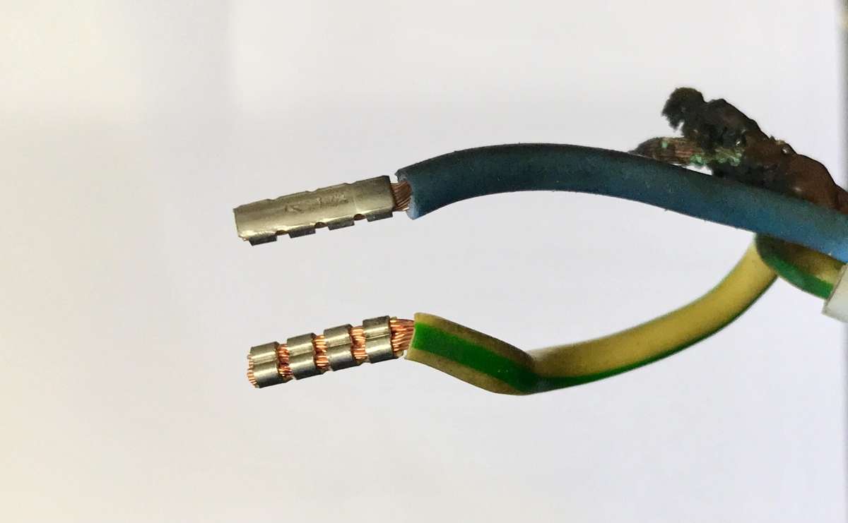

                                I have, on many occasions tinned thin cables for use in plug tops to get a better grip. I’ve even doubled them over and tinned a couple of times. I wasn’t sure tinning was appropriate in this situation though. This is the breaker, 20A.
                                IMG_1314
                                  Bad practice!
                                  Over time the solder creeps and the original tightening pressure reduces leading to a high resistance joint.
                                  Many years ago I used to do the same as in your picture but stopped after a ‘nearly a fire’ event.

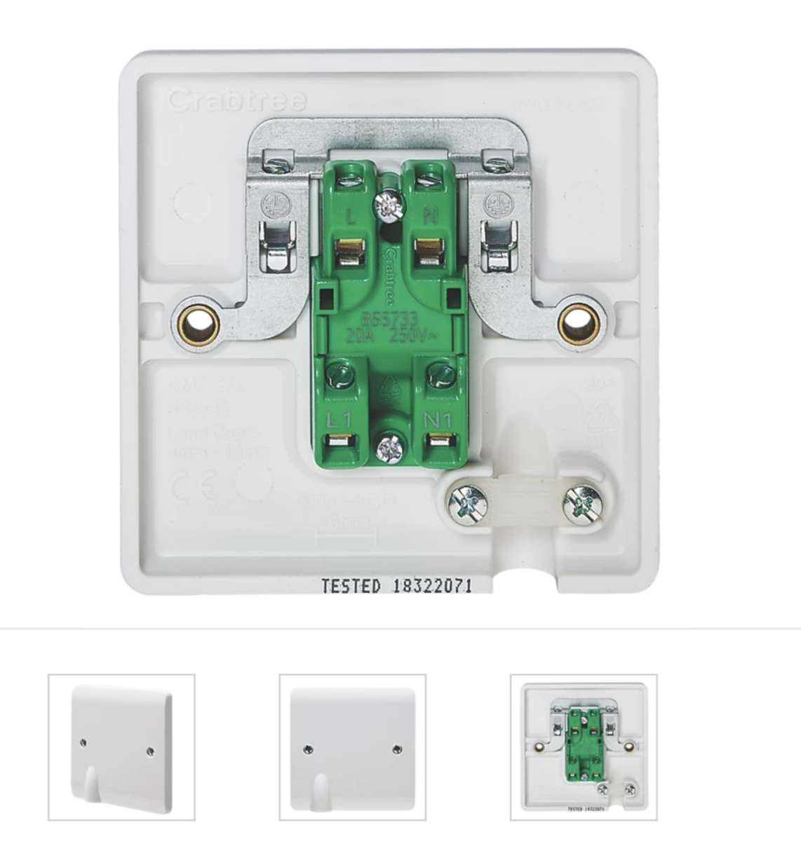

                                      I incorrectly assumed the Electrician supplied and fitted a cooker outlet. The BG branded unit he used though is a 20A flex outlet. This seems better suited to both the T&E supply cables and the flex to the oven than the cooker outlet I’ve used. I’m now thinking to get one of these instead. The oven is 16A and both of these are rated at 20A. As the cabling failed in the BG unit I’m inclined to go for the MK this time!
                                      IMG_1317IMG_1315
                                      #742058
                                      Vic
                                        @vic
                                        Then again, I’ve always liked Crabtree stuff and this looks good.
                                        IMG_1318
                                        #742065
                                        Vic
                                          @vic
                                          I’ve ordered the Crabtree one from Screwfix, click and collect. I’ll use this and just double the wires over if needed. Thanks for all the suggestions. And yes, I’ll make sure the terminal screws are nice and tight!
                                            Bad practice!
                                            Ian P
                                            I’ve seen this happen several times, not to be recommended.

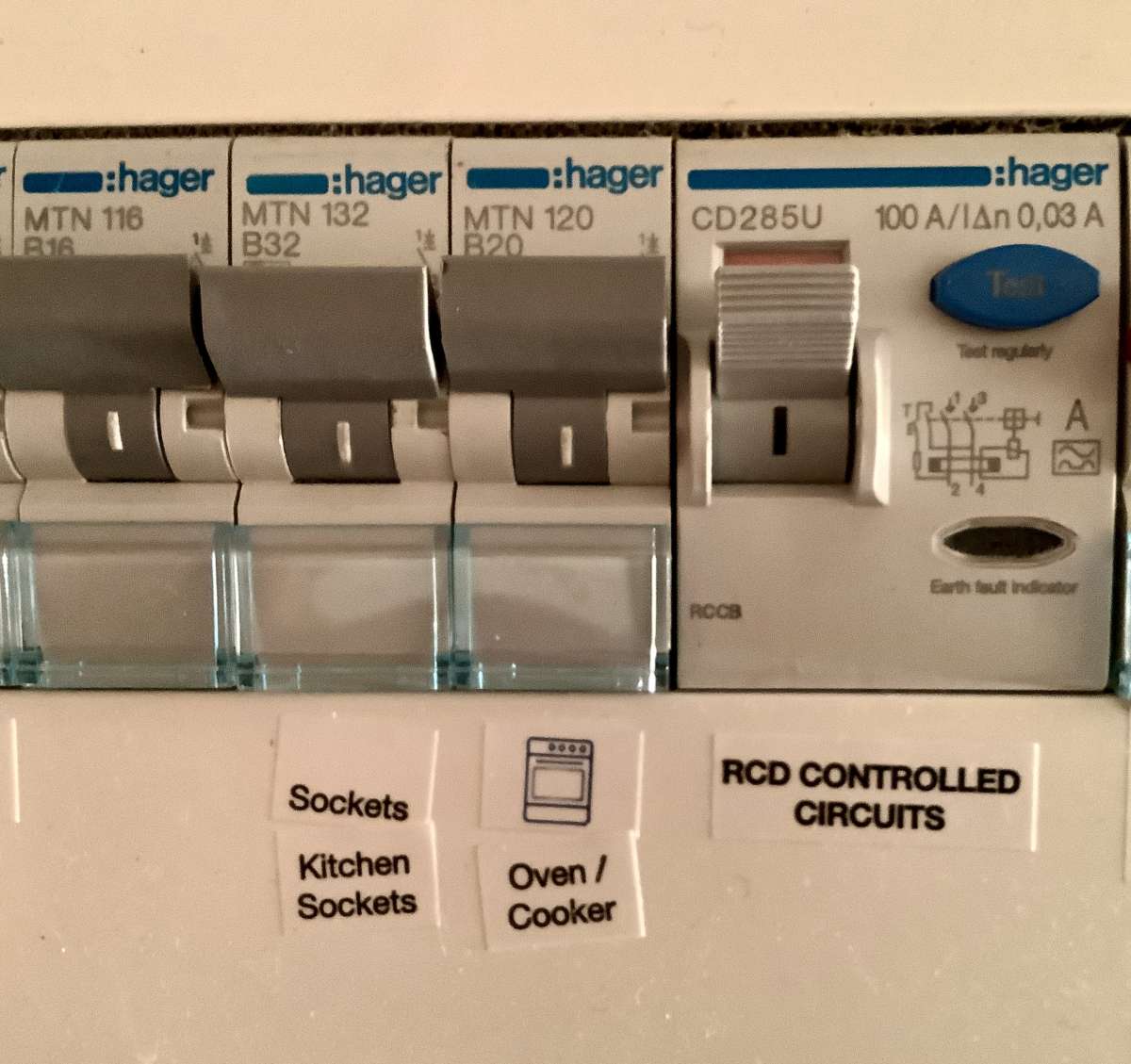

                                                      Couple of things going on here, putting Vic into the shadow line where a proper electrician is needed.
                                                      A 16A oven exceeds the 13A plug and socket limit, requiring a separate wall-plate etc.  Given the first electrician might have been a bodger, Is the connection from the wall-plate back to the consumer fit for purpose?   Unlike the short cable to the oven, where the wires can safely be on the thin size, a cable buried inside a wall is insulated and may overheat.    Mild overheating won’t instantly burn the house down, but the insulation slowly hardens over time, risking a short?
                                                      Root cause I suspect is the electrician failed to properly tighten the terminal screws.   None of the ferrules show any sign of the crushing caused by a tight screw.   Contact was good enough to pass the electrical tests, but the live started to spark later, perhaps after summer/winter temperature changes stressed the wires slightly.   Typical human error: even a trained person who normally does a good job will blunder if distracted or rushed.
                                                      Another vote against tinning multi-stranded wire.   Although once considered a good way of keeping the strands together, several problems emerged later, bad enough to avoid doing it today!
