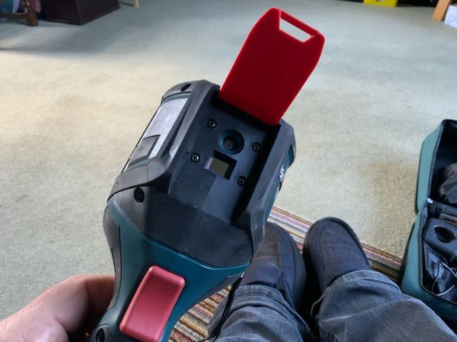

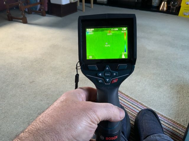

                Whilst converting a digital camera or indeed using a film camera and IR sensitive film will get you IR images they are nothing like what you get from a camera like the one in the video..just like this
                This is my heat seeking camera (for want of a better description)
                I use this a fair amount in my day job looking in electrical cabinets circuit boards and motors and pumps and bearings on large machinery
                this ones about £900 or so as you can see it has 2 cameras one for visible and one for ir which are overlaid to make the heat image
