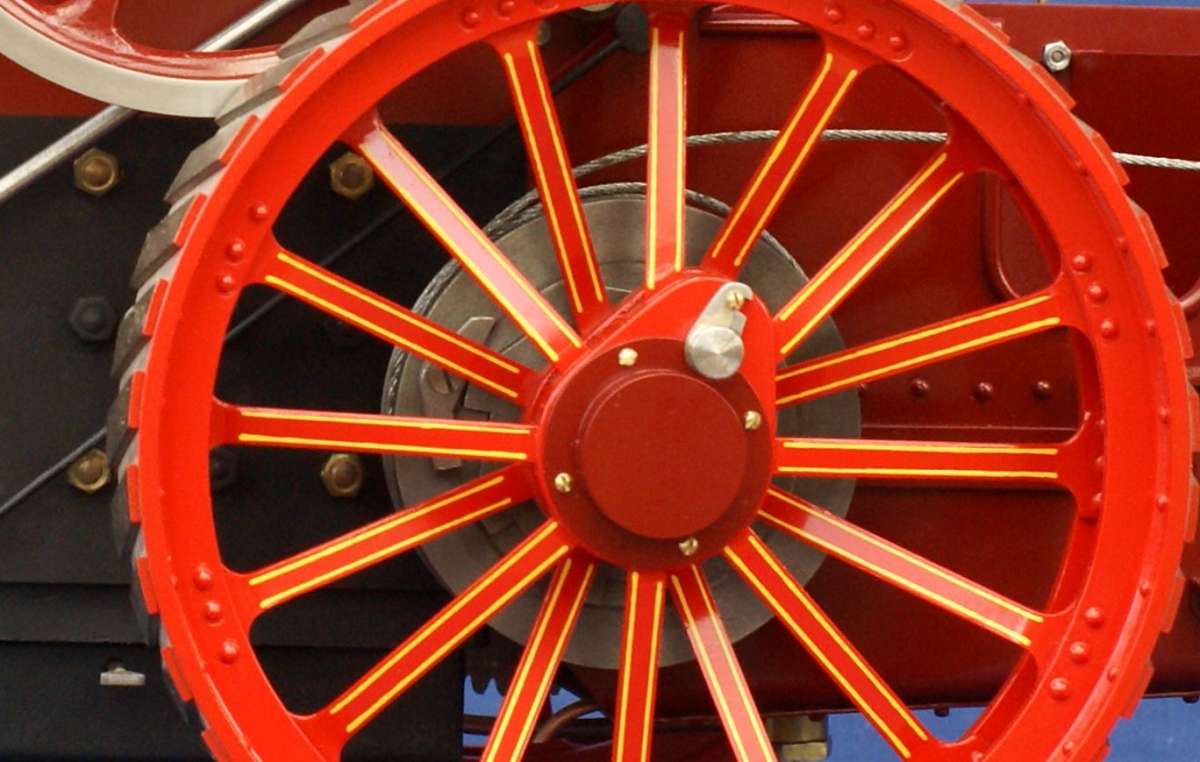

      New hobby forme and have a build query
      Would appreciate asking advice from a member who has built one

          Do not understand about winding drum, as keyed to axle, so does it just go round and round when engine is being driven
          Also does the pawl plate go the tender side of it as not sure how this works in practice.
          #711128
            The drum is free to rotate on the drive centre so wheel can go round but not the drum. It is the drive centre that is keyed to the axle
            To use the drum the pins are pulled out of the wheel lobes so that just the axle and drive centre can rotate, the cable can free spool out when the pawl is not engaged, when it is engaged the drive centre’s teeth will then allow the drum to turn with the axle/ctr and wind in the cable.
            Pawl goes towards the wheel so it engages with the teeth on the drive ctr

              Thanks – big help.
