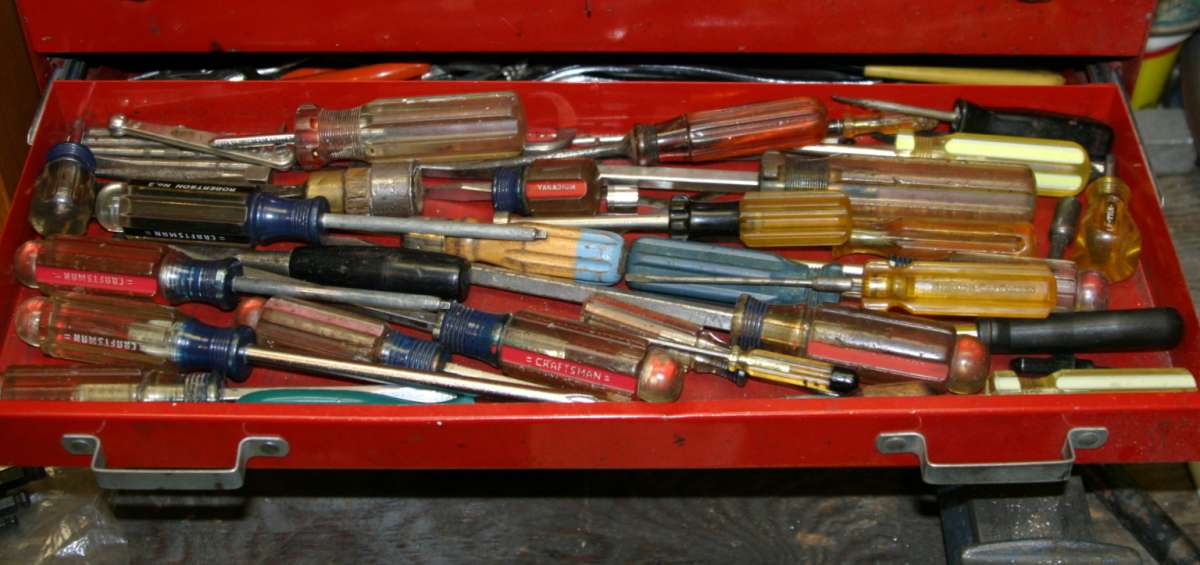

                      That’s interesting. I have a whole drawer full of screwdrivers, most of which are 50 or so years old (and a few of my grandads’ that are at least 80 years old ) and I have never run across this phenomenon. The small 1/8″ yellow one with a black top just right of centre at the front is a cheap Fuller brand and is at least 75 years old and is as good as new except for some dings from years of use. The only thing I have noticed is that if one hasn’t been used for quite a while sometimes there might be some slight mildew on the handle, which I have always put down to our hot humid summer months.
                      screwdrivers
