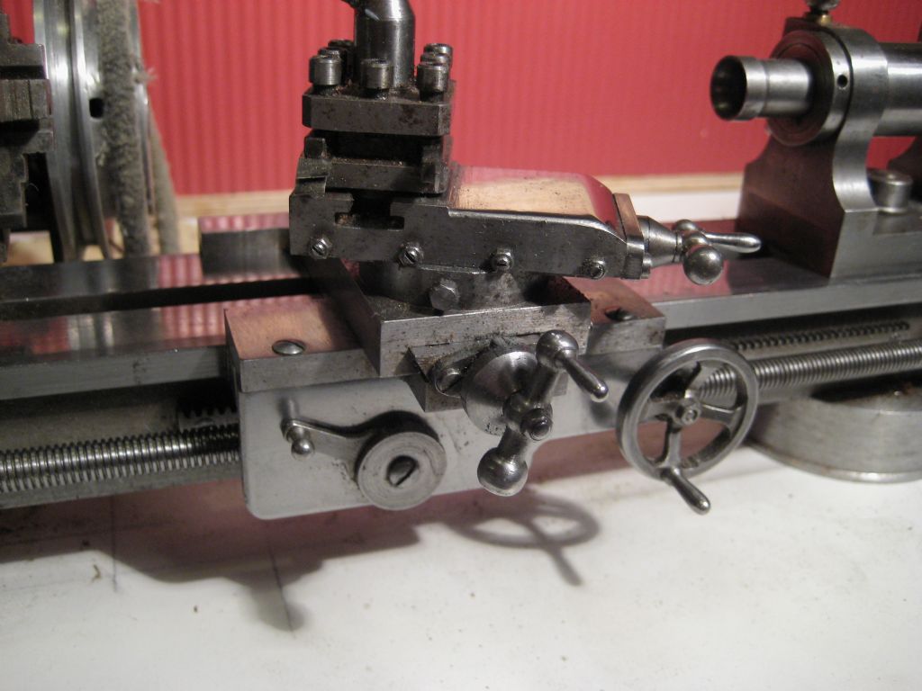

      Hello everyone;

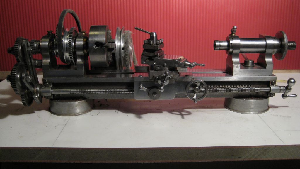

      I posted a few years ago asking for advice on a small watchmaker lathe I bought, my skill is hammering metal by hand but enjoy making small parts for vintage turntables and tonearms.
      In essence, I know little about precision measuring and complex lathe work.
      Moved to a small flat, a hovel, and the electrics are far from perfect. The lathe knocked the internet router off every time I switched on or off, so I plugged it in on a different circuit and all was well for a couple of hours.
      The motor has suddenly started stuttering, it sounds as if it's about to start then slows down and starts again. This goes on cyclically but never spins properly.
      It's a 220v 0.7 amps 1/15 HP motor, with a condenser.
      I could really do with some advice and would be grateful for all suggestions.

          My first thought would be has the capacitor failed or dropped it's value ? A good multimeter may have a capacitance scale. Noel.

            Agree with Noel you need a new capacitor, if it has the value marked get the same voltage and uf value, usually a motor rated 350v ac 5uf will run those fractional HP motors.
            You may want to check the switch is passing volyage/current before buying the capacitor.

              Thank you. There is no external capacitor, so I am assuming it has an internal one?

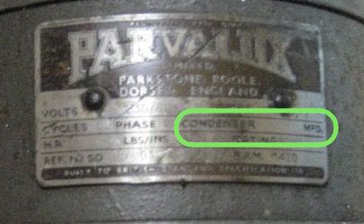

                  Posted by Victor francis on 27/09/2023 19:35:03:
                  Forgive me please, Victor … I am a little confused
                  You originally stated : “It's a 220v 0.7 amps 1/15 HP motor, with a condenser.”
                  capacitor = condenser
                  Edited By Michael Gilligan on 27/09/2023 20:26:43

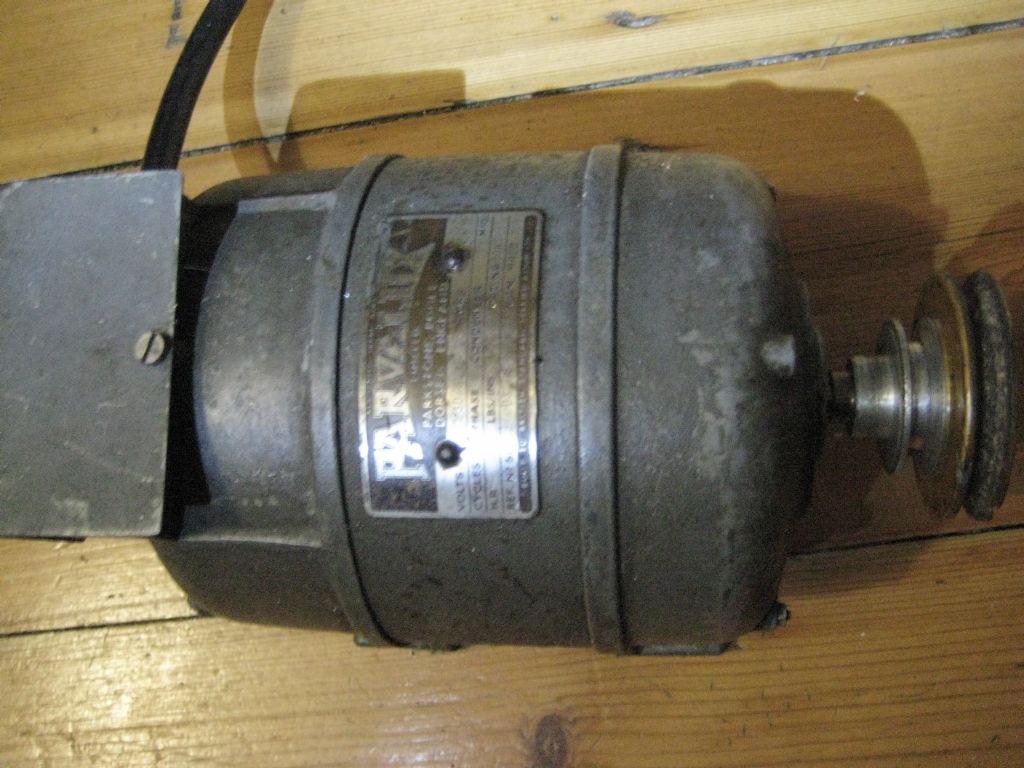

                    397.jpg396.jpgimg_5519.jpgMichael, I should have said Condenser motor. That's what it says on the label. No, there is no capacitor on the exterior.
                    This is the motor, the cover on the rear of the motor just covers the connection block. No capacitor visible there.
                    #661816
                      Fair enough, Victor … thanks for the clarification yes
                      dont know Just had a close look at your photo:
                      I can see no sign of any number stamped between CONDENSER and MFD
                      … perhaps that is a multi-purpose rating plate
                      [ which would be rather naughty of them ]
                      Edited By Michael Gilligan on 27/09/2023 21:44:21

                            Usually the type of motor has 3 wires from the casing, perhaps 2 white and 1 black. The 2 whites connect across a capacitor (approx 5uf) and the black is neutral, live incoming is connected to either of the white wires, swapping live supply to the other white reverses the motor direction.
                            If the motor is this type you should find equal resistance on each of the windings, measured each wh to bk.
                            The capacitor will be either in the connection box or external, not inside the motor casing.

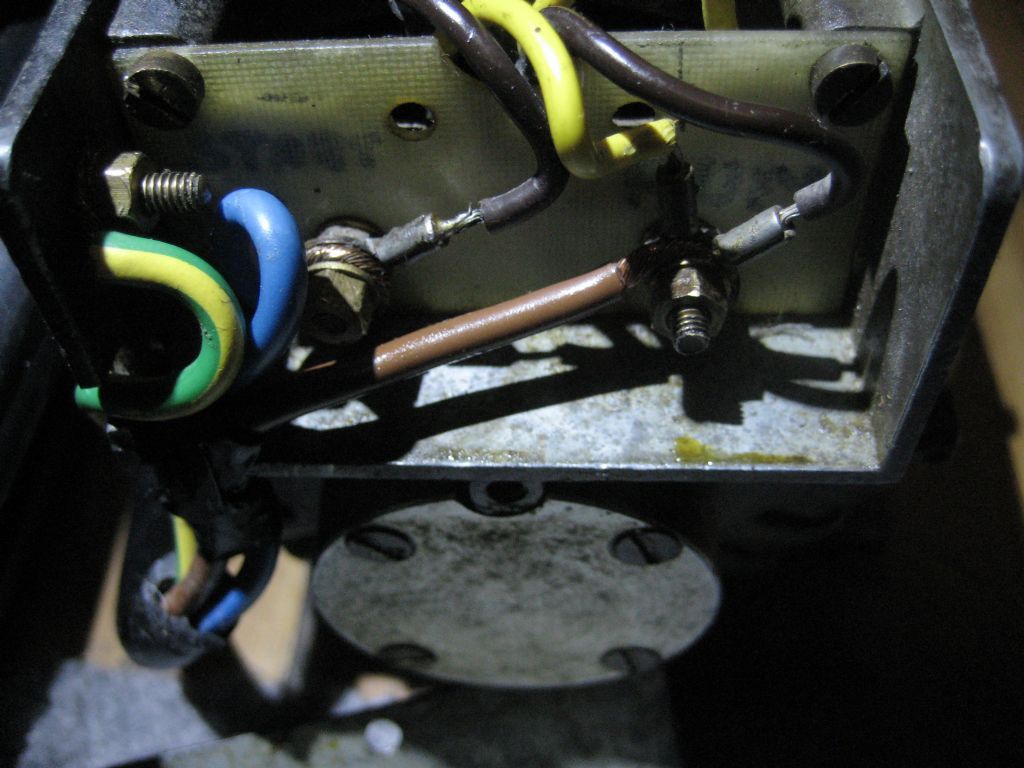

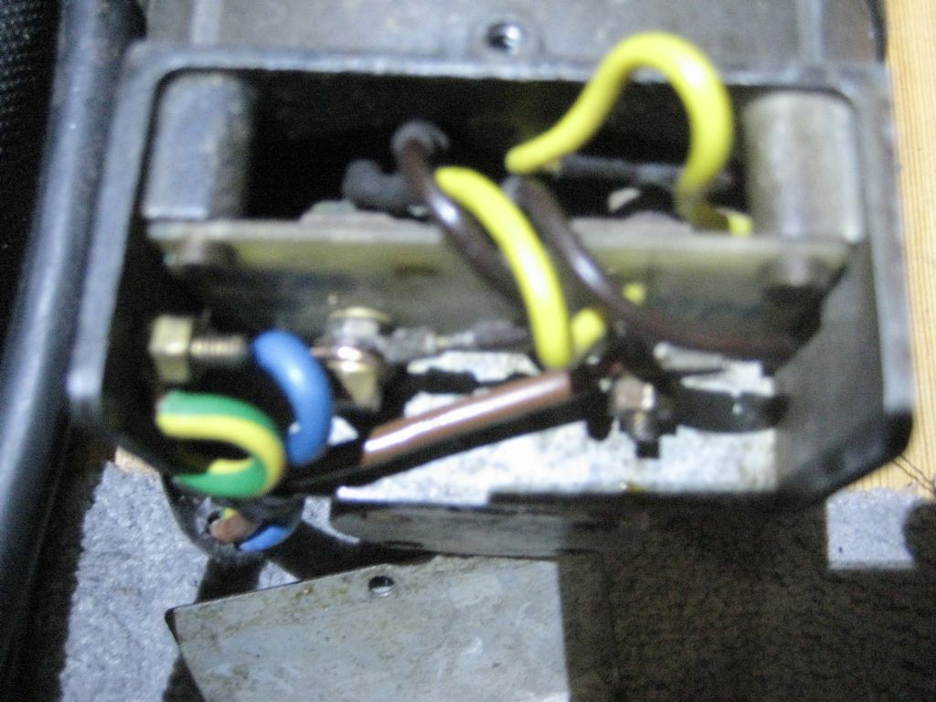

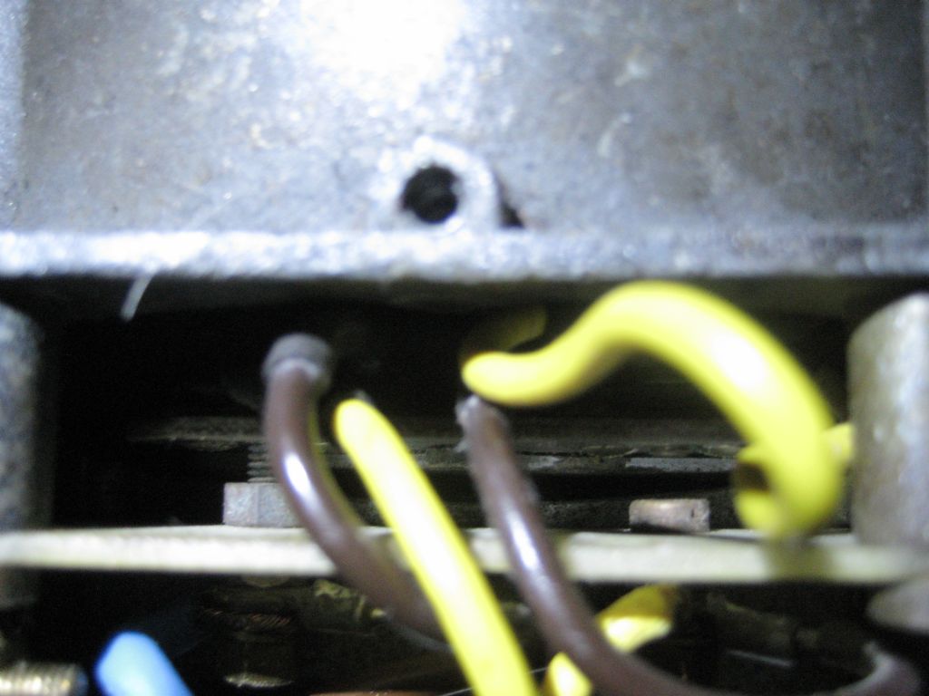

                              img_5522.jpgimg_5521.jpgIf there is no internal capacitor I am buggered. Here are some photos of the wiring connector, no capacitor in sight.

                                Does the motor plate have a TYPE named/marked ?
                                Can you see where the 2 yellows connect ?
                                Emgee

                                  I was reading about start and running windings, could it be that what I am hearing is the start winding kicking in over and over again?
                                  This motor has been running really well for so long, but I have never been able to take it apart to service it.

                                                      there appears to be a centrifugal switch in your pic of the connection box, you need to check the contacts are clean and the switch is operating cdorrectly, it sounds from your description that the motor is trying to start, but the contacts, which are closed when the motor is stopped, are not making contact properly and are not allowing sufficient current to flow to the start winding. , Can you see and clean the contacts (with an emory nail board) without stripping the motor? If not you need to remove the rear cover from the motor, not the shaft end. are there three screws in the centre of the rear cover, near where the shaft would be? these are bearing retainers and need to be removed before the end cap will come off!
