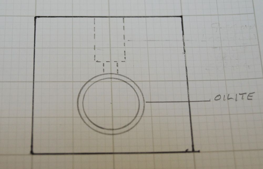

                                Ron Laden
                                  @ronladen17547
                                  I have decided to go with the oilites for the axles. I was speaking to a guy yesterday who used them on a twin bogie/4 axle electric loco. The loco is 5 years old and the oilites are still good today.
                                  I had an idea, knowing that oilite bearings like to be bathed in oil I thought of a simple way of achieving it.
                                  The rough sketch shows the 9mm hole for the suspension spring which sits centrally above the oilite. I thought if I drilled say a 3mm hole down through into the bearing location (before I fit the bearing) it would provide a well to feed the bearing. I,m guessing but say 3 or 4 drops of oil just to sit in the bottom would probably be enough and it could be topped up as required.
                                  Whether it is worth doing I dont know but it certainly cant do any arm and is very simple to do.
                                  Ron
                                  Edited By Ron Laden on 18/05/2018 09:59:58
                                  #354503
                                  duncan webster 1
                                    @duncanwebster1
                                    this is probably nit picking, but don't take the oil hole right through the bush. The highest pressure is at the top. A long time ago some railway engineer arranged a test rig of an axle and axle box. He had a felt pad at the bottom, and a feed hole in the top. When the axle was rotating it pumped oil off the pad and out through the feed hole. If you want to feed oil to the bearing/axle interface, move the feed hole so that it is tangential to the joint line, preferably at the back in the normal direction of running
                                    #354512
                                    Ron Laden
                                      @ronladen17547
                                      Thanks Duncan, no I will be drilling the feed hole prior to pressing in the bush. I am maybe misunderstanding this but what do you mean by the joint line..?
                                      Ron
                                      #354554
                                      duncan webster 1
                                        @duncanwebster1
                                        joint between axle and bush, hole is tangential to axle would have been a better way of putting it
