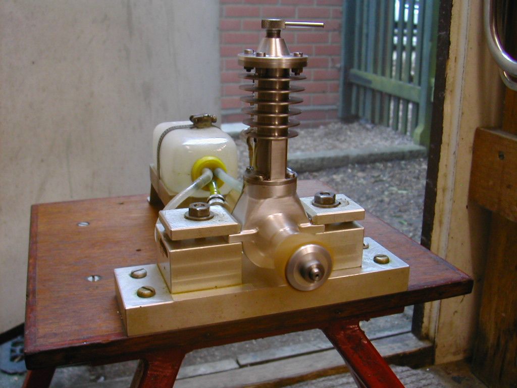

              Welcome to the forum Tim, in at the deep end with diesels!
              I found it useful to start the learning process by making a few simple tools, and – although I'm not a modeller – moving on via a couple of stationary steam engines (run on air), and a Stirling. I found Stewart Hart's PottyMill engine an excellent learner project because it's fabricated (no castings), and the build is neither too easy or too difficult. I used this rather cluttered plan, it's OK, no errors. Stewart's original is properly drawn on several sheets but I've lost the link.
              Later on I used the same engine to develop my CAD skills.
              Photos are always good if you have a camera, how to post them described here.
              Bit embarrassing but searching the web for PottyMill images finds a couple of my clunky pictures rather than any of the many much better built and finished versions made by other people!

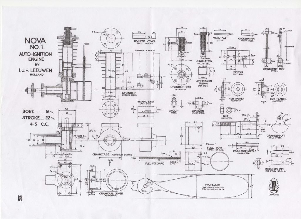

                        Welcome Tim from another life long aeromodeller – mainly control line and free flight with some R/C glider I've had many small engines over those years (sixty plus) but it was quite late when I decided to make my own. I do believe I covered the build on here somewhere and it was serialised in ME mag. Once that first attempt broke into a run I was hooked on making them for quite a while.
                        I made all mine from scratch without using any castings so the latter is not something that is necessarily required. There are several other builds on Model Engine Maker too of my other projects if that's of interest.
                        Biggest pitfall is to start with something too small in capacity – yes many have been made around the .8cc mark but getting the piston liner fit becomes more challenging the smaller you go. A good project to begin with would be the Nalon Viper -2.5cc diesel and as designed completely made from bar stock material. A good performer too if made well. There are several glow engines to choose from too as no doubt you have found but my preference are diesels
                        As my interest in making engines comes to an end however it's good to hear of someone with a new interest in them so good luck with the start of your adventures with the delights of 'making your own' – if I can be of any help just ask.
                        Best – Tug
                        PS Here's the one that kicked it all off for me – The Nova 4.5cc BTW Ignore that fuel recommendation!
                        NOVA 1

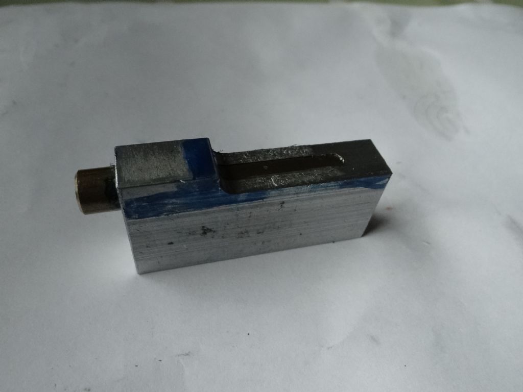

                                  Lastly, this strange beast. It was made to support a long brass pin so that half the diameter of the shaft could be milled off. I remember holding the pin in the steel block with a dab of super-glue for cutting, but not what the pin was for! Odd tools like this often turn up in deceased workshop sales, and no-one knows what they're for.
