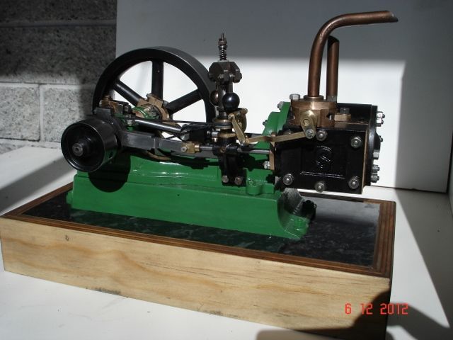

                018 (640x480).jpgI rebuilt a S9 last year, it had been started, but was in a sorry state.snapshot_20121005.jpg

                      Ian S C
                        @iansc
                        One of the studs on the front cylinder cover on mine was stripped, I tapped it 10 32 / 3/16" UNF, and made a stepped stud, think the studs are 4 BA. Another stud in the steam chest had to be moved, I drilled and tapped that and screwed in a slug of cast iron.
