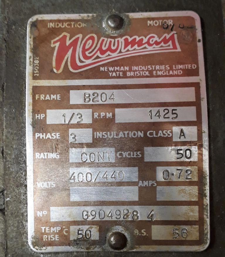

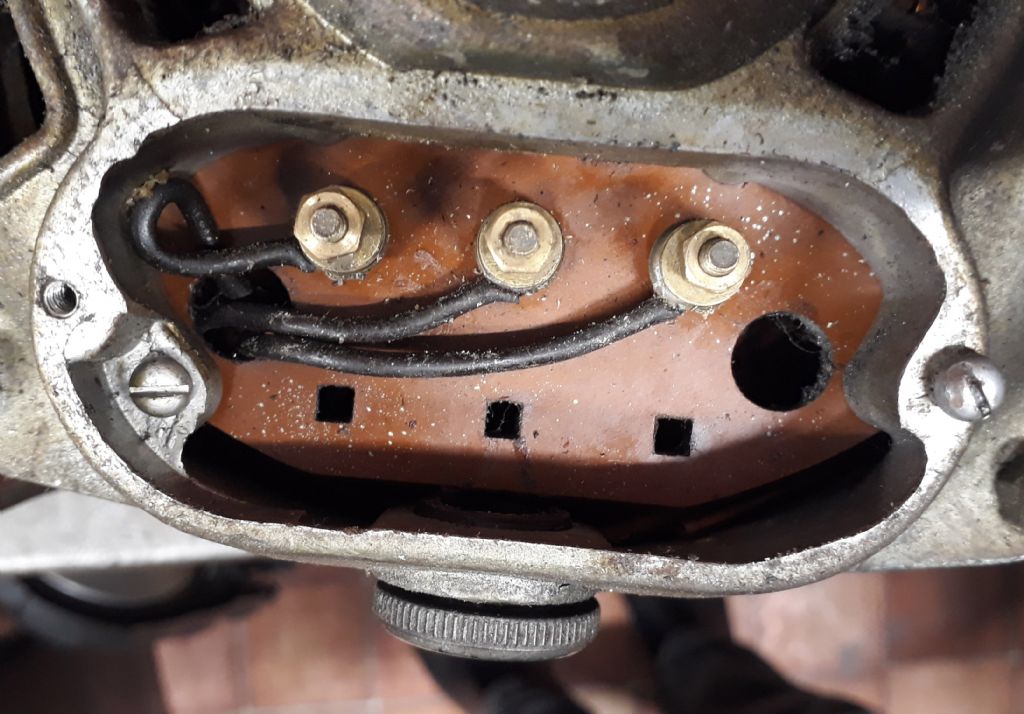

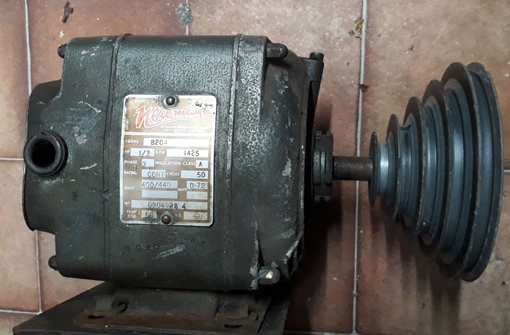

      I have bought a 3 phase Meddings Driltru which I want to run on single phase. I'd like to use the original Newman motor with an inverter but unlike the motors on my lathe and mill which I have already converted the Newman is not marked as dual voltage and there are only three terminals under the plate. I have read that in such a case the necessary connections can sometimes be accomplished by dismantling the motor to get at the windings but sometimes this is not practical. Before I take mine to bits I thought I'd ask if anyone has experience of converting this particular type.

          I have done the star to delta mod on quite a few motors that are not preconfigured for star or delta. Unfortunately not on a Newman motor. I have yet to find a motor that can't be converted.
          Most times the conversion is straightforward, but sometimes it can get quite difficult especially if more than 3 joints are to be seen!
          You need to take care with insulating any mods you make to bring out the 3 wires of the star point to the connection box. If you are not completely comfortable in modifying the mains wiring, then I recommend you to leave well alone and get someone do the job who is!

            Shown as a single voltage on the plate it may not be easy to change to delta. You need to be able to get at star point and sort the tails out. As Andrew has said IF you are not used to working with mains voltages safely then get it done for you or change to single phase or replace with a dual voltage motor that can be easily changed to delta. Good luck, Noel

                  Normal 3 phase is 400-440v. The "synthetic" 3 phase from a VFD is 230v. Most 3 phase motors can be configured to run on either voltage – star for 400v or delta for 230v ("dual voltage" motors) and this is usually made clear on the spec plate. Motors that are not intended as dual voltage, like this one, may or may not be easily converted depending on whether the node of the star is accessible or not.
                  However, I had a conversation with the fellow at the Inverter Supermarket who pointed out that it the motor may run satisfactoraly at the lower voltage as is. Here is a link to an explanation of how that works:
                  **LINK**
                  Basically the motor can be considered as a 230v 29Hz motor so will run at about 60% of normal RPM. Above 29Hz torque will drop off but that may not matter because one normally uses higher speeds for smaller drillbits which require less torque to turn. Definitely worth trying I think.

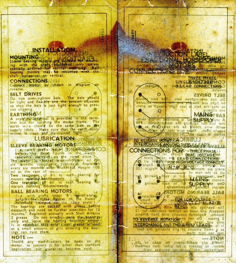

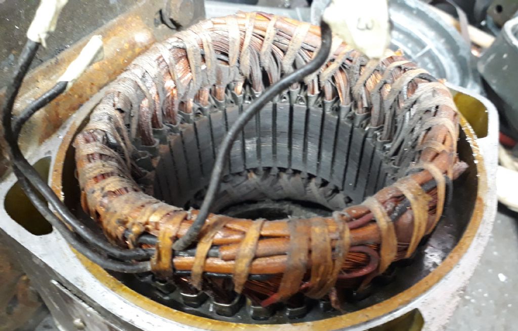

                                  Well here are the windings:
                                  and here are the instructions which emerged when I opened the case – these are the two sides of an oil soaked piece of paper so rather transparent but legible:
                                  I wonder why they would make two versions of the motor, with and without dual voltage. Some small cost saving i suppose.
                                  In a spirit of enquiry I think I will reassemble it and try at as is. If it is too feeble I'm pretty sure I'll be able to dig out the node and rewire it.
                                  The Steinmetz circuit looks interesting but I do want the VFD extras (reversing, speed control, jog) to make power tapping easier.
