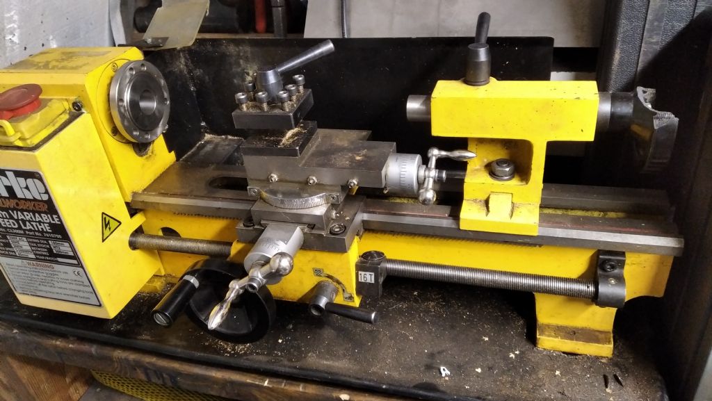

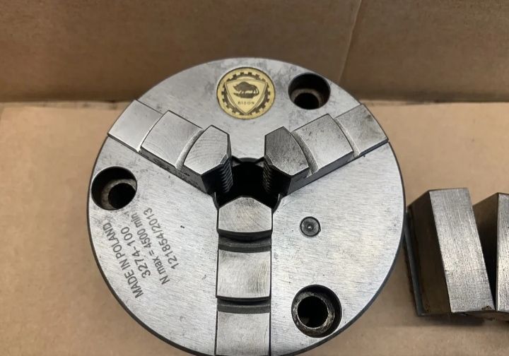

                                  £500 isn't an unreasonable budget if you're willing to do some tinkering, I just bought a little project lathe that I'm hoping to get finished for around £500.
                                  Spares or repair Clarke mini lathe eBay £156
                                  Bison 100mm 3 jaw chuck with both sets of jaws and an unused set of soft jaws £60 eBay.

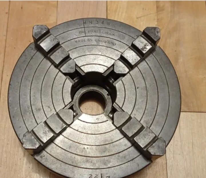

                                  Pratt 6" 4 jaw with a back plate I can machine to fit £28 eBay.
                                  The lathe has no motor so I'm going to fit a 1/2hp 3 phase and inverter, invertek UK made inverter £120 delivered, motor £60 , and the end result should be better than something you can buy new as the electronics on these little lathes seem to be their weak point.
                                  I'll also be addressing all the usual quality control issues with these lathes and would like to add a rack and pinion tailstock function, generally I'm pretty impressed with the lathes build quality given some of negative feedback from owners, I would avoid buying these mini lathes from Amazon and eBay sellers that are not specific machine traders based in the UK, I've seen some absolute horror shows on YouTube of these eBay Specials assembled from rejected parts

                                    The 6" 4 jaw is bit cumbersome on this little lathe, I think I'll buy a100mm 4 jaw when I've finished this project as they're only about 50 quid, this 6" can go on my rotary table, but you get the idea that if you're willing to take on a bit of a project you can build something pretty good for your £500 budget.
