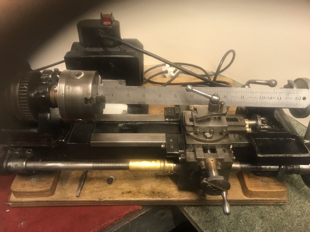

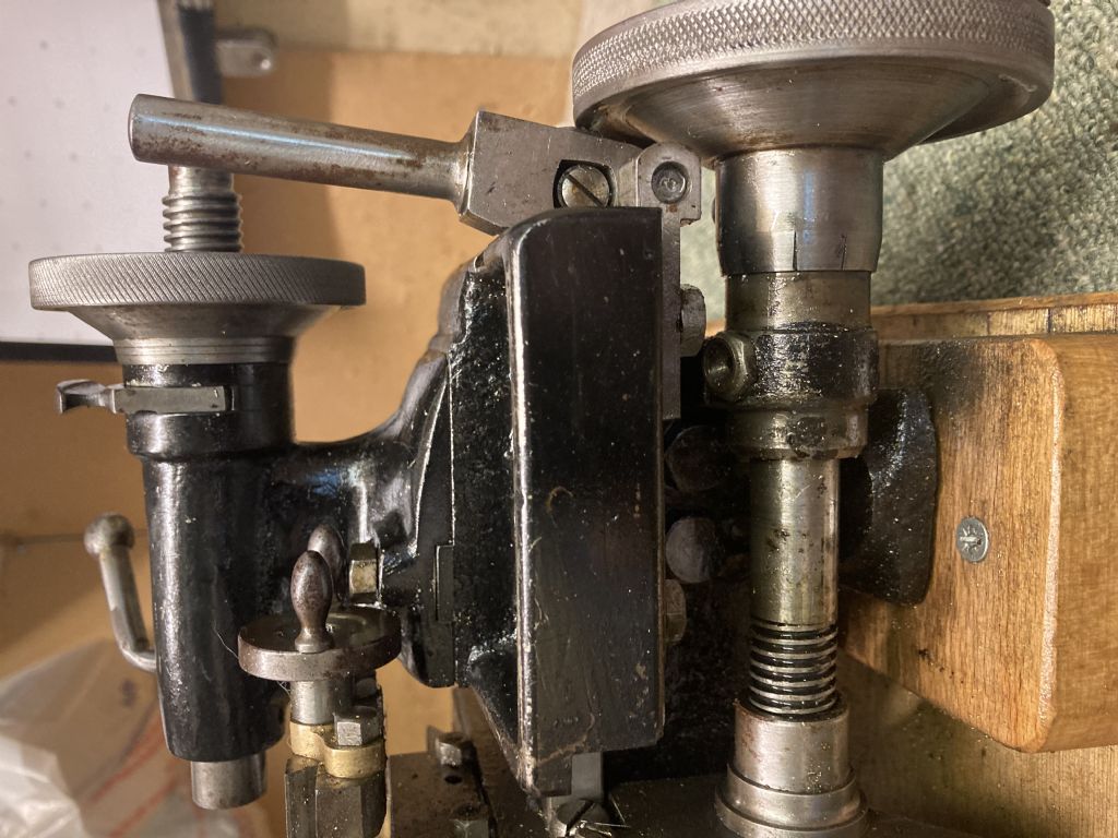

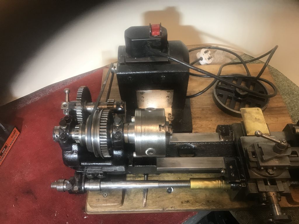

      Can anyone help me to identify this lathe please.
      Probably British made, 60/70 years old. I’m told it
      had a power feed which has been removed. I’m having issues with the tail stock. The widest apertureon the tail stock measures a tad under 10mm. It’s a taper and the only way I could think of measuring it was to either buy a few tools of various sizes to see which fits, I haven’t done this yet, or to place various size drill bits in the aperture. It will not take a 10mm bit, the 9.5mm goes 10mm into it, the
      9.00mm bit 20mm in, the 8.5mm bit 30mm in,
      the 8.0mm bit 35mm in, 7.5mm 120mm in, the
      7.00m bit passes right through the whole 140mm
      length.
      They’re no makers marks at all on the lathe.
      If there other questions that need answering, or
      different photo angles required then please shout and
      I will do my best.
      Ian from ACE Euro Trade who was very helpful
      suggested I solicit your assistance.
      Many thanks for taking the time to read this post.
      Regards
      Mick

          Your measurements are half-way to identifying the taper!
          Use them to work out the y-in-x change or the angle (the former is the value usually used) then compare that to the standards published in engineering texts.
          If the lathe is British-made the taper is most likely Morse; and if so, centres, drills and other tooling is readily obtainable. The spindle should have a similar, possibly size larger, taper as well, allowing turning between centres.
          I'm a bit surprised it has no name or trademark on it though that may have been on a plate long since lost. If you can find it, or someone identifies it, then look on Tony Griffiths' lathes.co web-site, our "bible" for identifying and finding the history of machine-tools ancient and modern.
          It looks an admirable find, in good condition still capable of quality work.
          That little tool-tray (I guess it is) on the tailstock is a neat touch!
          Note what seem two tapped holes on the lower edge of the headstock. Do they hide grub-screws locking the headstock to the bed, or are they for an accessory such as gear-box, Myford fashion, I wonder.

            The power feed simply uses the thread on the lead screw, all that's missing will be the gears and banjo which connect to the headstock mandrel and it should be possible to fabricate something to get it going.

              Cute, well made, awesome looking pulley system which could fit a small fanbelt
              Is it metric or imperial?
              edit: count the TPI on the leadscrew, measure across the bed
              Inquiring minds are interested, would love it to be British but it may be German etc

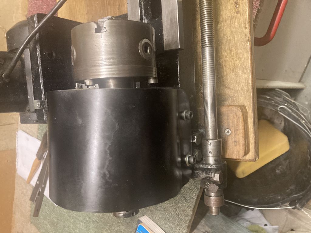

                    1. Many thanks to you all for your valuable feedback.
                      Nigel – I have no knowledge of the y-in-x change – isthere something I could read up on? I’ll take pics of the spindle late and send them on.
                      Absolutely no name plate at all anywhere. The two
                      tapped holes are being used for a cover that’s been fashioned and shown in latest pics.
                      I’m a total lathe newbie but it is a very well made piece of engineering.
                      Vic – I’d love to find out exactly how to do this – canI read about it anywhere?
                      Ady1 – fairly sure it’s imperial but please look at the latest pics. Tooling is 1/4 inch.
                      Diogenes II – again no expert but there is a suggestion that it is a fraction small for MT0
                      Brian Baker 1 – many apologies but I have no idea – how would I research that thought

                            We need to see a full on view of the end of the headstock to see about the possibility of getting power feed restored one way or another. The main part missing is the banjo which fits on the bracket at the end of the leadscrew and has slots to hold the gear change wheels, these are common to many lathes and there are websites showing the making of parts such as this.
                            The missing gears can be adapted from other makes of lathe and are commonly seen on Ebay.

                                  Hopper
                                  Many thanks for your time it is much appreciated.
                                  I have sent some pics off to Tony as suggested and will report back when I hear from him.
                                  I’ll take more pics later as requested but – and please forgive my ignorance.

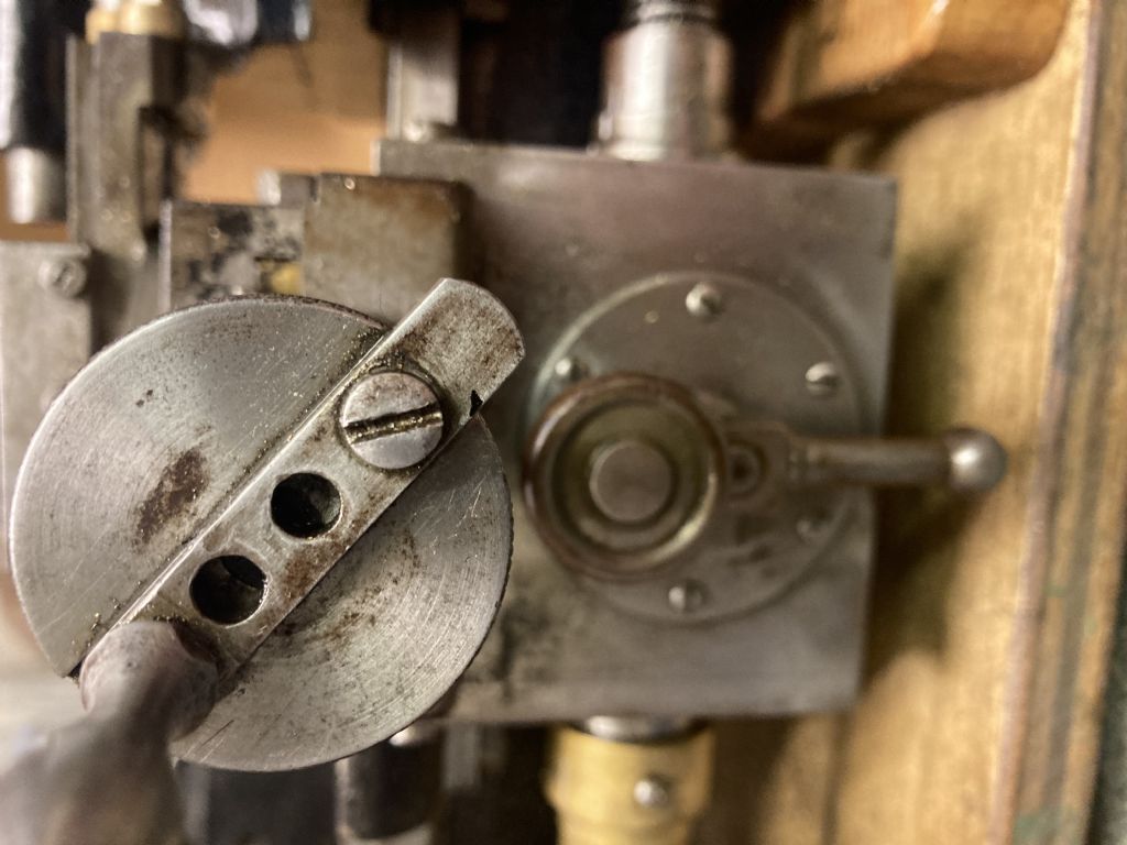

                                  The silver lever sticking upwards on the rhs of the cast iron tray locks the tail stock chassis I believe.
                                  can you just explain what the apron refers to and I will be happy to send pics if it.

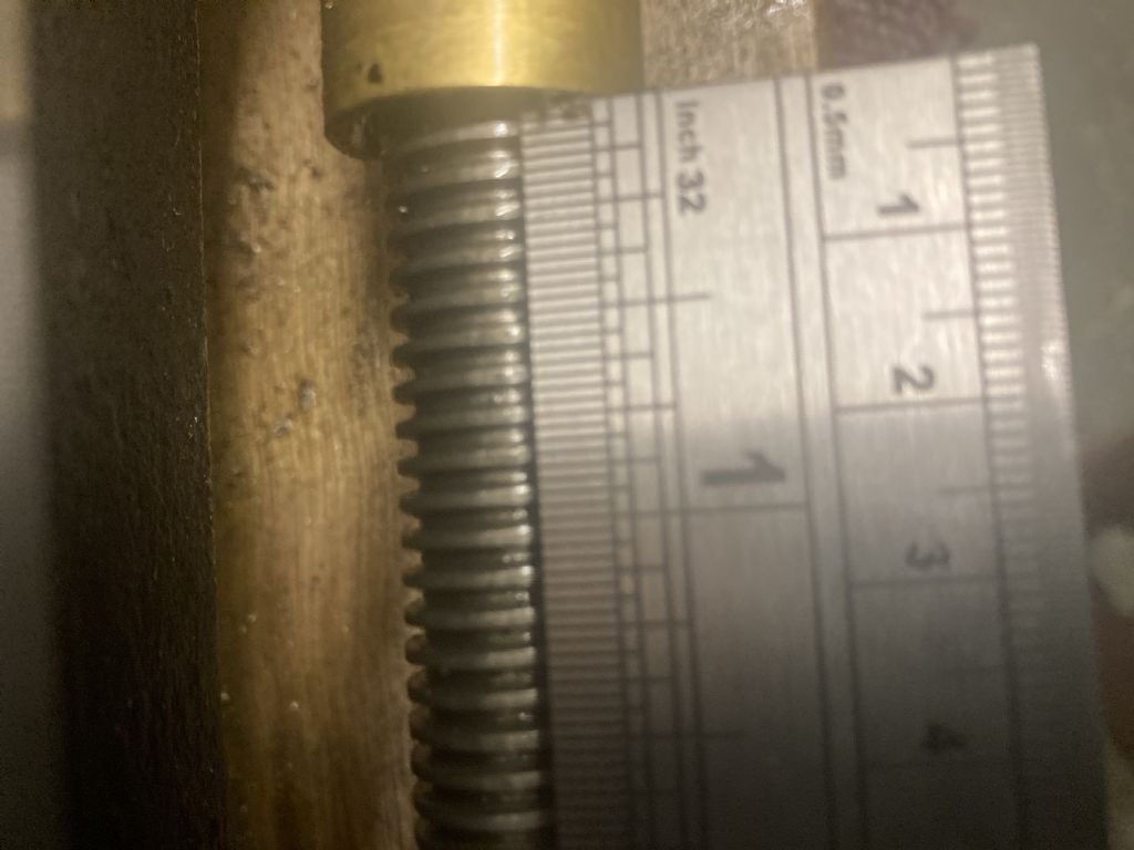

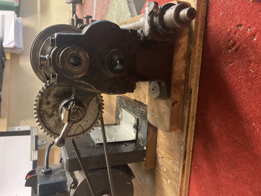

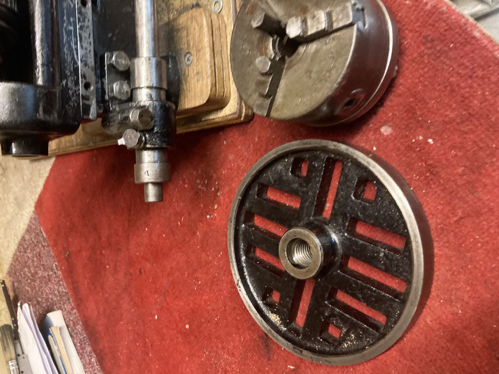

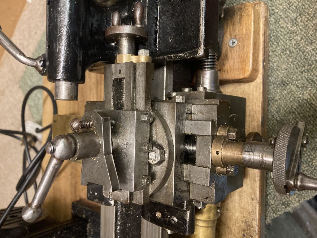

                                      Vic – hope the pics are the correct ones for you to take a look

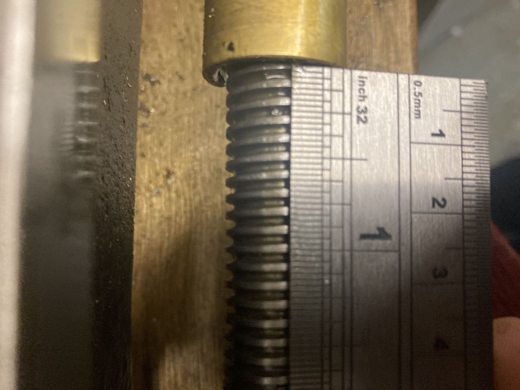

                                      Hopper – I don’t have a dial indicator but I can tell
                                      You that 3 complete turns of the lead screw = 5/16”
                                      Of movement. I’ve attached a new pic that shows 10TPI which I’m fairly confident is accurate, together
                                      With further pics of the silver lever as requested
                                      I really appreciate all the opinions and time .
                                      Many thanks
                                      MickB

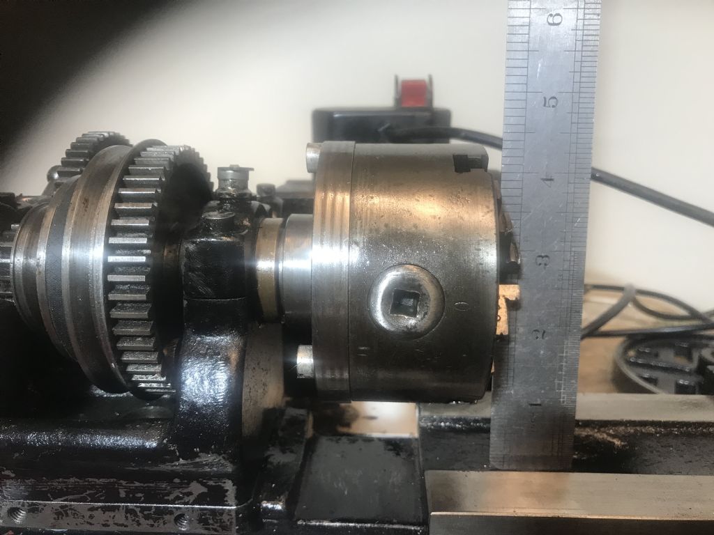

                                        4 inches across the bed and 10TPI, nice spindle hole size
                                        The whole thing looks really well thought out, and built,
                                        a Drummond cowells lovechild, a PROPER super adept
                                        It must be a USA import is my guess, a UK maker at this standard would surely be well known
                                        There seems to be a few of these unknowns about
                                        Edited By Ady1 on 22/02/2023 14:29:11

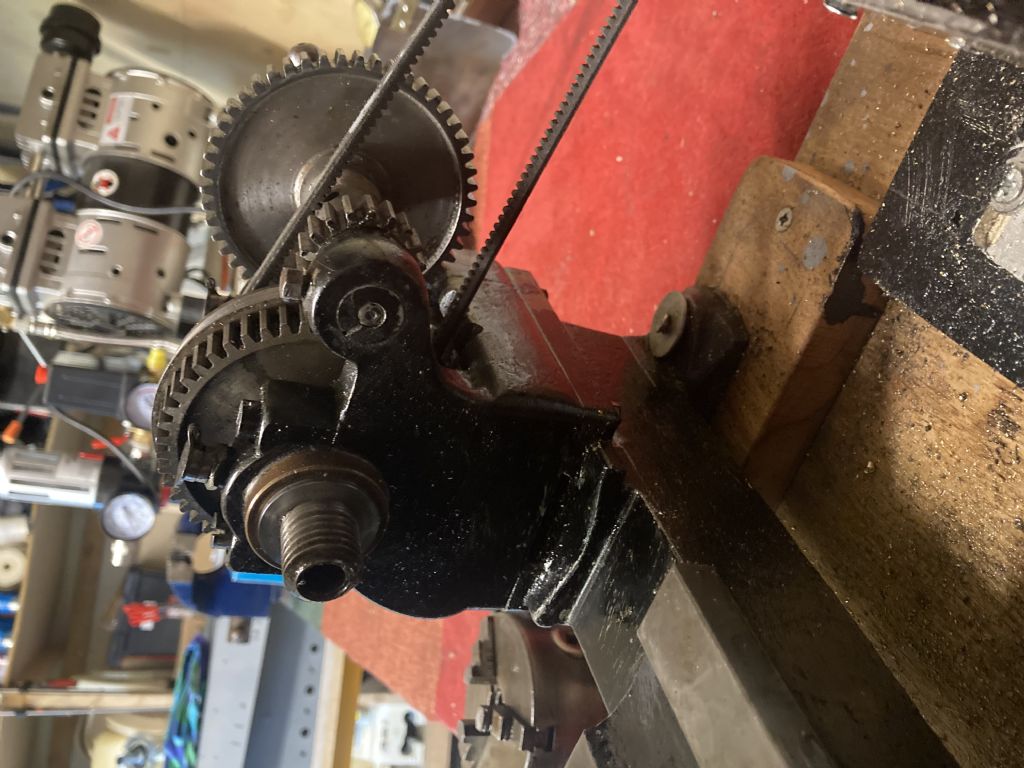

                                        vic newey
                                          @vicnewey60017
                                          Thanks for the additional photo's and don't worry about us using our time to help, we are enjoying it!
                                          I'm even more convinced there was a banjo on this lathe, apart from the end of the leadscrew casting having a location for it, the hole below the mandrel possibly being for the leadscrew reversing mechanism although a bit large for that but who knows, it's there for something and has a machined flange.
                                          The way to get around the missing mandrel gear would be to utilise some kind of fitment inside the bore to extend it and hold the gear, maybe you would sacrifice being able to push lengths of rod through the mandrel but maybe you still could but reduced size depending on what you fitted to hold the gear

                                          Ady1
                                            @ady1
                                            An early perfecto?
                                            The headstock casting is very perfecto, (not at all "German" -)

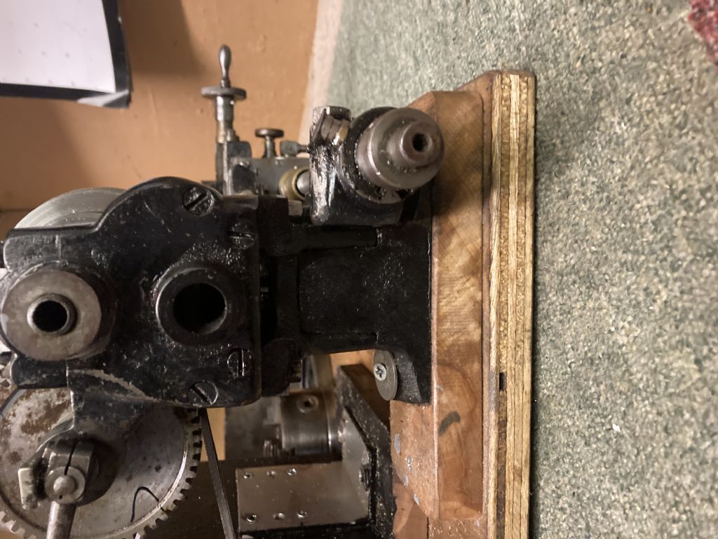

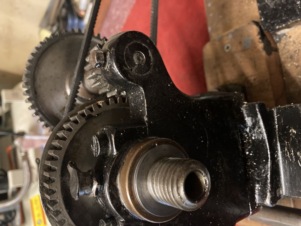

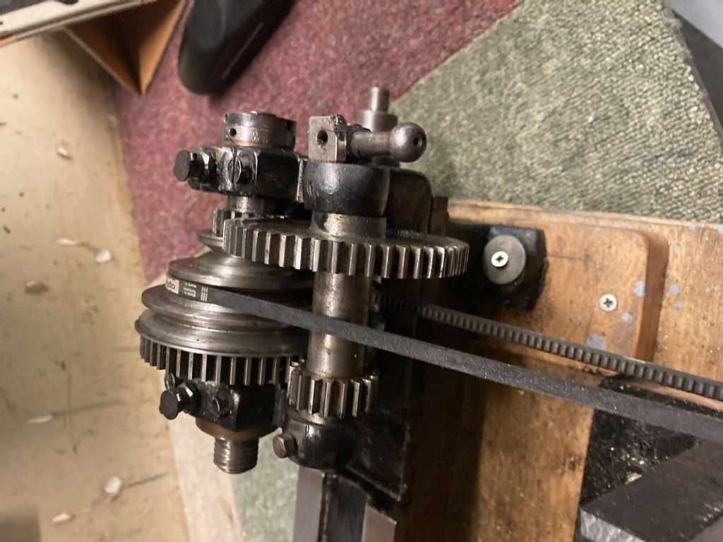

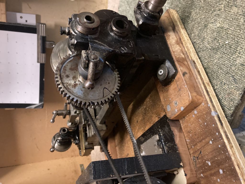

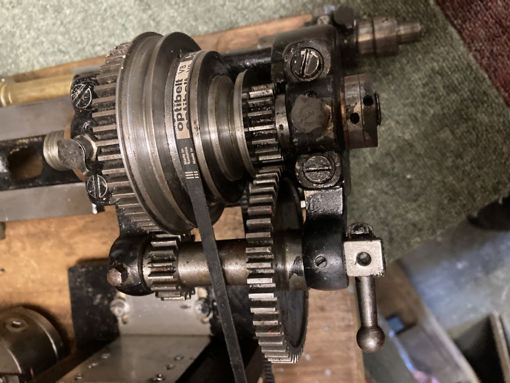

                                              All round shots of the head stock if that helps.
                                              Putting all my cards on the table I do struggle to
                                              understand some of your posts as you are all very.
                                              knowledgeable about the subject and I am anything
                                              but. No idea what a banjo or Mandrel is in this
                                              context but I will continue to try and follow as best I can.
                                              f9ec2846-543c-4415-95c6-656268e2f8f9.jpegdfa773bd-d631-4803-a4d9-bb493a01c5e1.jpeg96545fef-1df2-4345-bd94-eea021b35ec2.jpeg8512f7d9-1b01-4481-82cd-27cb487bfd55.jpeg78661af2-2853-4e1f-9ef1-07b32de0ce31.jpeg00d3c86e-c4b2-4286-9205-04bfa78caa31.jpeg
                                              #634595
                                              vic newey
                                                @vicnewey60017
                                                Here is an Ebay link showing a banjo lathe banjo the gears are fixed onto it, the mandrel is the part you have the chuck screwed on to the front of, another word you would be more familiar with would be to call it a spindle.
                                                There are lots of banjo's for sale on Ebay UK but you need one where the round part fits your lathe on the leadscrew casting
                                                Edited By vic newey on 22/02/2023 16:13:29

                                                      Those extra pics show lots of very distinctive detail not seen on the run of the mill small lathes of the era, like the handwheels, tailstock, apron, cross and top slide construction etc. And it all smacks of quality, not cheap hobby machine. Intriguing.
