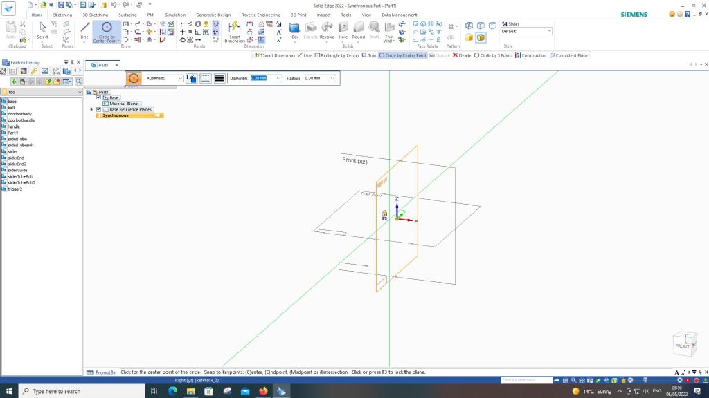

Solid Edge's sketcher, and most other SE tools, require the coordinated use of the ESC, RETURN and F3 keys plus the right and left mouse buttons, AND hovering. Of these, F3 is the most important. It locks the sketch to a particular plane or face. If the operator fails to lock the wanted plane or face, Solid Edge can jump to whatever other feature is closest, so the next operation might be done in the wrong place. Very confusing!
Image is SE starting a new part with a sketch. It shows the operator can choose to draw in any of the 3 planes XZ(Front), XY(Top) or YZ(Right). YZ(Right) is highlighted in orange because SE guesses I want it based on where I have the mouse cursor. Note the F3 Padlock symbol: it's telling me that pressing the F3 key will lock whatever I do next to YZ(Right) until unlocked. Locking is good because it stops SE leaping about unexpectedly!
Hovering (gently moving the mouse over a wanted feature) is necessary because it allows the context of the next operation to be selected from a number of alternatives. The feature saves time compared with clicking a tool and selecting the object to be changed, but the operator has to make sure the operation he wants is ready to go. It's not always obvious what's going on – the beginner seems to get different results when he does exactly the same thing: actually he's not noticed the symbol next to the mouse pointer is changing…

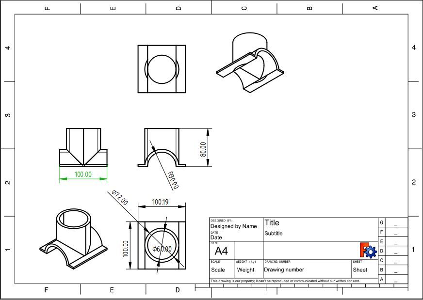

A huge advantage of 3D-CAD tools is they make producing 2D drawings trivially easy, though I have to admit they lack personality!
This is the 3D object I created in FreeCAD in answer to Hans (Versaboss) in another thread:
Once the 3D thingy is created, producing the 2D drawing is just a matter of clicking a few buttons. This is First Angle, if you want Third Angle instead, no problem boss. Sections are fine too.
