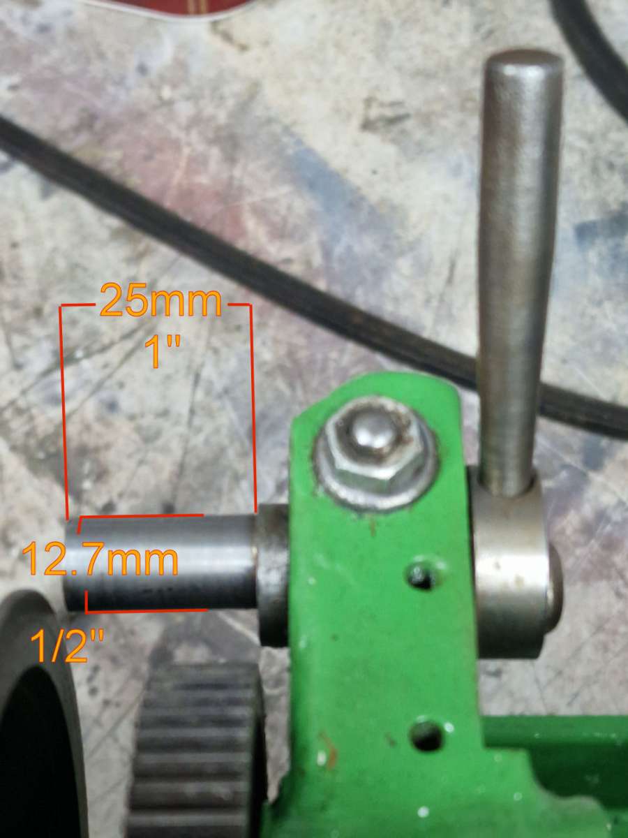

      Hello to you all
      I have been after a lathe for the last 5 years or so. More recently some little jobs have become a royal pain not having the facility of a lathe so I finally took the plunge and purchased a Myford ML4 from eBay that was quite local to me in the UK. It’s a perfect size machine for my limited available space and should serve me well.
      I am however missing a couple of items.

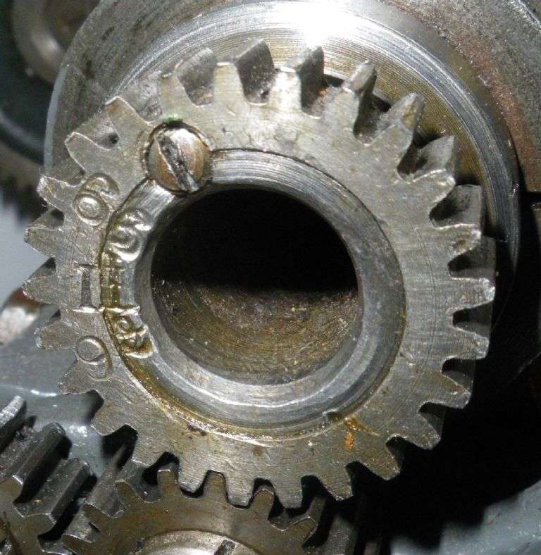

      1. The gear wheel on the main shaft for the tumble reverse.
      The Shaft is 7/8″ with a depth of 1/2″
      unnamed
      And it needs a gear like this one…
      671182

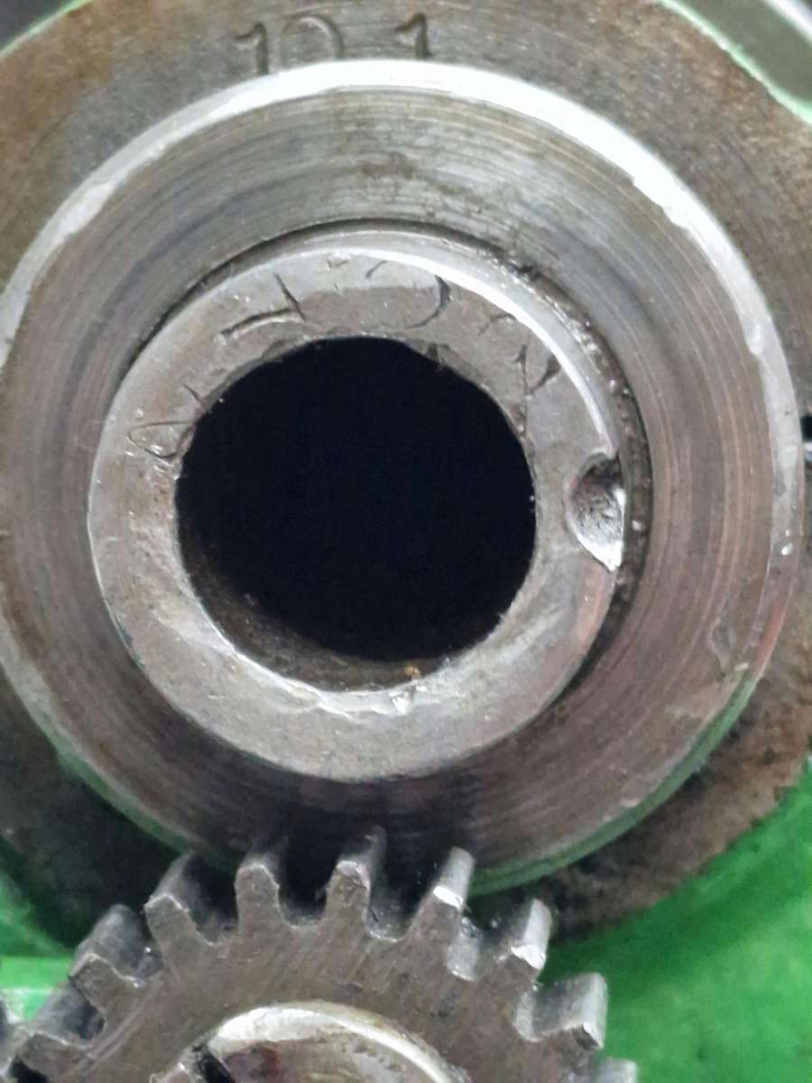

      2. The gear ‘set’ or ‘pair’ on the back gear spindle.

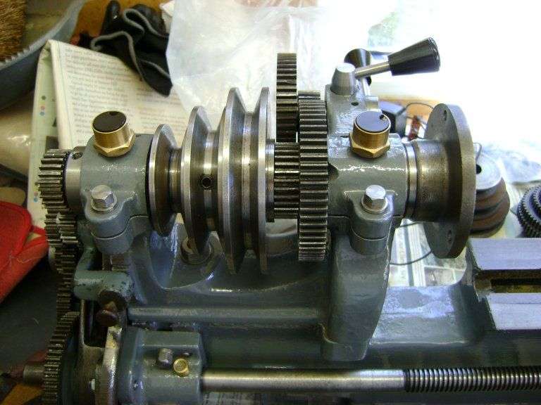

      Back Shaft
      Main Shaft Back Gears
      Which should be the same as this one, although I do not know how many teeth each gear should have,,,
      672016
      Any info and advice to help identify the back gears and availability to purchase both items would be greatly received.
      Many thanks
      Paul
      aka castingflame

        Being a Myford, the gears are likely to be 20 DP, 14.5 pressure angle.
        (You can check with one of the changewheels, if they mesh nicely with the gears on the spindle)
        Count the number of teeth on the pinion that meshes with the 65T wheel. The sum of gear teeth should be the same for both meshes.
        (65+ pinion) = (30+ gear)
        Normal Myford changewheels are 5/8″ bore, so MIGHT fit the shaft, without need for bushing or boring.
        But you may need to make a collar, to retain it, and possibly a spacer to separate it from the other gear.

          Of you measure the tumbler gears, you should be able to calculate the PCD of them. If you measure the centre distance, between the spindle and the tumbler gear, you should then be able to calculate the PCD of the Spindle gear.
          Knowing the PCD should allow you to calculate the tooth count for the Spindle gear

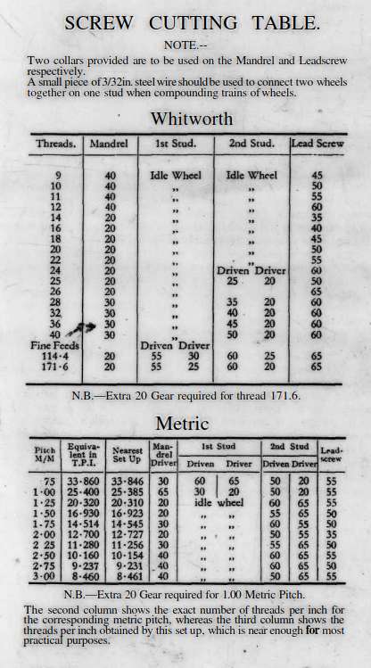

            The gear set needed for screw-cutting and fine-finish as supplied with the lathe can be extracted from the manual.
            ml4screwcuttable

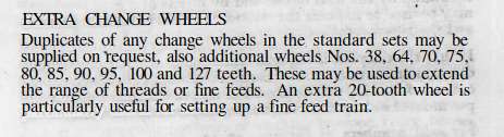

            Myford also sold extras:
            ml4extra
            Whether or not all these gears are needed depends on what you do, but Myford recommended buying another 20 toothed gear, and, if you have to cut metric threads, then 127 is the bees knees,

              The gear on the tumbler reverse end of the spindle is 25 teeth, 20 DP with a pressure angle of 14.5 degrees.
              The twin gears making up the swinging back gear cluster will need to be calculated  to give a reduction of somewhere between 1:6 and 1:7
              These too will be 20DP and of 14.5 degrees pressure angle
              I can also confirm the bull wheel as having 65 teeth, that will be 1 inch bore to fit on the lathe spindle, and the DP and PA detail will match those listed above

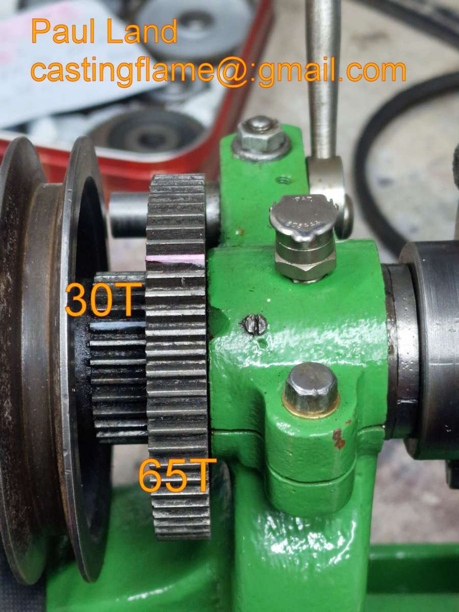

                    WILD guess, but the pinion for the Back Gear , to mesh with the 65T Bull Wheel could be 20T.
                    Since that tooth count would be 85, the 30T would mesh with a 55T gear on the back Gear cluster.
                    This would given overall reduction of  5.96, which would be about the sort of ration to be expected from a back Gear set up.
                    Howard

                      Thankyou guys your help is very much appreciated.
                      Info for anyone else who may stumble upon this thread in the future as info seems a bit sparse on the ML4.
                      Howards Comment  was spot on correct for the gear sizes.
                      Gears on the 1″ Mandrel Shaft
                      65 teeth on larger
                      30 teeth on smaller
                      Gear cluster on the 1/2″ Back Shaft (now fitted)
                      55 on larger
                      20 on smaller
                      Which gives a reduction of 5.96:1
