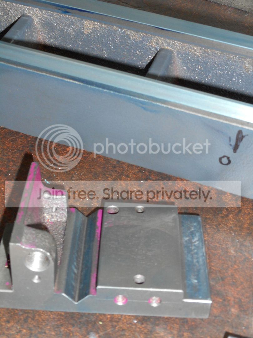

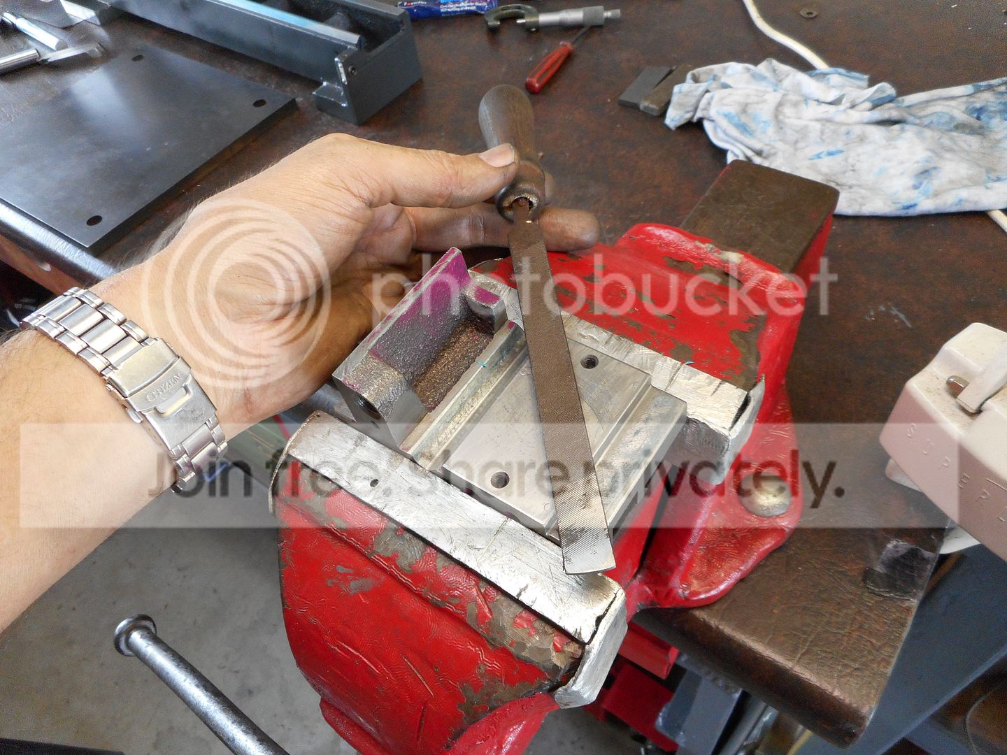

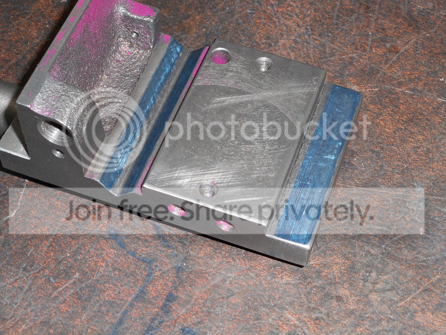

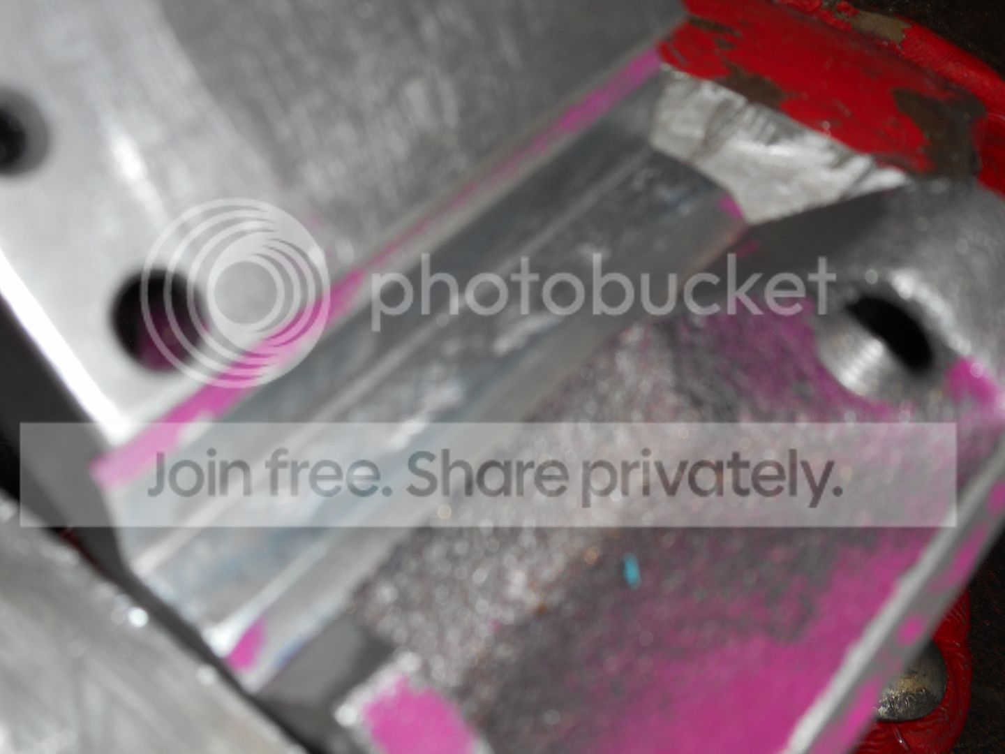

      Then it was on to the scraping for the fine-tuning. I had to make a tiny little scraper out of a surplus flat file because all my scrapers were made for working on power station turbines and thousand-ton stamping presses etc and would not quite get into that crowded V way with the big lumps of metal sticking up beside it.
      A blurry picture of the scraping in progress. You may be able to see the diagonal patterns were you scrape alternate directions at 90 degrees, slowly removing the blue high spots.
      So, scrape scrape scrape scrape scrape and we get to where we have a larger contact area on both ways, again shown with wodges of blue for the camera. But the contact area has come down the V way almost to the point. I decided to leave it at that because to get the edge of the scraper right into the point you have to cut a groove down the apex of the way, and that would weaken the already tiddly cross slide even more.
      Bit more of a real world view with less blue splodged on it
      For our purposes, mating to the main bed ways that have not been precision ground or scraped to match a reliable gauge-room template, this is good enough. The carriage will now sit on a larger area, making it more stable and smooth-acting. The scraper marks will help retain a bit of oil for lubrication too. No, no fancy frosting finish etc. That's for show ponies.
      So that is the carriage ways cleaned up rather nicely. Next step will be to flip the bed over and get the file and stones onto those underneath ways and get them nice and smooth and dead parallel to the bed top ways. Once that is done, we can look at fitting that gib plate/clamping plate to the carriage and setting it up so it will slide nicely all the way from the headstock to that 5-inch mark from the other end where the bed falls off the edge of that five thou cliff. I am not even going to try to rectify that last bit. It will only be used to park the tailstock when not in use so it can stay as is.
      And once the carriage is sliding smoothly and steadily, we can chuck up a test bar and see if it indicates that the headstock is sitting on a similar 5 thou drop-off at the other end of the ways. If it is there are three ways to deal with it: leave it and live with a slight taper on turning jobs, scrape the bed down flat (sorry don't have weeks of spare time to move that much metal) or shim the low end of the headstock (not the best for solidity but we'll see. It might be just fine.)
      Will probably have a rest day tomorrow, so more Optimum news after that.
      Edited By Hopper on 31/10/2015 08:19:08

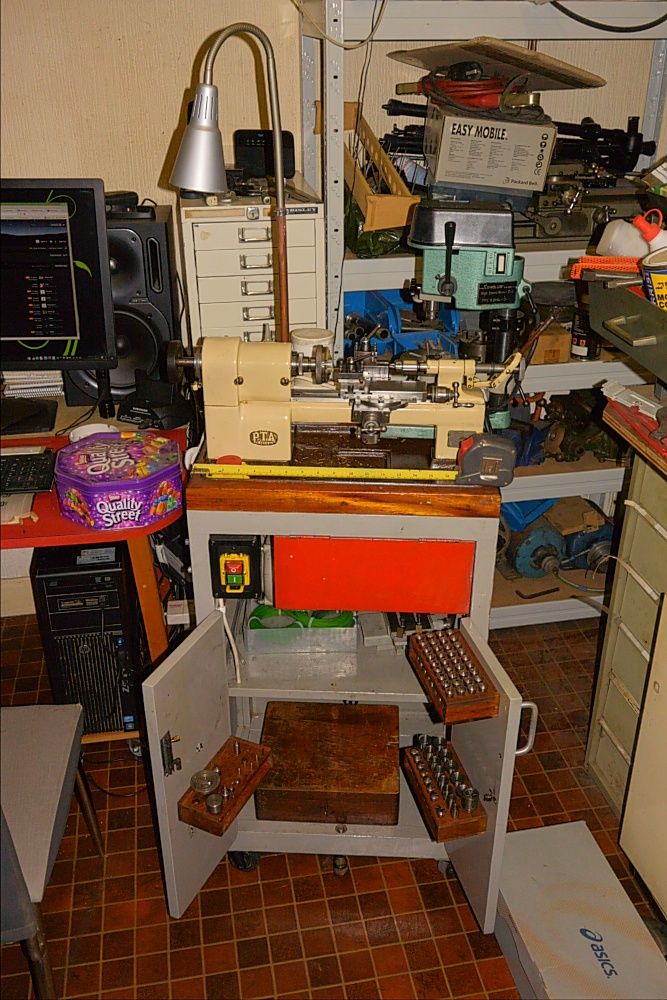

          To cleanse the palate, and provide a benchmark
          Here is a video of a near perfect 'small lathe' … Lorch KD 50
          It's over 40 minutes long, but edited into convenient chapters.
          Superb Design, and obsessive attention to detail.

                    Posted by Michael Gilligan on 31/10/2015 09:49:37:
                    Edited By Michael Gilligan on 31/10/2015 09:50:49
                    He has a rather nice piece of brass there. Mine seems to be a bit hit and miss.
                    Schaublin are the leaders in that particular line of lathes. Famed mainly because they made interchangeable parts that didn't lead to any loss in the basic accuracy of the lathe plus lots of bits and pieces.

                    As I am a bit of a lathe nut. I did have a Lorch for a while and a small Schaublin. I still have a Boley and now after a long long wait a Pultra. I reckon Holbrook and one or two others got it right. The best answer to bearings if some one want the word precision to have meaning is to try and make sure they never wear out.

                          Looks like we are unlikely to agree on this one, John
                          The Lorch includes an overhead drive within its tiny footprint; and I'm quite sure that I couldn't match that level of integration with my Pultra.
                          #210100
                            Too late to edit my last post
                            Here is the aforementioned tiny footprint.
                            … I remain very impressed.
