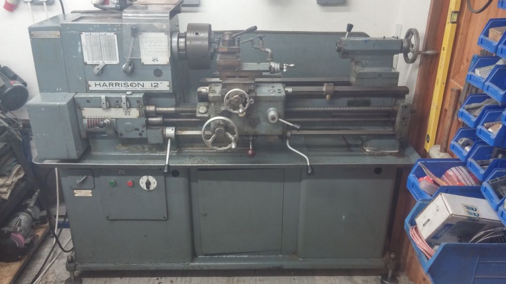

        Ok so the eagle has landed!!!i have a new used harrison l6 mk3 and what a beast!
        ive noticed there is no graduations on the main apron handweel?
        I would like to take it apart as much as i can to give it a clean etc as there is a lot of brass swarf mixed in with grease etc.
        Can i take the main screwcutting leadscrew out to de grease and re grease etc?
        i cant find a spindle lock to remove the 3 jaw , dont know if it has one, ive seen the piece of wood trick and open the jaws so it fouls the the wood whilst pulling the belt round?
        like to do an oil change on the seal gear chamber.[dont know what oil to replace it with though]
        what sort of oils do i need for the various nipples, and  grease required for leadscrews [topslide and crosslide and screwcutting  leadscrew]
        is there a saddle stop for this lathe to do a~b turning?
        sorry for all the questions
        thanks

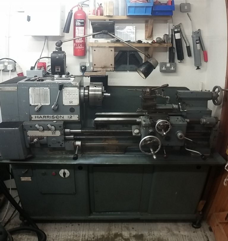

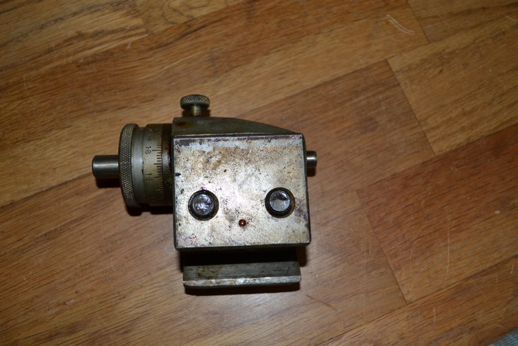

                  Just to add a bit more info about saddle stops,
                  This is a photo of my L6 with the standard saddle stop fitted to the bed just to the right of the saddle.
                  And this photo shows the micrometer saddle stop fitted to the bed also to the right of the saddle.
                  Both of the stops can be fitted either on the left or the right of the saddle. They butt up against the stops that are fitted to either side of the saddle.
                  Hope this helps
                  Graham

                    ive got something else that came with it il take a photo of it tomoz.a 2"dia cylindical thing with a hole right through it roughly 4" long, and what looks like a slot milled down the side of it.it also has a smaller hole off centre from the main bore, which is countersunk.
                    looking at your second picture:10" below the '12' on 'harrison 12' on the bottom longitudinal shaft there is a handle with a black ball on it. i havent got this. i have got the metal cylindrical thing that the handle screw into, but with no handle, and no female thread to screw it into.
                    thanks
                    james
