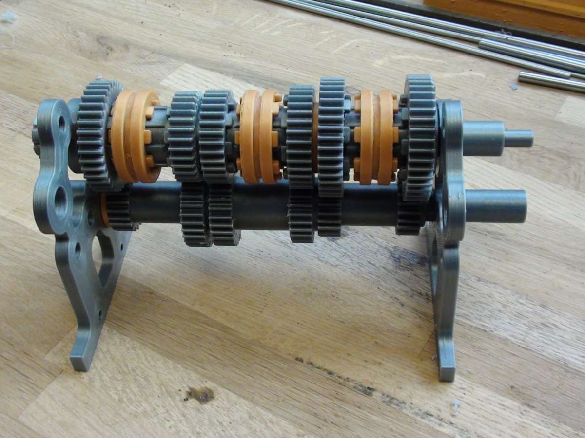

              The rain has stopped, so here are some photos.  All the parts shown are printed with a 0.12mm layer thickness, 25% infill, support enabled where necessary and using a 0.4mm nozzle.  The filament is BambuLab supplied PLA in silver or orange (to simulate bronze).  Print quality is what I consider to be quite good, although I have purchased a 0.2mm diameter nozzle and hot end, in case I need greater detail,
              The input and output gear clusters mounted on temporary plates awaiting the addition of the test fit of the rest of the gearbox internals :
              Gear clusters

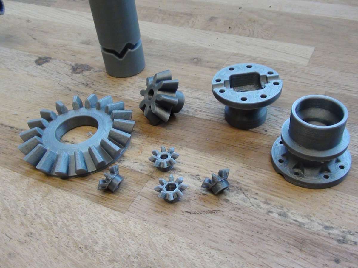

              Then a general shot of the parts that will make up the differential :
              Differentialparts

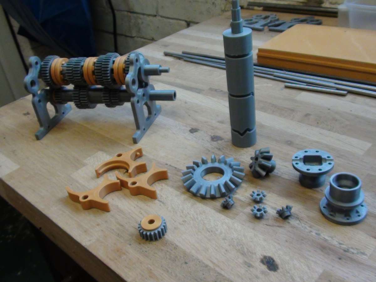

              And finally an overall view of the sum total of the parts printed so far :
              Overall view
              More details are in the descriptions in my gallery but briefly, thought has to be given at the design stage as to the need or otherwise for support and the orientation of the part when printing, adjustable in the slicer program, to minimise overhang and excessive use of material. For example, the selector barrel (the grooved tall object at the top towards the right), has a pivot 10mm diameter protruding from the lower end in the design.  If printed with this in situ, it would require a large amount of support around it to provide a base for the larger diameter material above.  I therefore decided to print the pivot separately and introduce a hole at that end to accept the pivot after printing.  However, in order to prevent the slicer using support material in the hole, that in itself had to terminate in a 45° cone!  All has to be foreseen as the design progressed, mostly in my head which as a consequence, now hurts!
              I think I’m getting to the stage now where I can’t put off any longer printing the differential and gear section casings, but both will take a lot of filament, so I want to get it right first time, if I can.
