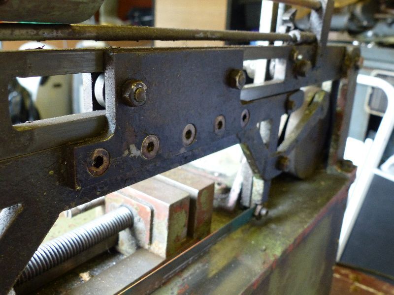

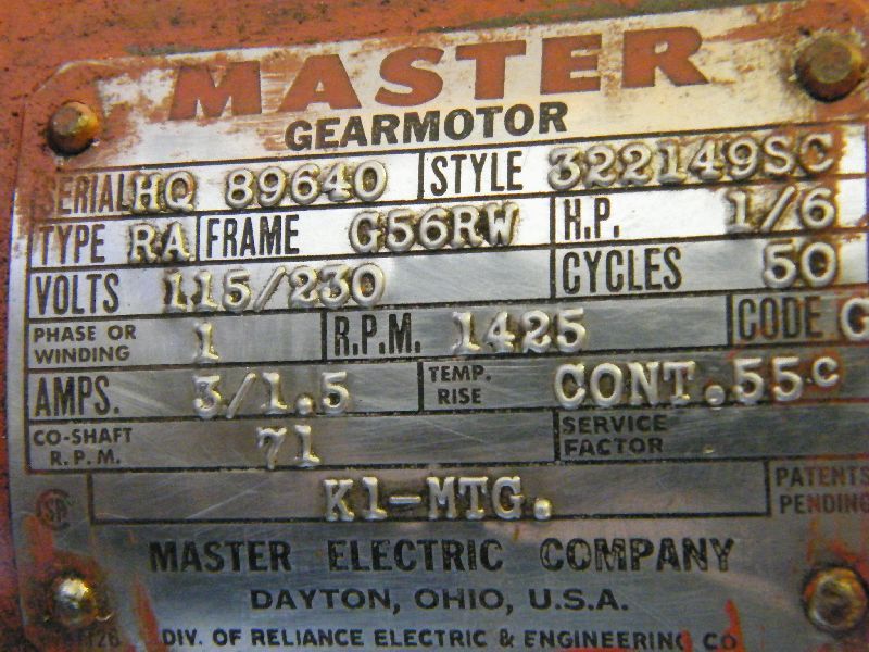

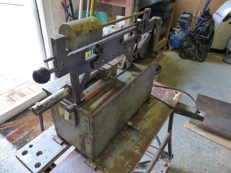

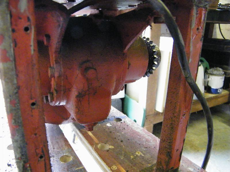

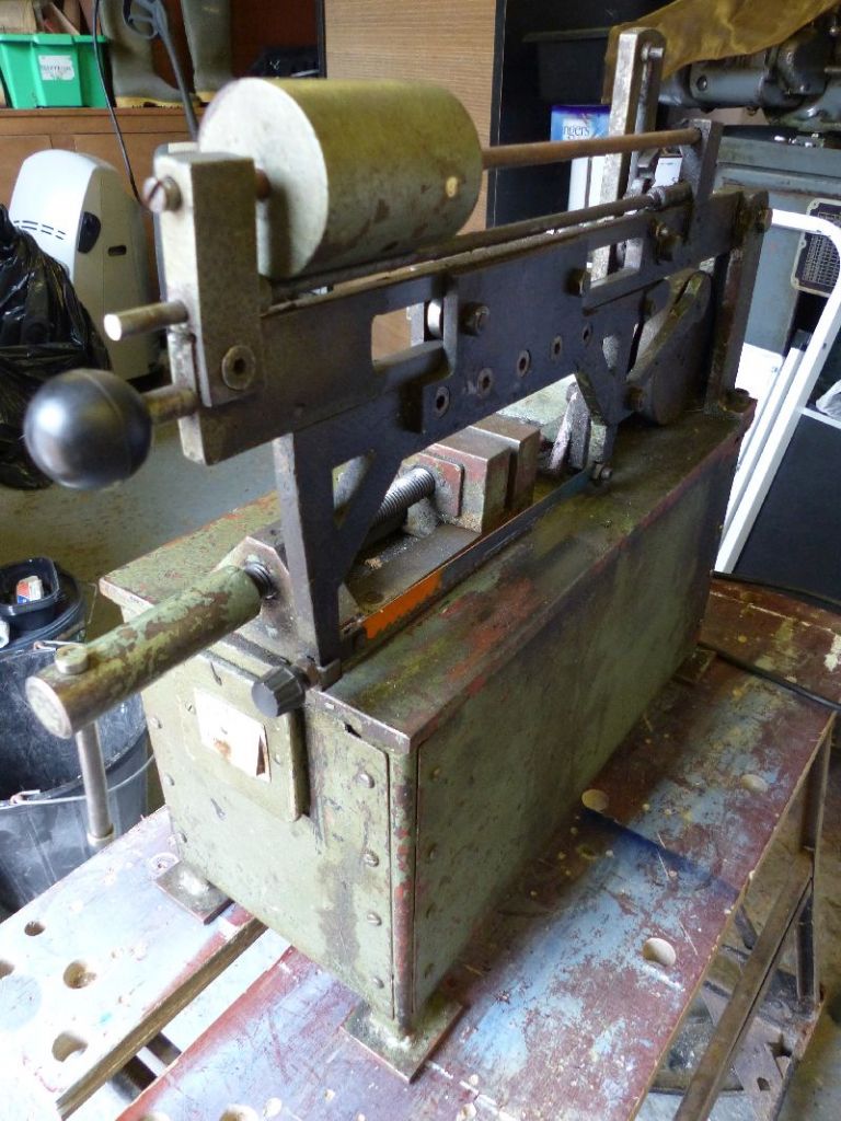

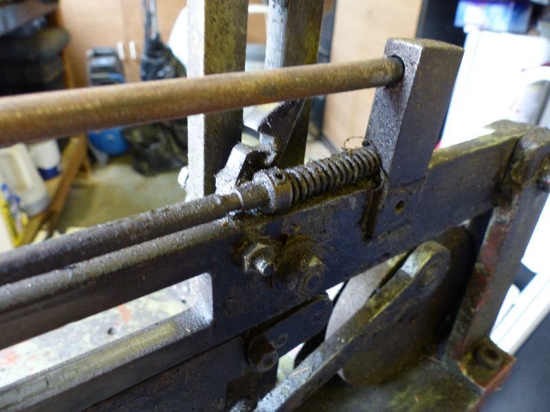

        Hi Everyone!
        Due to an enforced lay-up (main hydraulic pump fault!) I have not been able to make a start on My workshop conversion yet, but I have been able to check over My Myford Super 7 to look at it's general condition and operation (will do a post this week with a question or two….or three…).
        I'm starting to potter around a little as things are slowly returning to normal, and I am concentrating on getting other items in ready for setting up.
        The first thing I was looking for was a way of cutting stock up for machining, My sawing arm is not what it was, most power hacksaws are too big for the space I have available, so was thinking off a cut-off machine (Rage etc.) then this appeared on Fleabay this week:-
        (hope the picture links work,first time I've posted any on Forums!) Photos added to album.
        Very compact machine, 2' x 1' x 18", did a test cut when I got it home and works fine,and very well built, and takes standard hacksaw blades.
        Guy I bought it from is selling items from an engineer who has sadly past away,
        and did not know about the history of the machine,he was'nt sure if He had built it Himself, but it looks like a bought item.
        Can anyone shed any light on it re manufacturer etc.?
        I will be cleaning it up and freshening the paint up (and, yes, changing the switchgear!!)
        Any thoughts/advice greatly welcomed!
        Cheers, Pete

              #420389
              John Reese
                @johnreese12848
                Definitely a power hack saw, probably shop built. With that enormous adjustable weight I bet it could really eat up blades.
                #420403
                Morty
                  @morty
                  Hi John!
                  First thing I thought when I 'saw' the weight! (Sorry, couldn't resist……)
                  I did a test cut one some 1" bar, it didn't protest at all, but took a few minutes, stroke rate is roughly 60 per minute.

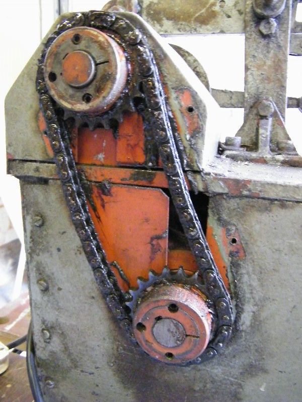

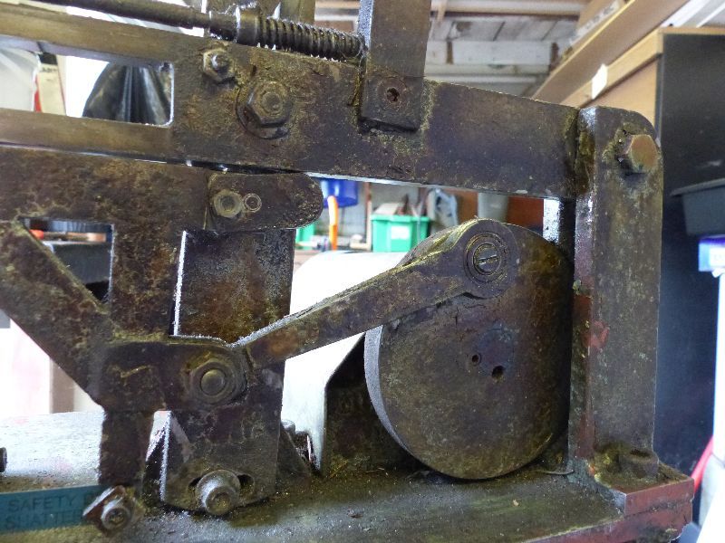

                  Started to strip it today, the engineering is exceptional if home built, will post some pics tomorrow,
                  Cheers, Pete

                    Yep, looks like a crusty home build, but I bet it works well if you clean it up.
                    Echoing what John says, I would start with the weight at the pivot end.
                    #420414
                    Roderick Jenkins
                      @roderickjenkins93242

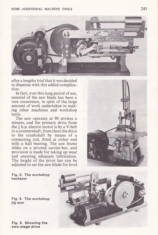

                      It looks similar to the "Duplex" design in Ian Bradley's "The Amateurs Workshop"
                      Rod
                      #420736
                      Morty
                        @morty
                        Hi Neil, thanks for the advice, I will start with the weight further back then experiment with the setting until it is happy!
                        Hi Rod,yes, the saw frame does look pretty similar to the Duplex with an own designed base and drive system, the further I dig, the more it looks like a shop built machine, very well put together as the photos above show.
                        (I tried the put the text above the pics, but need to have a play around to get it right!)
                        Clean up and paint next, thanks for posting these very useful replies, more soon!
                        Cheers, Pete
                        #420832
                        JC54
                          @jc54
                          Many thanks Rod for the picture of the Duplex Saw. I now know what I have got (ebay buy). I have altered my drive to put the motor underneath the main frame so that when cutting it does not stick out the front of bench.
                          Morty (Pete) you may find that you need the big weight , I have increased mine and it cuts a lot better than it did.

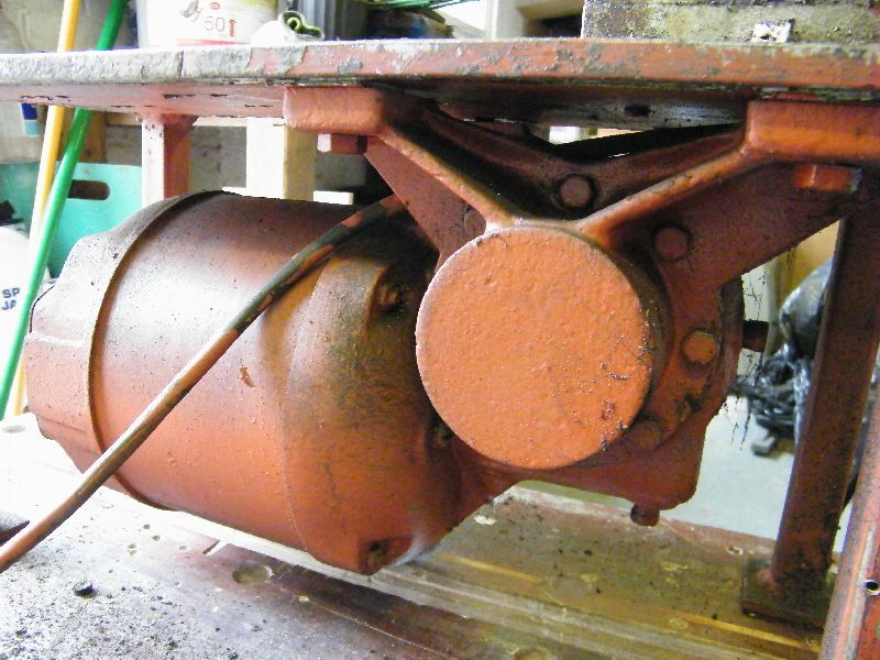

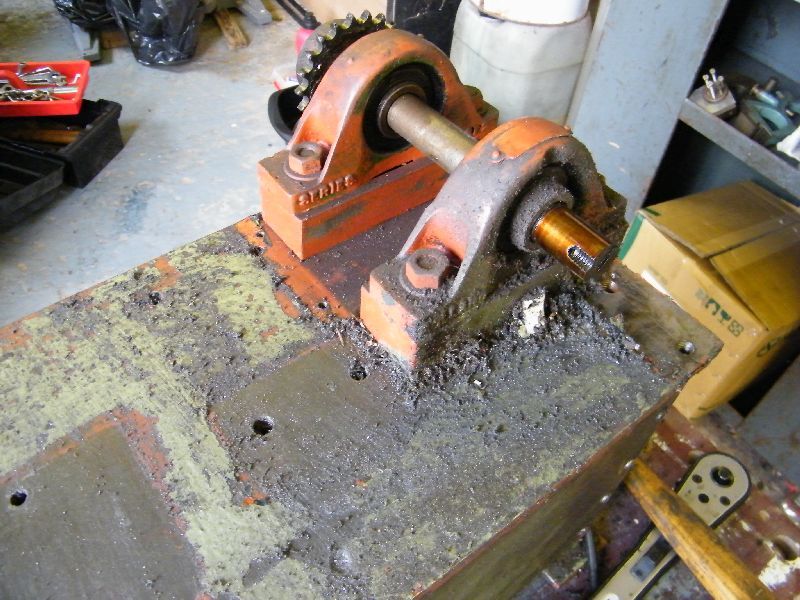

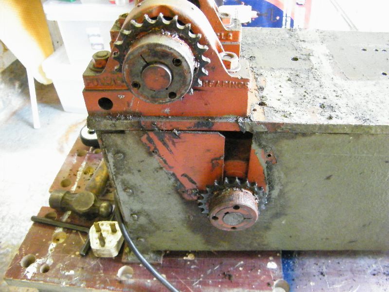

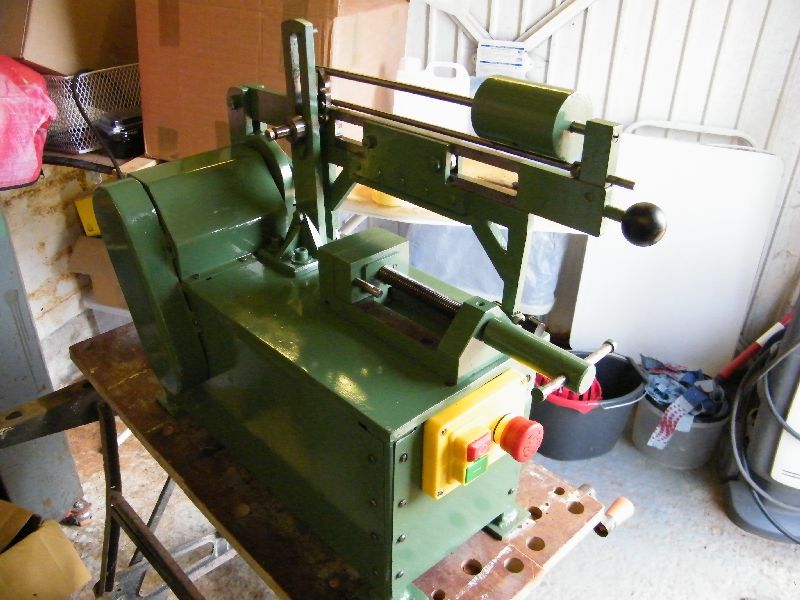

                            #462028
                            Morty
                              @morty

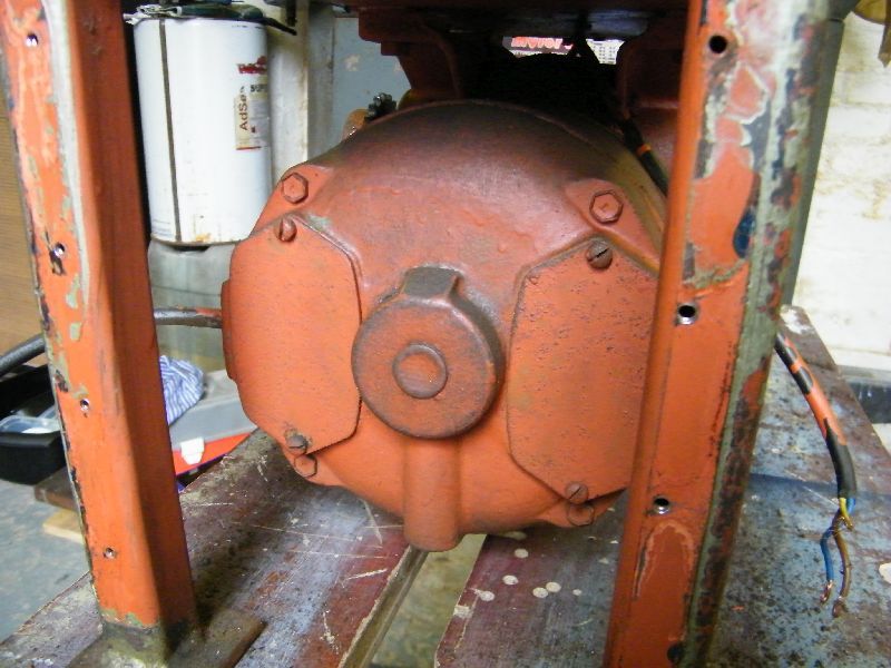

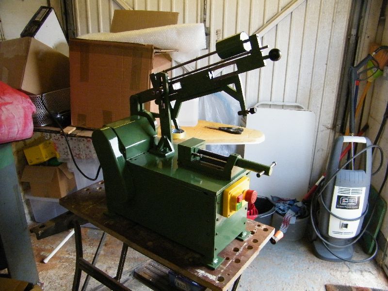

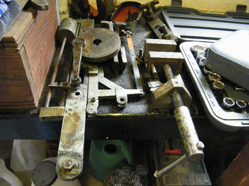

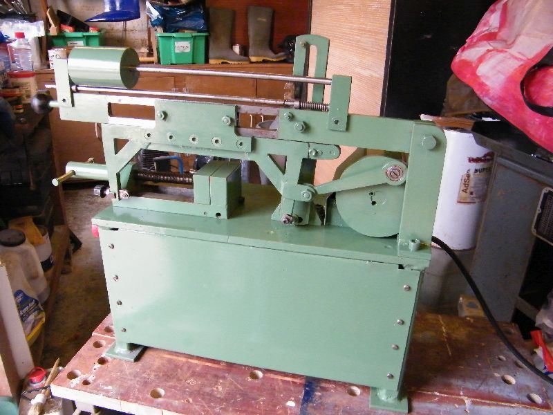

                              dscf1060.jpgdscf1059.jpgdscf1058.jpgHi Everyone!
                              Sorry that it has been a while since I posted on this thread, I did not start back at work full time until January, after recovering from an heart attack last summer,so I have been getting back in the swing of things!!
                              Having found Myself, like many more, with more time on My hands recentley, I thought it was about time to get on things, so I have finished tidying up My power hacksaw which I bought last year………
                              Sorry that the text is in the middle of the photos, i have not sussed out how to layout the posts yet!!dont know
                              I just need to make an extension for the rear blade peg, I thought that it fit 10" blades,(which I have bought a good stock of…) but on trying to fit a blade, found out it was requires 9" blades??……..
                              The original builder must have shortened and re-drilled his blades to fit…….
                              Not a problem, saw is stored away for the workshop is finished.
                              Now, what to do when You are on lockdown?
                              Ah! I've got a Super 7 lathe that needs a good looking at! (as glimpsed in some of this photos)
                              Please take care Everyone, keep Yourselves and Your Families safe.
                              Thanks for looking in, Pete

                                  Howard Lewis
                                    @howardlewis46836
                                    Looks a nice job now! Well Done!
                                    Any chance of extending (making a new one ) the front frame, so that 12 " blades could be used? 10" seem to be hard to find now.
                                    Howard

                                    Bazyle
                                      @bazyle
                                      Certainly looks nice now Marty. Now I want one.
                                      Before making the rear blade extension look at the movement possible for the vice and which part of the blade is being used. It might be better to extend the front. It only uses part of the blade on smaller items so may put all the wear down the back end and you might want to look at options for reversing the vice and then need more out the front to maximise the space for the vice handle.
                                      #462116
                                      Morty
                                        @morty
                                        Hi there and thanks for looking in!
                                        Ega, thanks for the posting tip, I'll give it a try!
                                        Howard, extending forward would be quite a job due to the tensioning fork, it would mean cutting and modifying the frame, the rear extension would just be a short extension bolted on the existing position. I managed to get a good stock of 10" towards ( 50+) at a good price!!
                                        Bazyle, the base is drilled to move the vice but only towards the crank end, the only way to move it away is to re-drill the vice base and the handle end of the vice would loose some support,if I drill the table to move it I will be into the switch enclosure box.
                                        I will take the suggestions on board and look into them more!
                                        Many thanks! Pete

                                              #462389
                                              oldvelo
                                                @oldvelo
                                                Hi Morty
                                                You have made a great job of the restoration on this one now a few things you may want to consider.
                                                Teeth cutting on the pull stroke with the crank turning anticlockwise.
                                                With power hacksaw blade fitted cutting thicker material use the weight as far from the crank as possible maybe even a little more weight on the blade lifting handle and reduce the load for thin material.
                                                A drip feed of cutting oil on the blade will greatly extend the blade life.
                                                Fit a large sheetmetal tray under the vice to catch the swarf and cutting oil.
                                                Best possible place for a lockdown in a workshop Stay Safe
                                                #462397
                                                Morty
                                                  @morty
                                                  Hi Oldvelo!
                                                  You must have read My mind! ( Wouldn't take long!!smiley)
                                                  I was going to ask about blade direction, the large one I used to use at work long ago cut on the backstroke but did not have a weight on it.
                                                  This one does rotate anti clockwise, so that answers My question!
                                                  I like the idea of a drip feed, can with a tap?
                                                  Also the drip-tray could catch any small lengths cut off.
                                                  Yes, I'm planning on staying in the workshop!
                                                  Keep Safe!
                                                  Many thanks! Cheers, Pete
