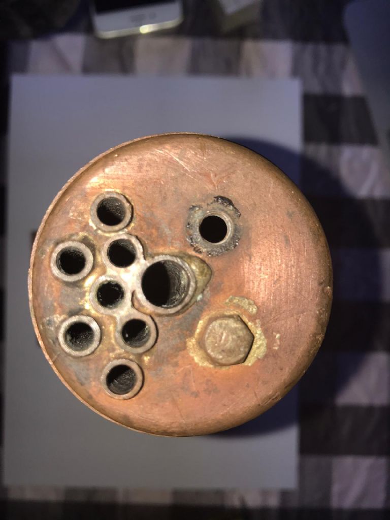

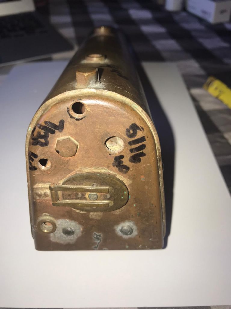

      Greetings fellow subscribers.
      I wonder if there are any readers who could help? Being a proficient maker of swarf from perfectly good metal I like a magpie bought 3 boilers from a chap a while back and they have been collecting dust in the workshop ( next to the faceplate) I have worked out that two are designed around the Gauge1 “Project” boiler but one is slightly longer.
      The third and largest is this.

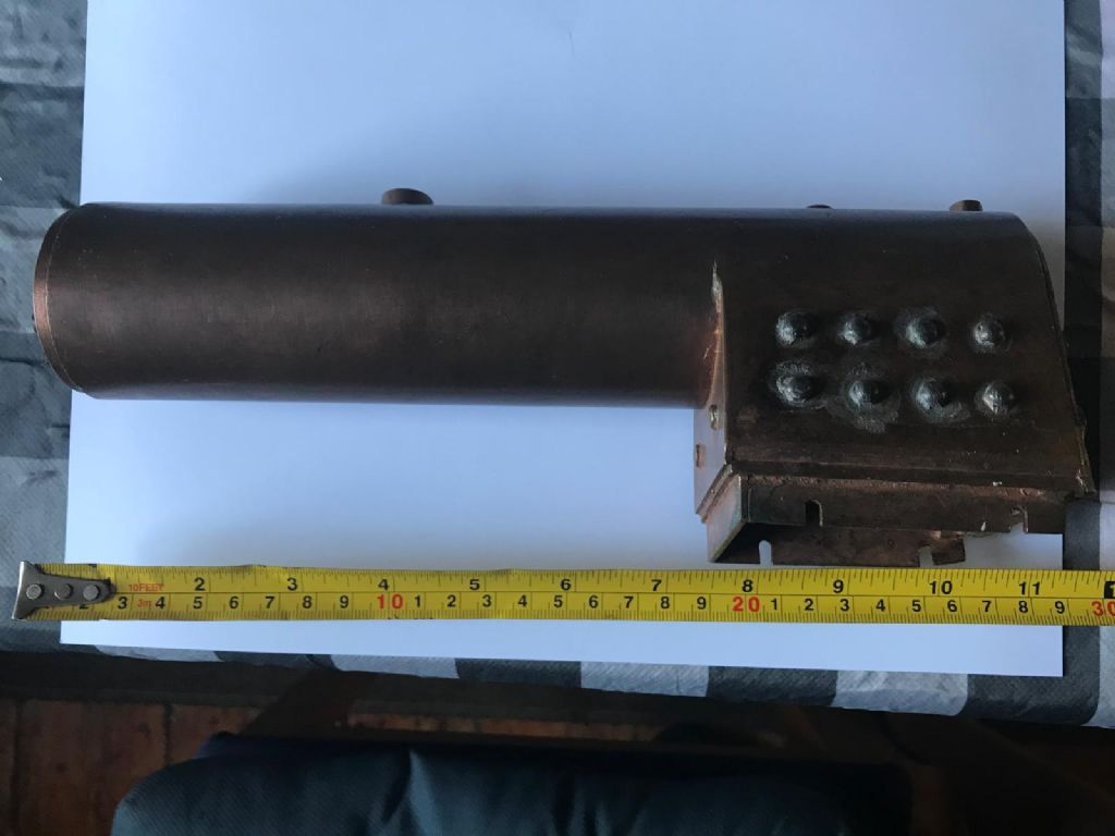

      A few dimensions:
      Barrel length: 17cm X 5.5cm Dia
      Fire box 8cm internal grate 6 X 5.7cm
      7X 3/16th ID tubes 1X 5/16 id (superheater?) tube.
      A wide grate firebox with an upright throat plate.

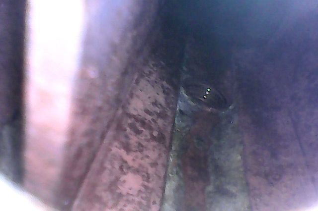

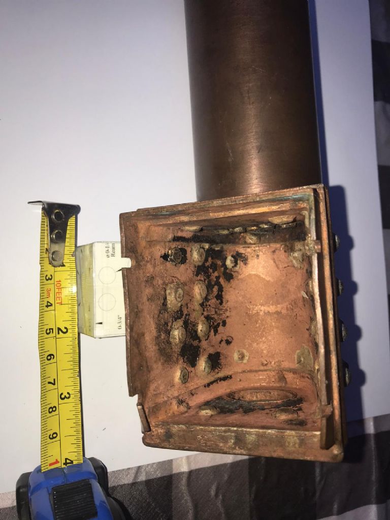

      I have had a look inside as best I can with my usb down the throat camera (dont ask) and the firebox crown stays are of the girder type and are silver soldered to the top of the wrapper.
      What holes there are in bushings or threaded in ME or Bsw thread forms.
      There is room in the back head for a hollow stay and a corresponding hole in the front tube plate, This threaded 5/16 x40 but is partly blocked by the firebox crown plate!
      There is a silver soldered hex plug on top of the barrel over the backhead plate thats drilled with a passage to the barrel.
      The two 7/32×40 holes on the left of the backhead are to my mind for a water gauge but looking at how tall the inner firebox is it would only be the top 1/4” of the glass till the crowmplate becomes exposed.
      There is some charing on the inside of the firebox which might indicate coal firing and the hinged firehouse door would also intimate the same
      I will make up some plugs and get the club boiler inspector to have a go at them before making my mind up what should go round them.
      But any help with the design and more information on what it might be for would be helpful.

            Hmmm. I think a boiler tester might worry about one or two awkward points. Such as –
            Holes not provided with bushes, but tapped straight into the fairly thin copper, and one encroaching on the flange bend – poor practice even in small scales, but I think some of LBSC's designs specified that. BSW is not a good choice of thread for small boiler-fittings – BSP or BSF perhaps, but Whitworth is very coarse for such purposes.
            What is that "bubbly" material around what does seem the hole for the hollow stay in the front tube-plate? Has something been removed? The big blob of solder by the super-heater flue draws attention to the joints themselves, but they may be sound.
            The inner firebox enforcing a high and narrow water-level range, and obstructing what may be the hollow-stay's route, is a bit odd. Where does / do the feed clack(s) fit?
            It looks as if this boiler has been used but later removed from the loco, for some reason unknown but possibly involving modifications to it (the boiler). I cannot identify the locomotive but the boiler shape and dimensions suggest 2.5 " gauge, 4- or 6-, perhaps 8-, coupled wheelbase, possibly LNER?
            I would advise a preliminary dry inspection before going as far as the hydraulic test; but be prepared to be asked for a drawing I assume you don't have.

                          Another thought on the apparent soot. Soot or oxide? I wonder if that is actually from the silver-soldering, not from any firing.

                              Looking at the photos again, it seems actually well made, but not very well designed, as if by someone not versed in the more subtle aspects of loco boilers.
                              One puzzle, as you mention, is how the original builder intended to get the steam to the super-heater, which with only one element of a pair of rather small tubes, would act as a pretty efficient restrictor.
                              Normally there would be 3 or 4 super-heater flues and these are usually above the fire-tubes. Now, there is no intrinsic reason that I know of, why a miniature boiler could not have the super-heater below the other tubes provided there is room behind the chimney and blast-pipe for it, but it's normally at the top to suit the steam-pipe from the regulator in the dome.
                              Some models do use external regulators, either hidden in the smoke-box or rather inelegantly on the back-head, the latter usually on narrow-gauge locos where bolting bits on the outside is a bit more prototypical.
                              Yet your boiler shows no sign of any internal steam-pipe, nor of any external regulator mountings. I can only think its designer had an external pipe in mind, difficult to hide on a standard-gauge outline loco in British railway practice, though I suppose it could be hidden under the cladding.
                              The hole on the lower corner of the back-head: I'd assumed it to be for a blow-down valve, though It could have been intended for a feed clack.

                                  Hi Martin,
                                  Interesting.
                                  In general, the diameter points to a large boilered G1 loco. The parallel sided firebox points away from G1 pacifics with Wootton style like a duchess. The tapped copper platework (without bushes) indicates early designs from LBSC, a practice that is now frowned upon. The width of the firebox would’nt fit between any G1 wheelset at 40mm back to back – ruling out all designs.
                                  However.
                                  Small 3 ½” gauge locos like Titch, Rob Roy, Molly may be a better bet. Or maybe a 2 ½” something – but again watch the frame spacing over the firebox.
                                  Bottom left bushed hole for clack feed .
                                  Watergauge was probably where you suggested, on the left. But using the upper hole for the bottom of glass. The gauge top fittings would be taken from the hex fitting on top.
                                  Top hex plug for a takeoff manifold to feed water gauge top, pressure gauge, blower control. Blower control outlet to pass through hollow stay to smokebox and terminating with a jet up the chimney. Possibly silversoldered in place by accident if it was intended for a manifold.
                                  Top centre would be for the regulator which then should appear top centre on smokebox tubeplate (not yet drilled ?). 5/16 ID tube could be used for a slim spearhead superheater element but is really to small diameter to be of use. A few turns of the steam main coiled in the smokebox will probably suffice.
                                  Best of luck !
