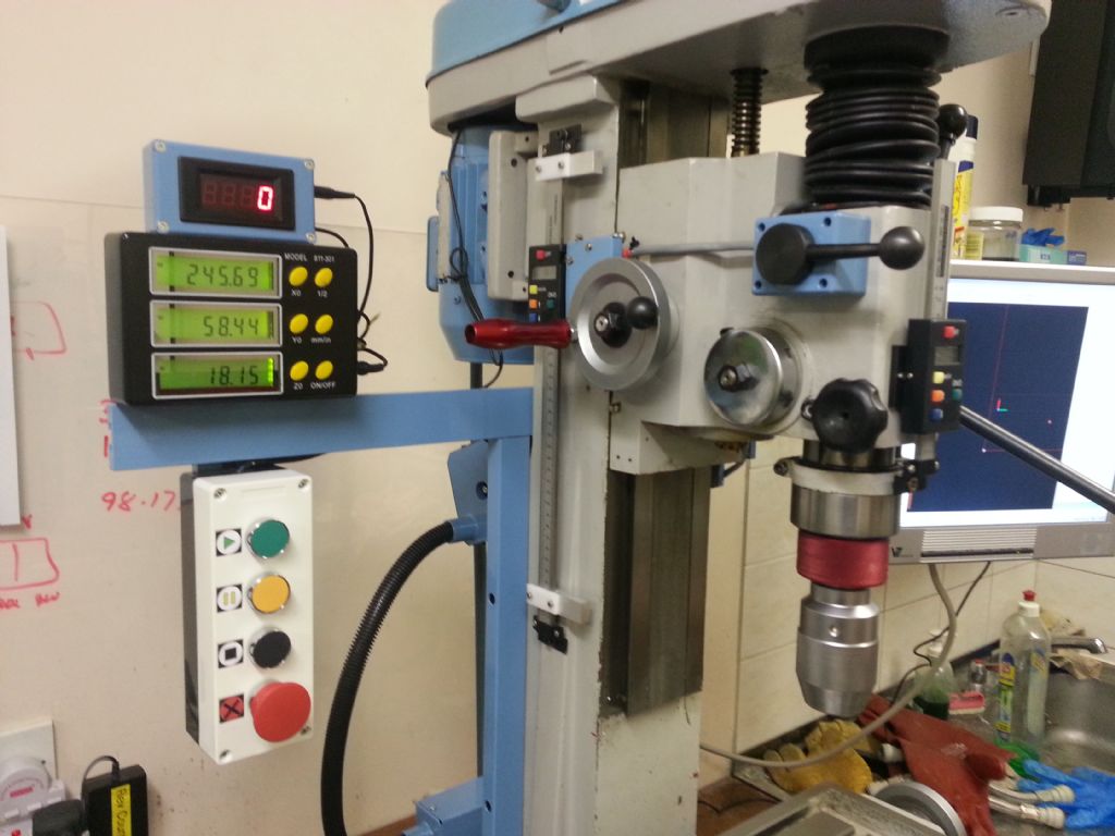

        It has digital readouts for X Y and Z1 and Z2. This was the original task. They are all of the chinese scale variety. The X, Z1 and Z2 being commercial designed for the job scales. The Y axis was a modified LIDL scale which works fine.
        The next task was to monitor spindle speed. The Myford variable speed control was fine but looking up the conversion chart was tedious. A chinese digital frequency readout (£8) was purchased and with little modification could display RPM. A segemented disc on the top main drive pulley provided the pulses.
        The next task was to power the Z axis as the gear ratio o nthe hand whell was very high. I actually used a motor for a bread maker which worked fine but was later replace by a stepper drive for CNC (see later).
        You can see above modifications to the hand wheel (Red) and a counter balance ball (when it spins fast it will shake without it). Nexit is a home made Z axis jog/drive control knob (black on blue box). Make to look like normal machine tool knob. It seem natuaral to reach up to drive the z axis.

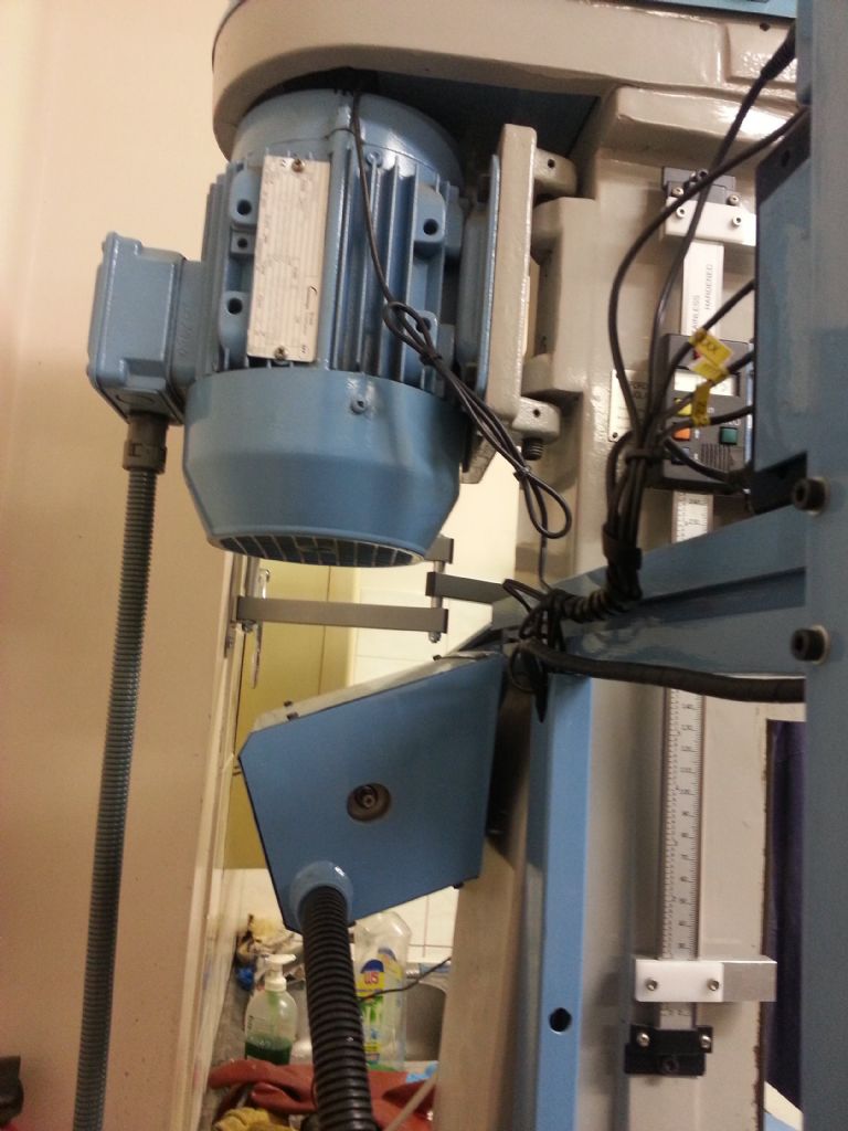

        Of interest may be the red aluminium ring around the drive spindle to aid gripping to tighten chucks etc. Just behind the z axis hand wheel is a blue cover for the Z axis micro switches which use the z axis DRO to hold slidable limits for up and down but rearly used.

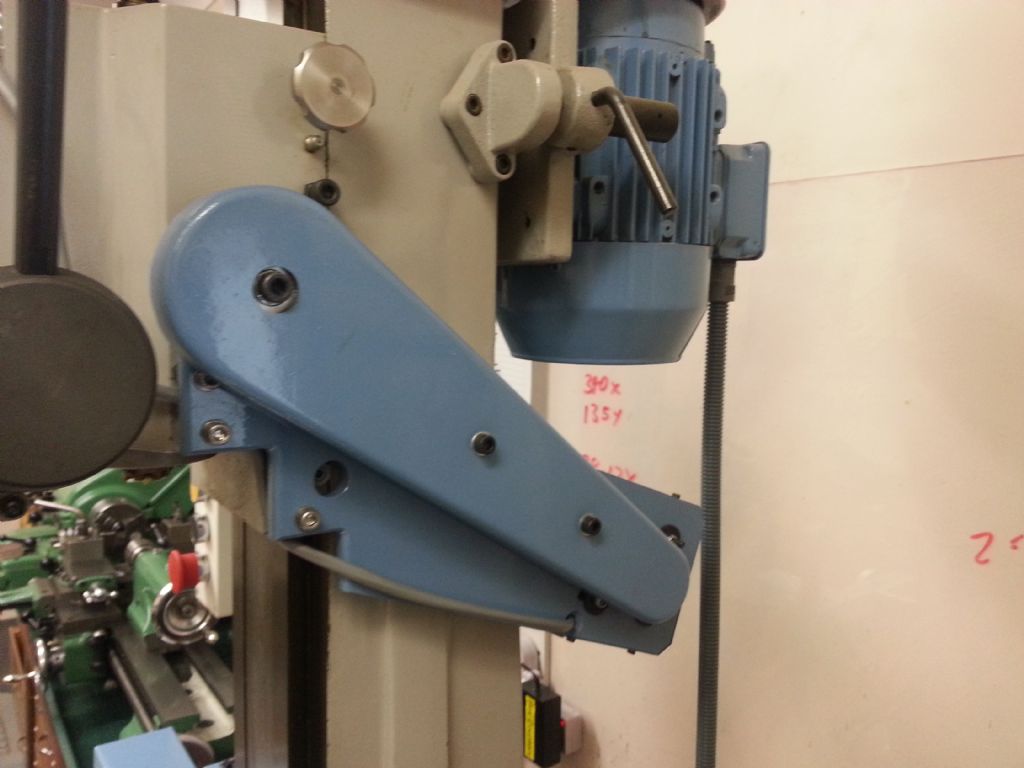

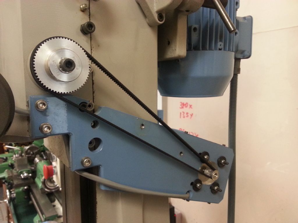

        Above is the Z axis drive mechanism. A pulley is fitted directly on the hand wheel shaft. The motor is mounted at the rear.
        Above is Z drive belt cover fitted (made out of MDF).
        And a rear view of the z axis motor cover with drive cable.

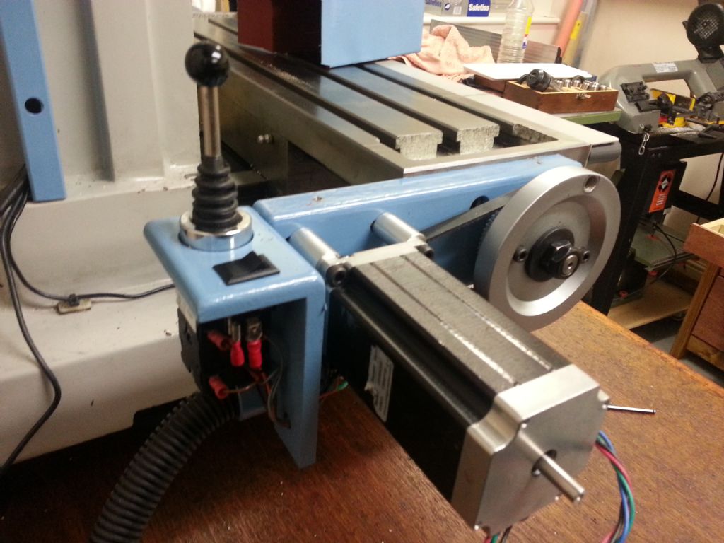

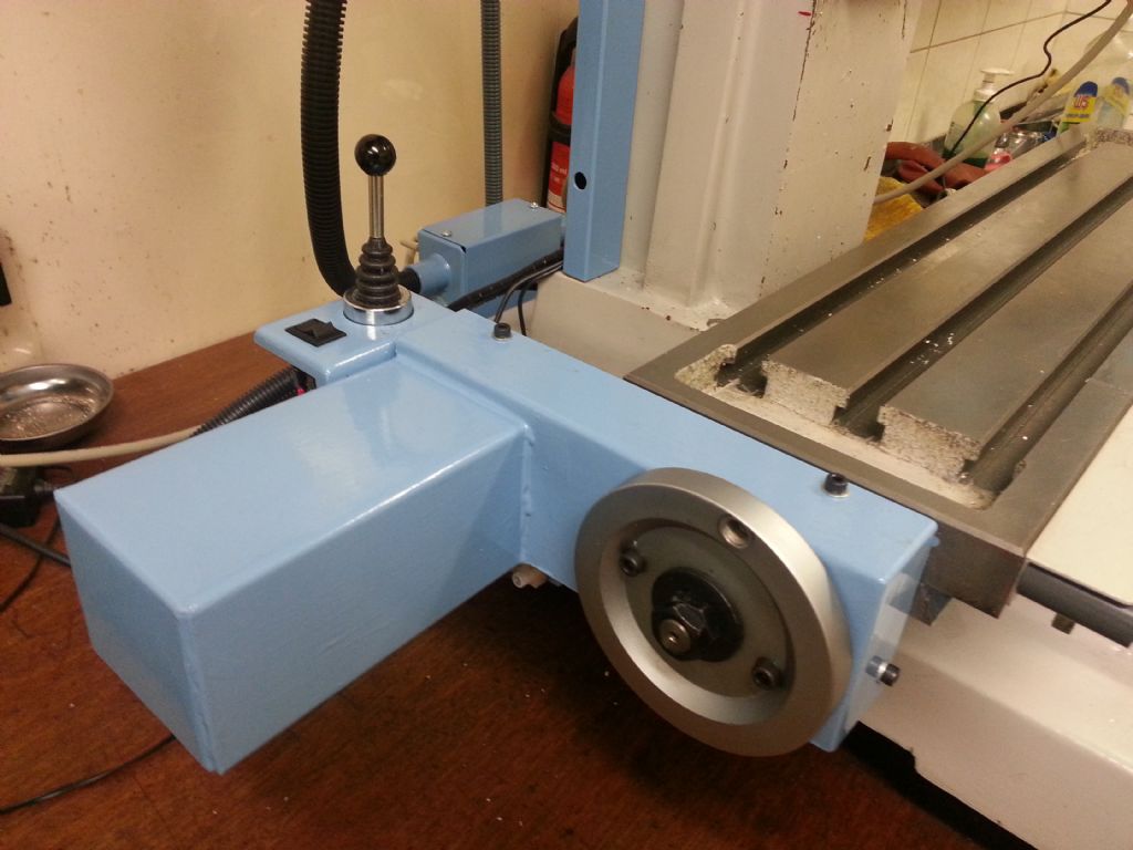

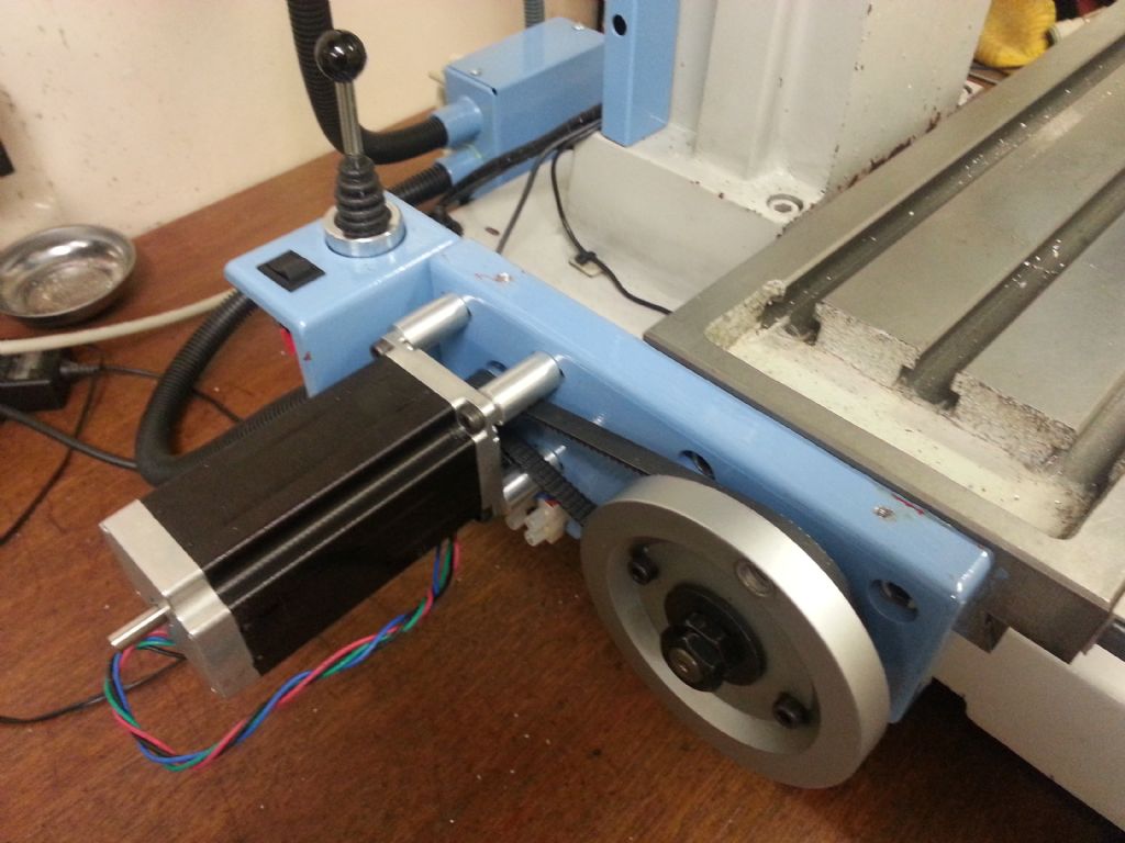

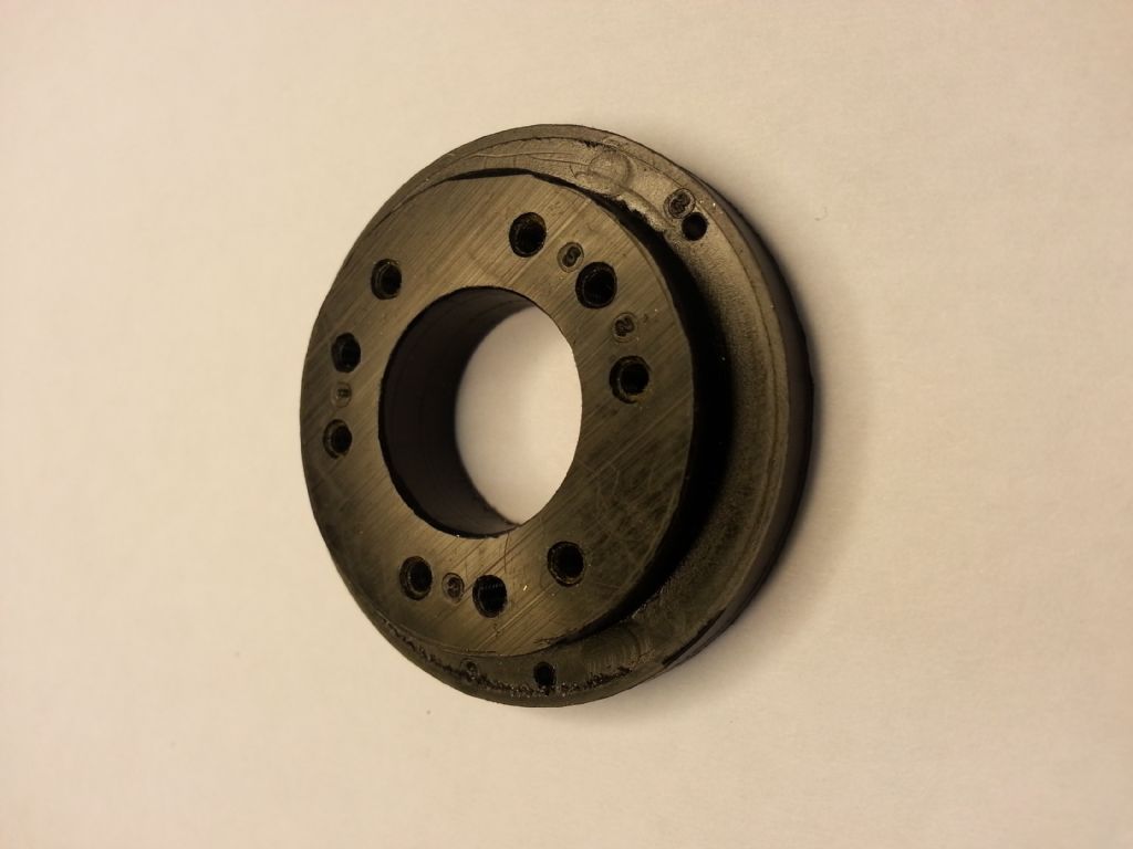

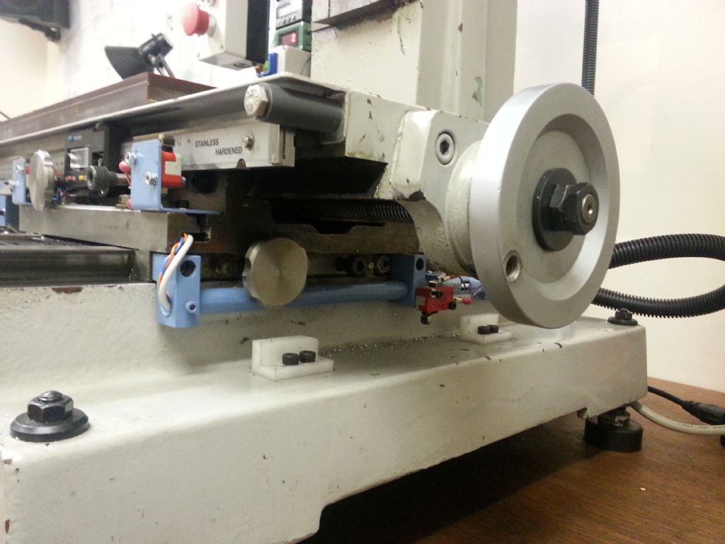

        Above is X axis drive assembly. The original bearing casting is replace with an aluminium plate. A oilite bearing is added. Picture shows stepper and to the rear the X and Y jog joystick. Drive to the hand wheel is through the two screews which engage into a drive pulley. The hand wheel knob is removed for safety.

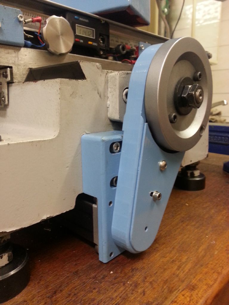

        The Y axis drive is achieved with a stepper mounted under the bed (just enough clearance with the raising feet. Again a cover to keep the muck out which was CNC'ed on the machine itself.

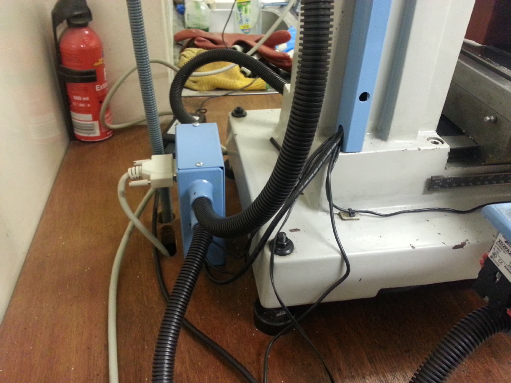

        Rear view of the machine showing jucntion box for all X Y and Z cables20150117_184654.jpg
        X axis limit switches, X axis scale signals, Y axis limit switch cable routing.

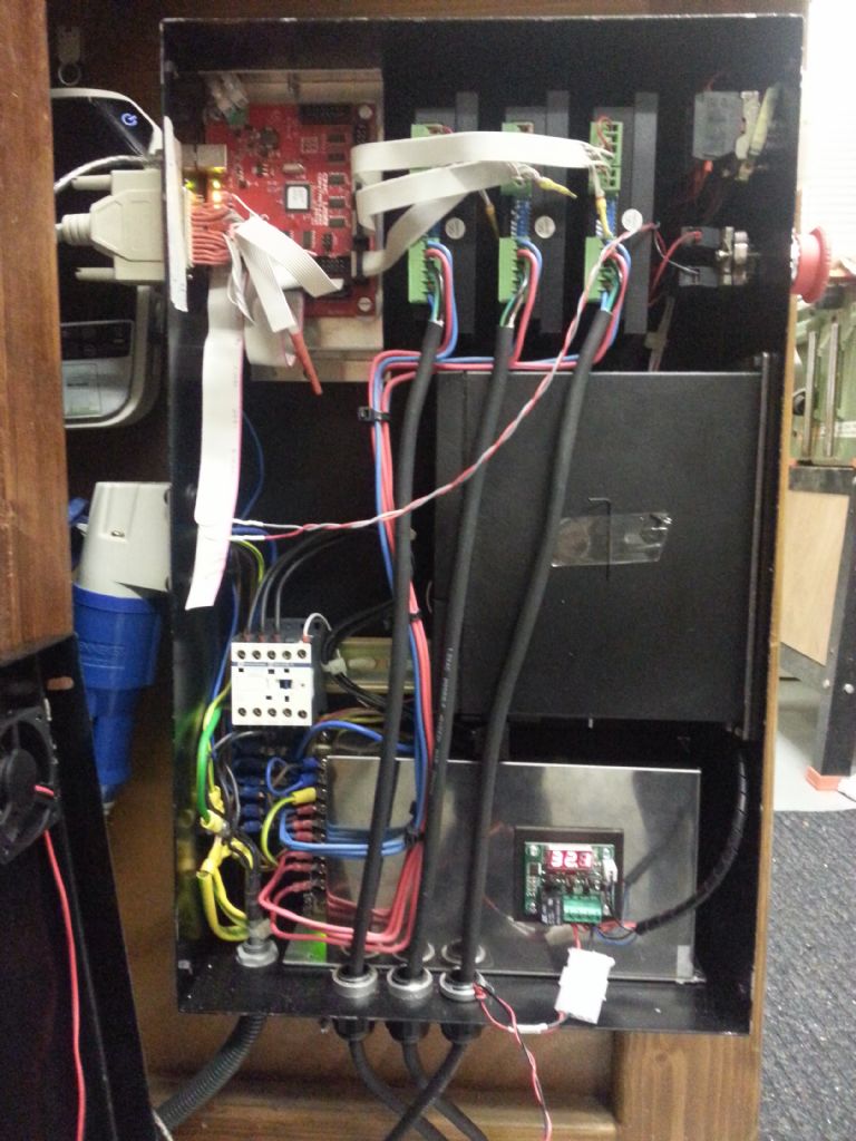

        The CNC controller board from planet CNC top left. Three stepper motor driver units top right. Bottom is stepper power supply with temperature sensing board added to control fan in supply an two mounted on cabinet door.

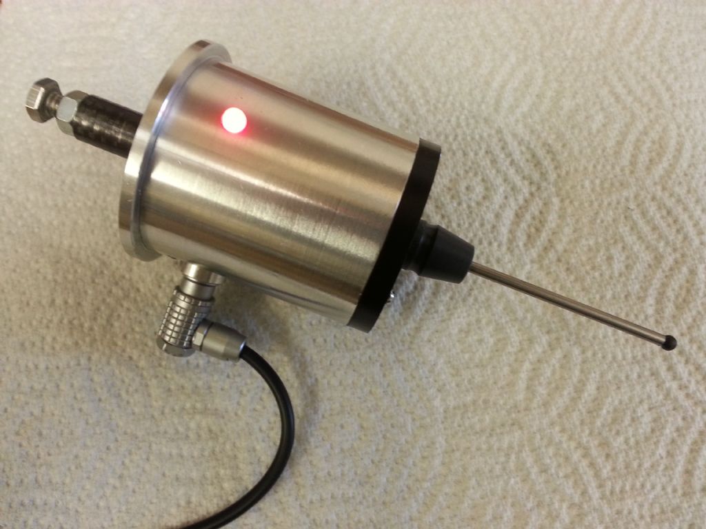

                Yes it has been cutting metal. After parts for itself then first project was a probe.
