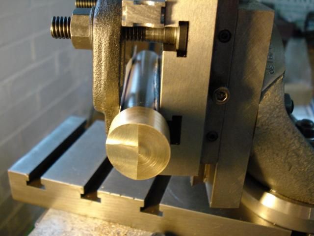

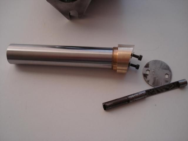

                              Can't voice an opinion on quality of Aftermarket versions. I can only endorse the quality in my genuine Vert Swivel/Slide. Purchased new 33 years ago, along with the Vice and are treated with great care.
                              Serves me well and very adaptable to deal with angular jobs in the absence of an alternative Mill like this Carb Throttle Plate Jig mandrel-.
                              I agree that if you have time and no alternative Mill for machining various jobs, then look for a good used Swivelling Myford Vert Slide.
                              If you don't have time, then I suppose you may have to 'bite the bullet' and go for an alternative which may well be just as good.
