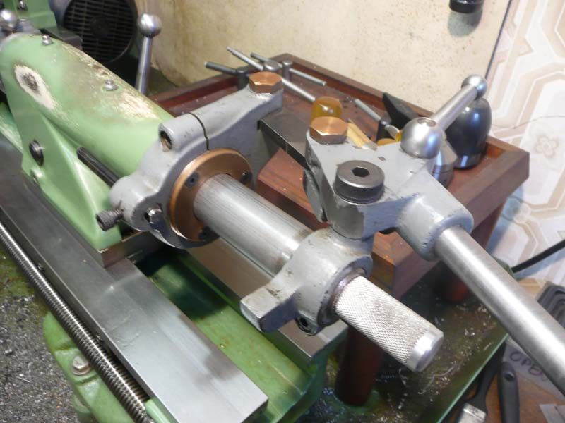

                            So as to the state of my existing ML7 tailstock – I've taken some measurements tonight.
                            It is less than 1 thou higher than the headstock (0.02mm) and the bar lifts by 0.025mm when the clamp is applied, so I don't think I have too much to worry about there (or do I ? – I don't have anything to compare it to)
                            However the handwheel is pretty loose and wobbly, and there is 1/2 a turn of slack in it over most of the travel range. I'm guessing that this is quite a bit more than it should be ?
                            The only things I have done to the tailstock since I bought the lathe is to fit a new oil nipple, slap on some grey paint and oil it up.
                            My current ML7 tailstock
                            Regarding drawbars – none of my taper tools or attachments have an attachment for one – I assume this would normally be a threaded hole in the end of the taper ?
                            Opinions gratefully received….

                              What you have there Dave is a very early Super 7 and a late ML7 tailstock. It's possible that it is the original tailstock even though officially it isn't.

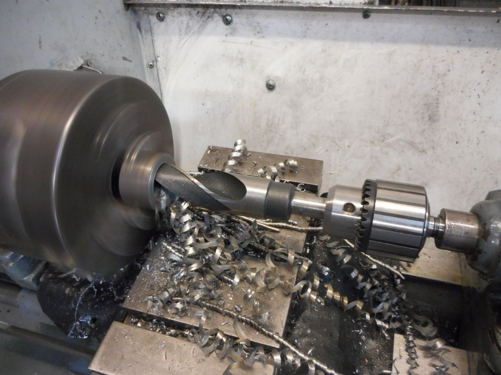

                                      Would you really need to screwcut the internal surface of the lever attachmment? I'm sure I've seen designs over the years that just clamp onto the quill. A nice piece of aluminium would have enough "give" in it to clamp nicely on to the threads without causing damage.
                                      Otherwise, yes its a standard Acme thread AFAIK that could be turned into a piece of aluminium eaasily enough with a home-ground tool bit in a boring bar. But probably not the best project for a first time at screwcutting. I'd seriously be looking at clamping options.
                                      As for drawbar on tailstock, I have never used one in 50 odd years of messing with lathes at home and at work. I wouldn't worry about it. If the internal taper is in good shape it should hold whatever you need to do without problems with no draw bar.
                                      Just one example, I have used the tiny MT1 taper on my ancient Drummond Flagellator to hold a drill chuck that in turn held a 1" diameter drill bit with reduced shank to fit the chuck. Drilled a 1" hole in steel with no slipping of the taper. So when I use the ML7 with the big MT2 taper, I'm pretty confident it's never going to let go. Ever.
                                      Pic: MT1 tailstock taper on "The Flagellator" Drummond M-type holding a 1" diameter drill bit drilling steel. No draw bar. What more do you want?
                                      picture 7. chuck arbour.   taper does not budge under load when drilling a one-inch hole with heavy feed..jpg
                                      The secret is to make sure that both tapers are scrupulously clean and free of burrs. A rag pushed up through the tailstock with a screwdriver will clean it out usually. Then slide the chuck or whatever into the tailstock with a good "bang" so the impact seats the taper. I think I might have cheated on the 1" drill and tapped the tip of it once or twice with a piece of brass bar to make sure the taper was seated good and solid.

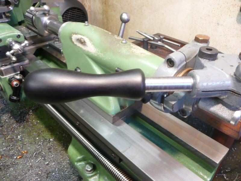

                                                    I have a S7 lever feed tailstock attachment suitable for the early tailstock illustrated in grey. it is used but very tidy and surplus to requirements. Send me a PM if interested.

                                                      If it's for a ML7 and the right price then I might be interested. It's to fit this –
                                                      I put a photo in the PM but it got squished.
